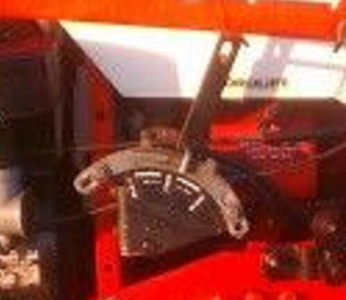

@WHX?? & @Pullstart Having a float position both ways makes sense with the way some Simplicity's work. On the Landlord you pull back on the valve to raise the front implement and push forward to lower. ( Like normal, right? ) With a rear mounted implement you push forward on the lever to raise and pull back to lower. Rear implements lift from the top of the rock shaft, front implements lift from the bottom of the rock shaft.
Kind of hard to make out in the pic but there is a float position both ways.
Edited by Achto
