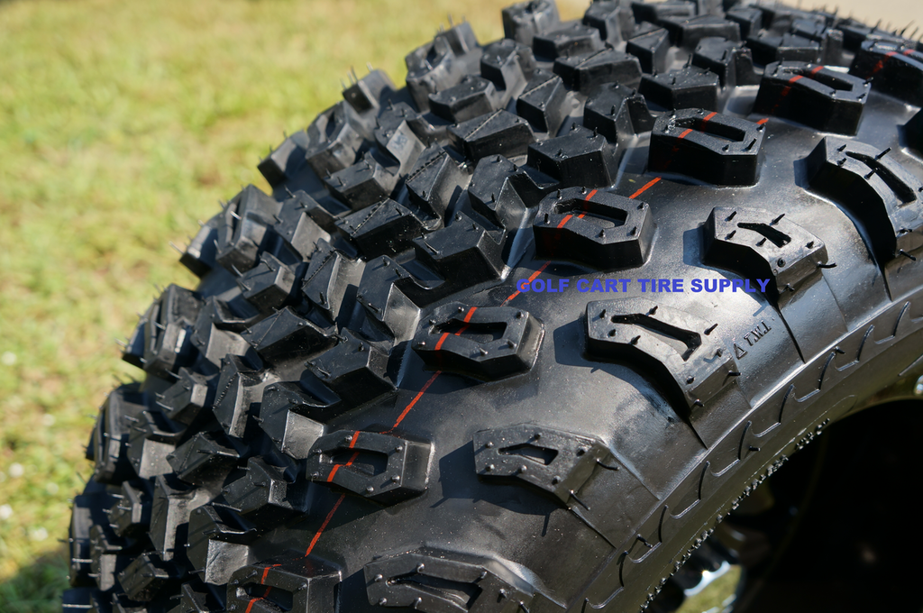

Recently I upgraded the rear wheels and tires on my ‘88 520H. I replaced the std. wheels with 8.5 wide rims and the tires with Wanda 23x10.5-12 All-Terrain Golf Cart Tires.  The first time I used the tractor, the hub caps fell off.  I wouldn’t think that there would be a different hub cap for the wider rims, but the original hub caps just don’t fit as snug as they do on the original rims.

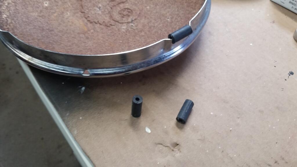

Cut some small pieces of hose, slit them length wise and slip them over the clips that hold the caps on. This will help take up some extra space. You could also use car door edge molding, over the clips.

Experiment with different diameter hoses.
