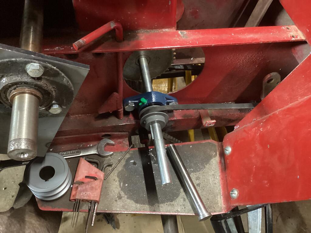

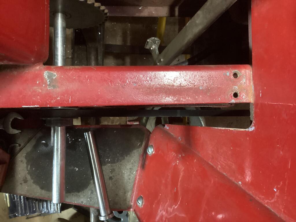

Secondary jackshaft location found…. The 36T go kart sprocket to be used as a brake seems to fit as well!
Obviously, I plan to suck this all in as close to the frame center as possible.
As for brakes, I don’t have a pedal or lever choice made yet.  Having all hand controls seems reasonable, with the handlebars and all.
Having a foot pedal, I thought of making an auto brake system.  Push down to release the brakes.  Fall off?  It applies the brakes.  Dumb idea?
Thoughts quickly talked me off this ledge as well.  I love having another me to talk to in the shop!  It’s interesting when we argue, epic when we fight!

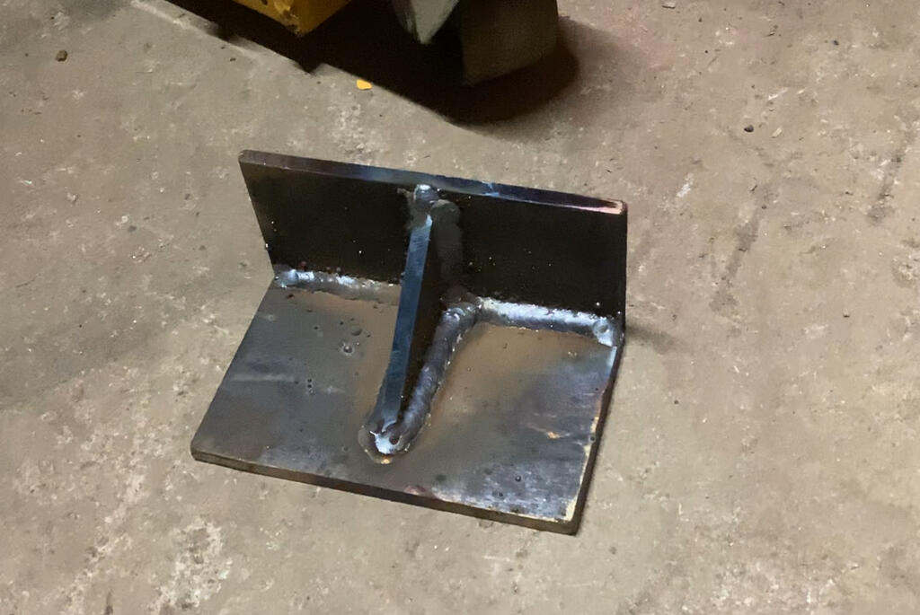

Having the rotor close to a bearing, and having the caliper close to the frame, outweighed having it all centered on the shaft.  Not sure what I was thinking when my two left thumbs were typing.

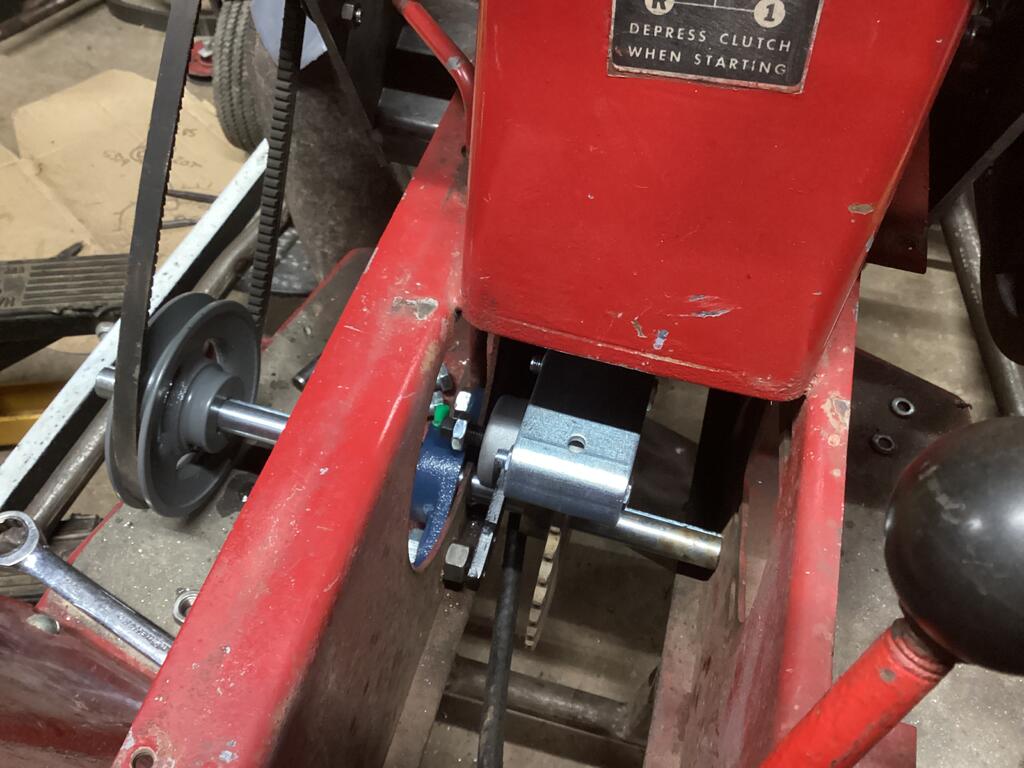

I tacked this bracket together.. I think it’ll do just dandy for the brake caliper.

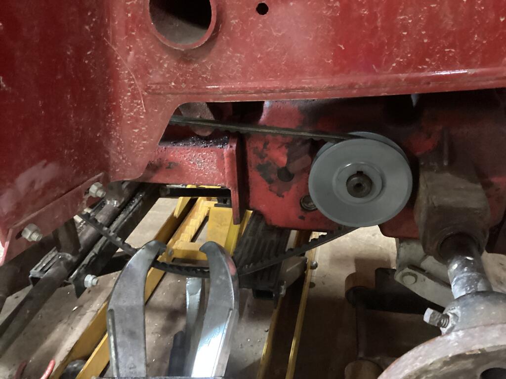

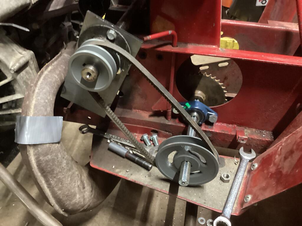

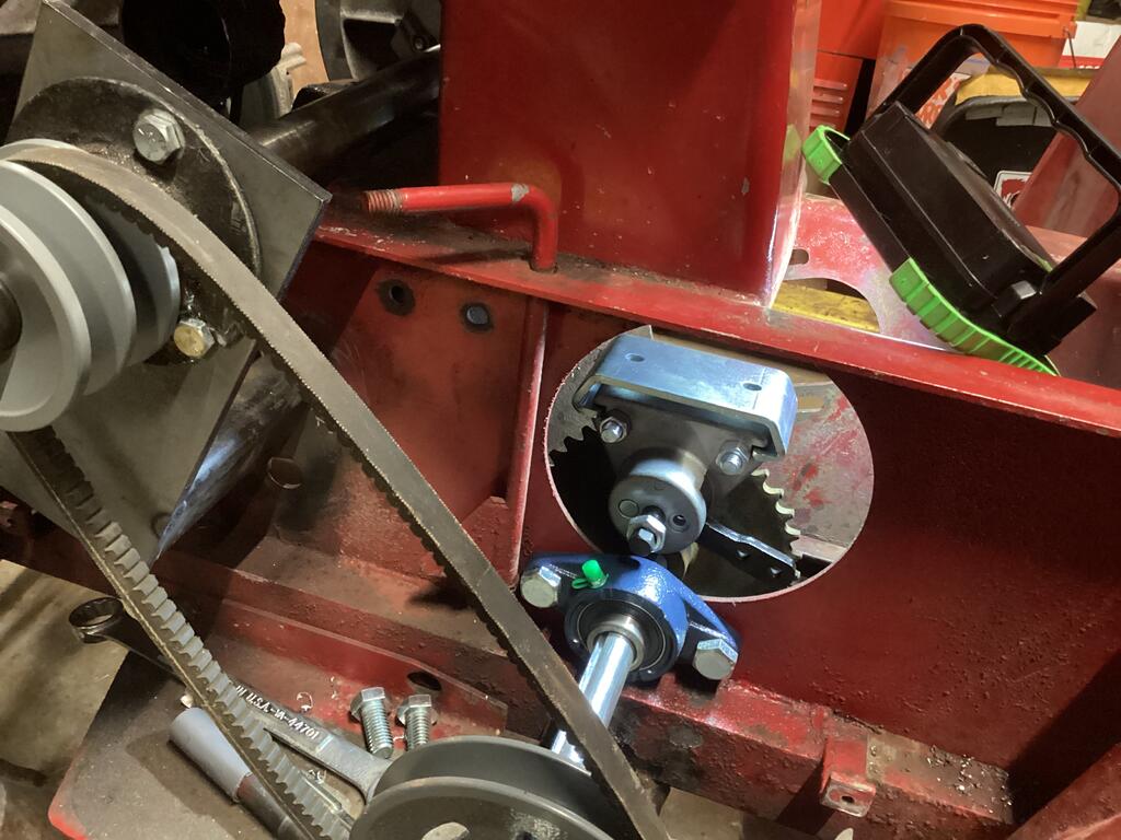

Trans drive belt?  It fits!
I will need to fine tune the trans pulley for a true belt and also find a good fitting belt, but there is room at least!
The parts store lent me a 1/2x44 belt to play with.  Looks like 44.5 or 45 might be the ticket.  No room for a tensioner on the rear.
There is also room for the secondary shaft pulley to run on the inside of the pillow block.  :banana-wrench:

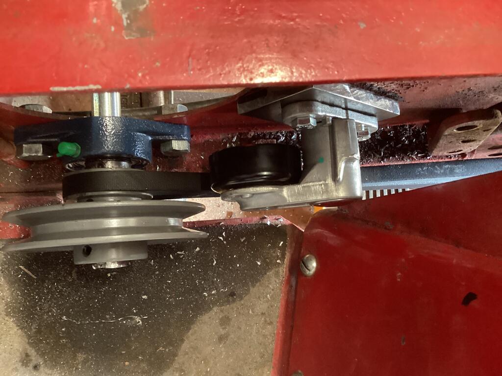

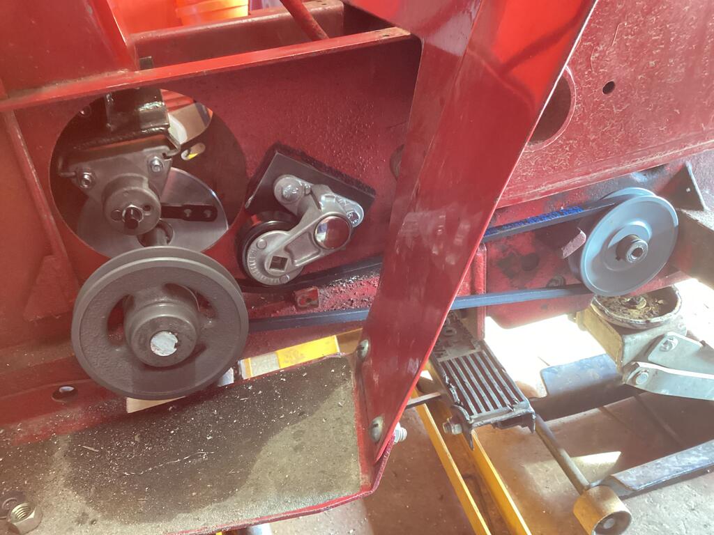

Adding a flat idler on the non drive side of the belt loops and positioned close to those smaller diameter pulleys will give more belt contact in the smaller pulley grooves. That's where it will slip and especially so when it gets wet. The Cogged belts certainly help with that too. Maybe use a slot for mounting them instead of a hole. That will provide for some tension adjustment of the belts too. It's a PITA getting belts and pulleys on and off with fixed tight belt tension. I have a feeling you're going to be WFO on the throttle a lot!
I’ll have 5.3L Chevy auto tensioners later today.  They will be on the return side of the small pulleys :handgestures-thumbupright:

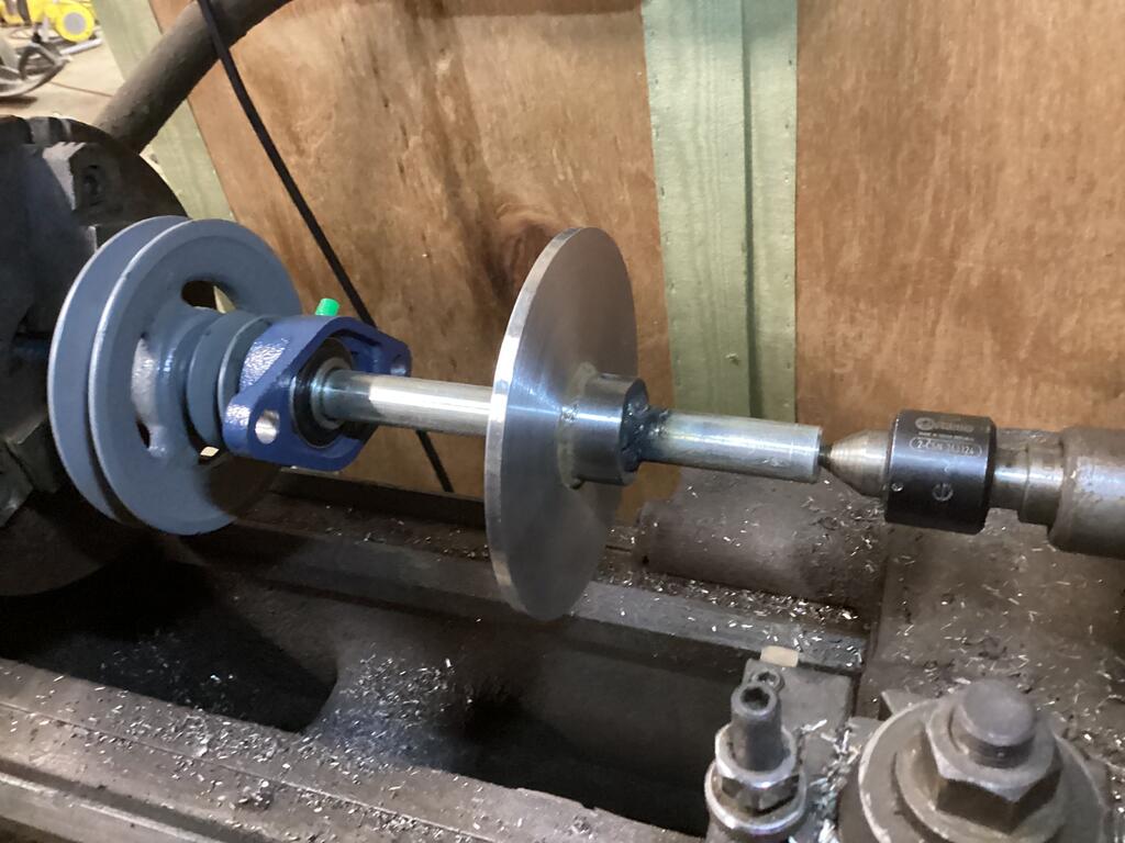

I ended up with a cogged automotive V belt on the way to the parts store this afternoon.  I’m working on the brake disc now.
As cool as the teeth on it were, safety and balancing told me take ‘em off and true up the disc.
Brakes? Mostly done!

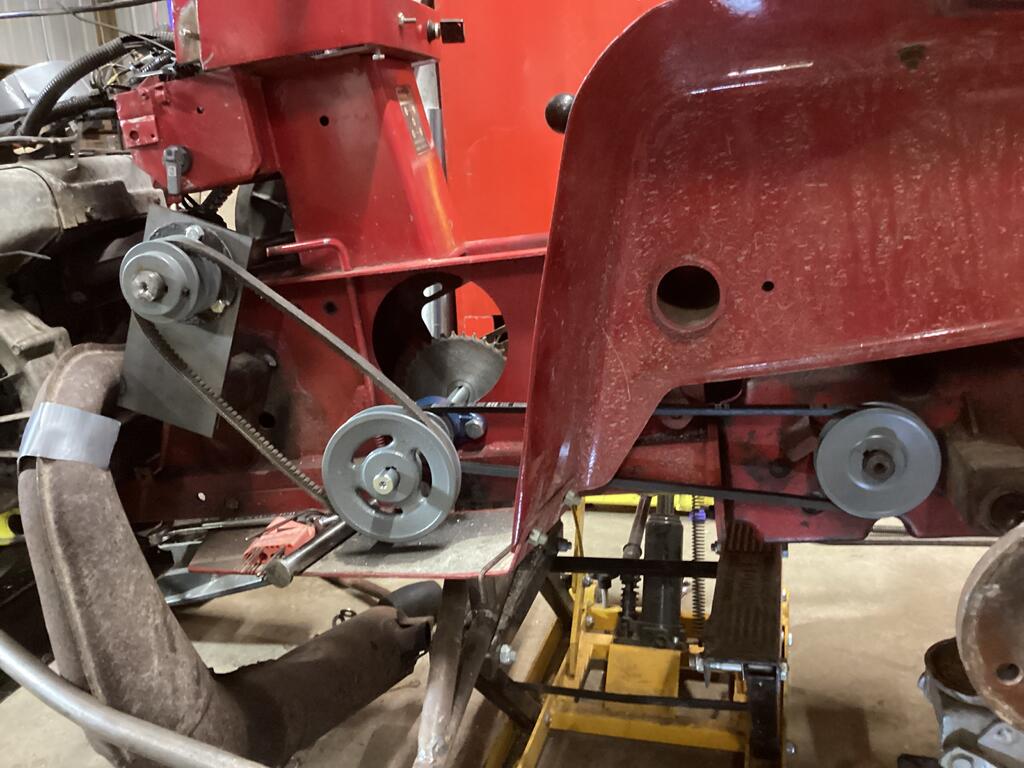

What belt progress I have made…. I should have my 4L445 belts on Monday morning.

I got my order from www.offroadbelts.com today. I need to shim the tensioner bracket a smidge, but otherwise It looks good!
