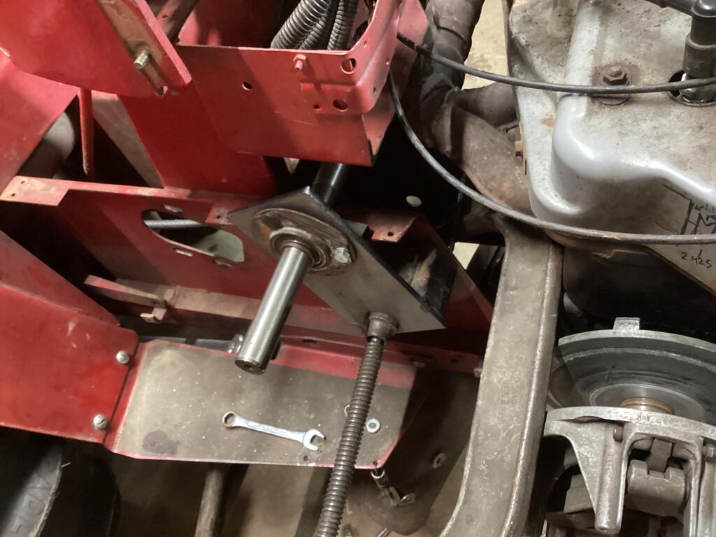

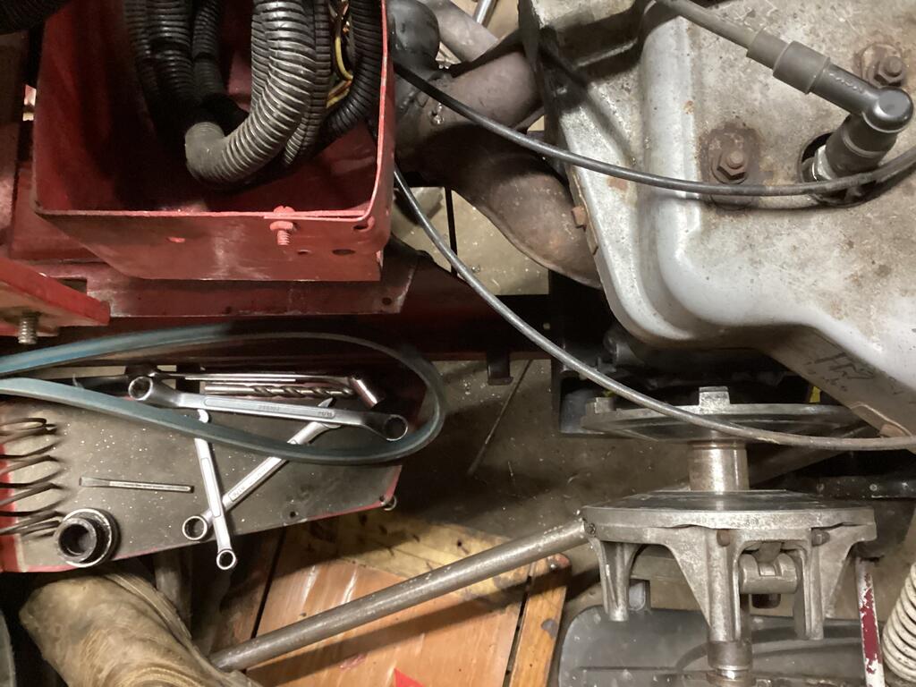

I think my goal right now is to set up the jackshaft on the frame, and get the engine aligned correctly.  I either need to cut the battery box out of the machine and trim some other stuff to make room for the secondary clutch, or move the engine to the right.  I think moving sounds easier.  This transmission was said to have been rebuilt before I got it, and I like the axle width.  I’ll need to retain those axles, no matter what transmission I choose if I keep a Wheel Horse transmission.

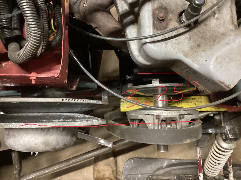

At minimum, the engine needs to move to the right 1.25”.  The outside of the secondary measures 3.25” from the air cooling shroud on the engine on a parallel.
I can easily clamp a fence to the frame in front of the engine, slide it over and re-drill the mounts.
Pullstart
I got it slid over about 3” and bolted it down.  All kinds of room for whatever now.

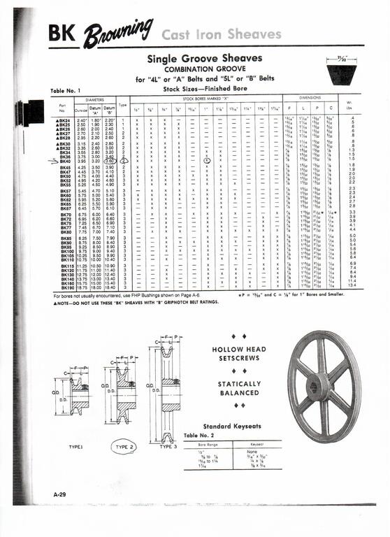

BK26X3/4

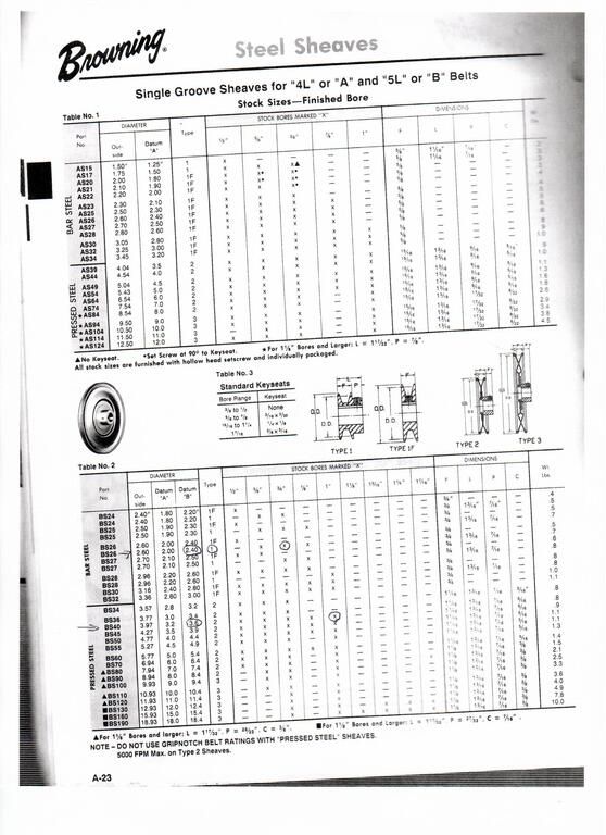

Do you know of a source for steel pulleys in this flavor, or would I need to make them on a lathe based on specs?  It looks like there are 4 belt options for those pulleys (4L, 5L, A, or B) would you suppose a rubber automotive or circle track race car belt would be optimal, for grip and for flexibility or keep with a Kevlar garden tractor belt for some available slip as you mentioned in your voicemail?

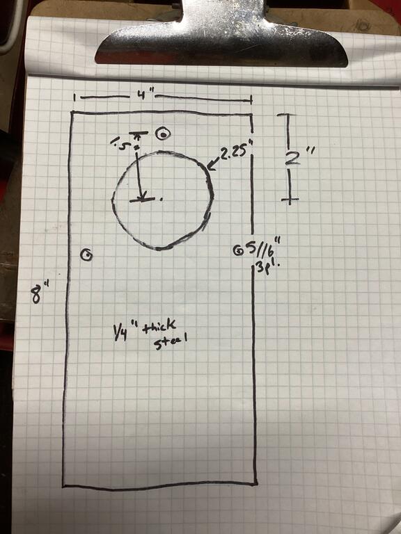

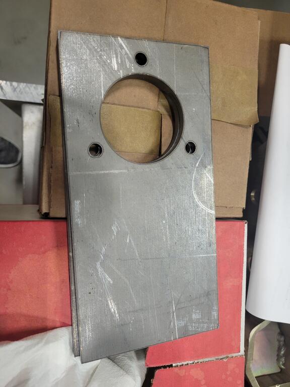

I drew up some tabs to hold the carriers in place.  I might have them laser cut if the shop has time, but might just mill them.  Please disregard the apx. 2” distance on two holes, though they are supposed to be on a 1.5” radius. :hide:
  • Like 1
Wild Bill 633
See the attached pages from a Browning sheave catalog. The BS26 is bar steel. The BS40 is stamped steel and the BK40 is cast iron. I would suggest having one machined from bar steel.
I will look at belts tomorrow.

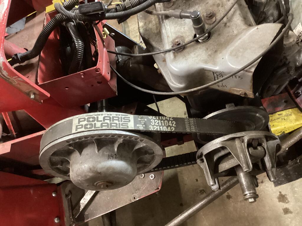

Got a picture today :banana-wrench:

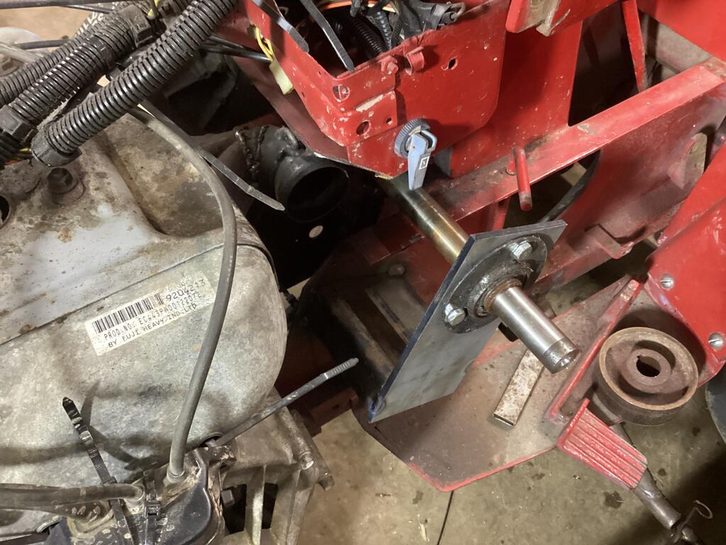

Things are tacked up for the jackshaft!  Now, I need to do some serious planning of one more reduction be it the input shaft or the brake shaft.
I left the left side bearing support wider than the right side on purpose.  It fits best with the exhaust pipe there, plus gives options for secondary reduction on a shaft if need be.

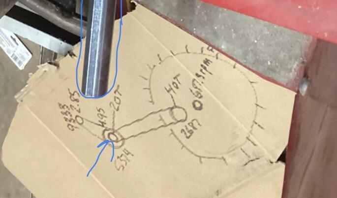

Pullstart
Ok.  I made an order on Zoro.  I’m driving the brake shaft.  My calculations say 60 or 65 mph.  I am guessing 50 will be realistic.  I’m running a belt off the secondary shaft.  It will go to another jackshaft mounted with flange style pillow block bearings, running a 20t sprocket to a 40t sprocket on the brake shaft.
I was on the phone with @Wild Bill 633, bench racing if you will.  During our conversation, I popped the right side tire off and noticed the input shaft is quite wobbly.  This will eliminate a couple shafts, rotating parts, etc, inside the transmission.  I’ll be able to plug the unused holes if I want.  No shifter, no gears.  Like a snowmobile, I’ll have go and don’t go.  Whew!
Mathin’ scribbles all around… got me what I need.  I think.

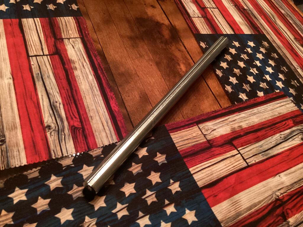

Pullstart
  • Like 1

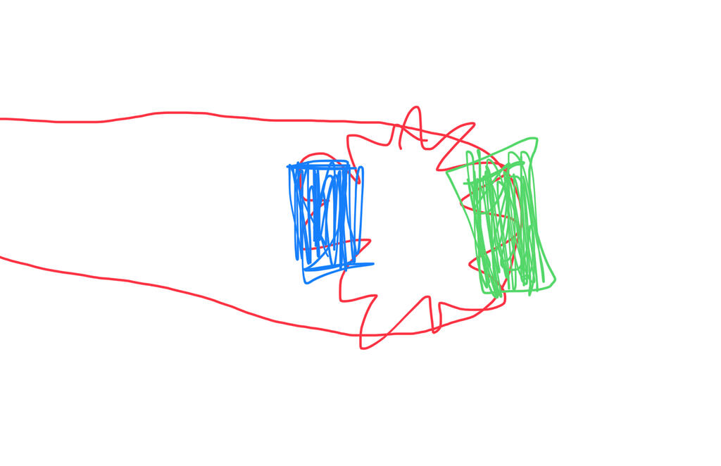

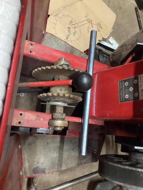

I found a nifty mechanical brake caliper for a go kart for $32 or so on the jungle site.  It’ll be here tomorrow.  Monkeying around in the barn when @Blasterdad was here the other day, I found a go kart jack shaft with some big sprockets on it.  The largest of the sprockets will be utilized as a brake rotor!  If possible, it’ll go between the frame rails on the new jackshaft.

Achto
Just throwing this out there. If you are driving off from the brake shaft with a chain, would there be room on that sprocket to install a caliper for the brakes?
Pullstart
maybe.  It’ll be tight, we’ll have to see.  If fitment were not an issue, would you prefer to place the caliper inside the chain, or the chain inside the caliper?
I think for damage prevention, the inside (blue area) would be my choice.
Achto
  On 1/30/2023 at 6:46 PM, Pullstart said:
Would you prefer to place the caliper inside the chain
The blue area would be the best. I have seen it done this way on other equipment. One other bonus would be still having brakes in the possible event that you would have a chain failure. Plus it would eliminate one more jack shaft.
Edited by Achto
  • Like 2
Pullstart
I need one more jack shaft anyway, to slow the secondary clutch shaft down.  I can’t achieve it with just one gear set.
The sprocket/rotor would ride on this shaft, between the frame rails of the tractor.
  • Like 1
