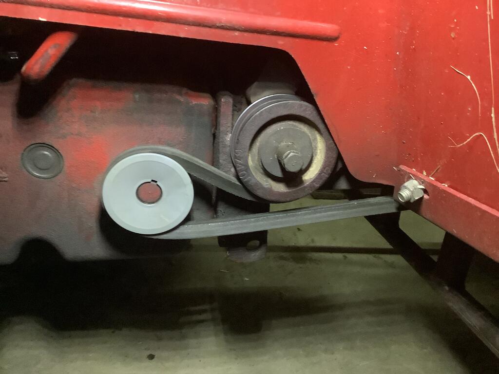

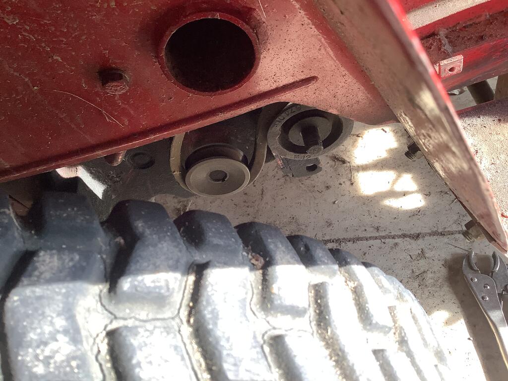

I mounted up the TINY rear pulley and installed another idler into the hydraulic pump slots for fine tuning adjustments.  Remember, the slack in the belt gets taken up by the clutch action squeezing together.

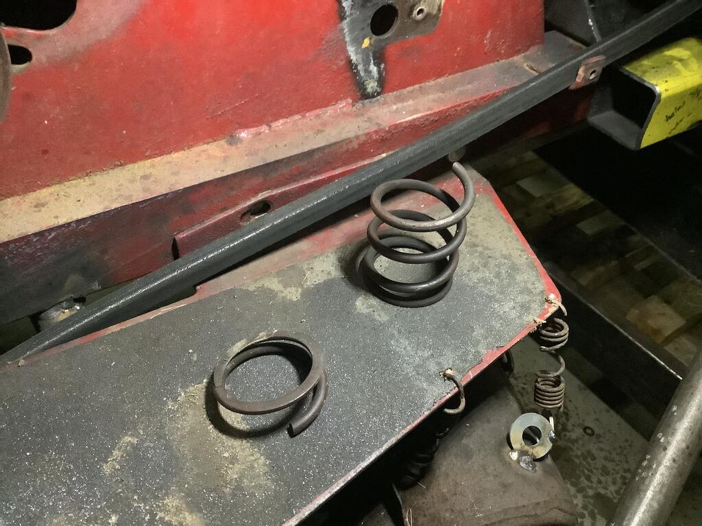

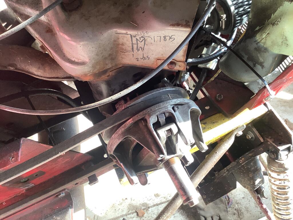

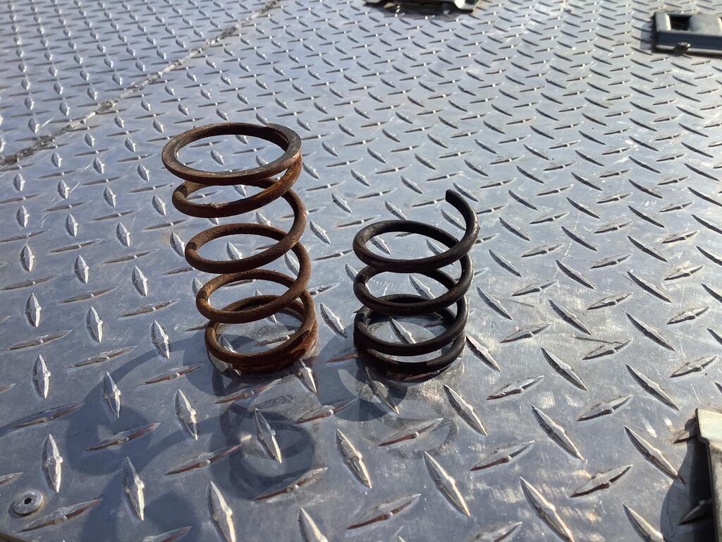

I also found the clutch spring is broken.  Hmm.  Stronger spring?  Higher stall?  Maybe the cams in the clutch have to do with that too…
  • Sad 1
The last parts 440 had a good spring.  Back in business!

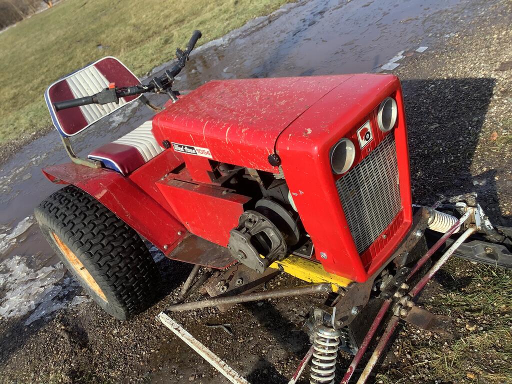

Sorry @SylvanLakeWH… I can’t justify wrecking expensive tires today.  Trial number eleventeen.

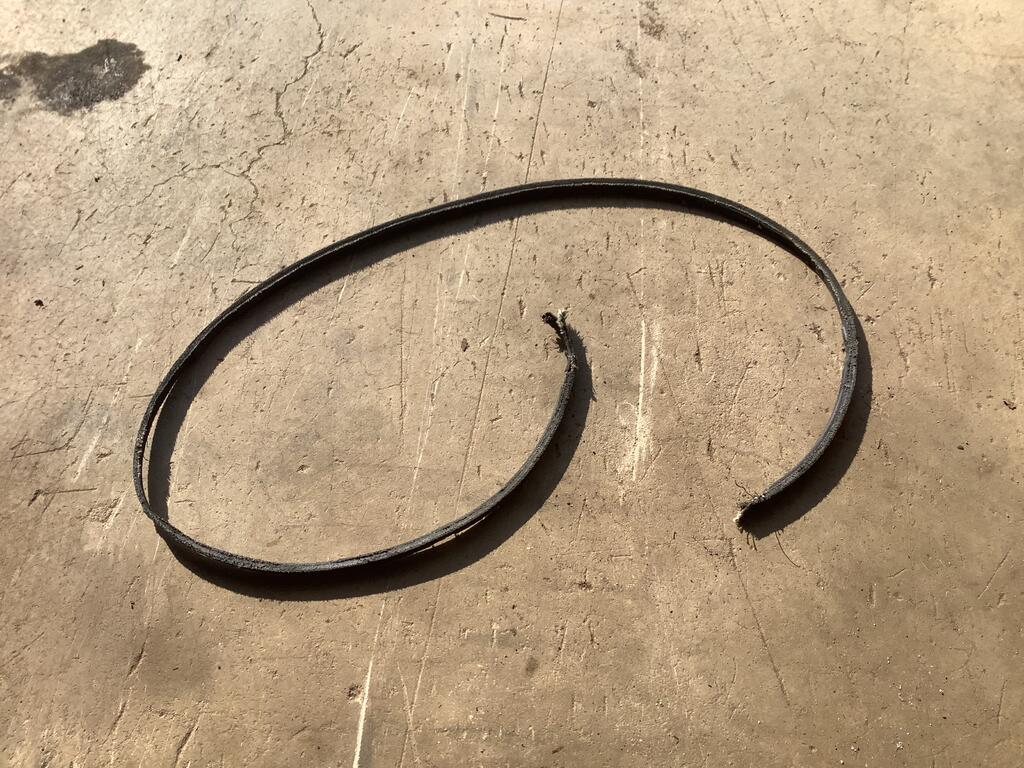

I found the limits of the belt…
  • Sad 5
Had lots of fun doing it though!

A cogged belt will grab that little pulley better

Can't tell from the big smile on your face but see a little mud spray on ya. The dry running instead of snow is probably a better stress test

@wallfish I met Mrs. P in town for a little school function and made sure to wash my hands and change my clothes.  She sent me to the boys room to wash my face!  :ROTF:

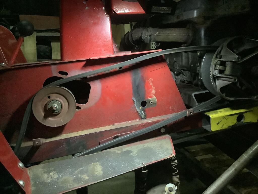

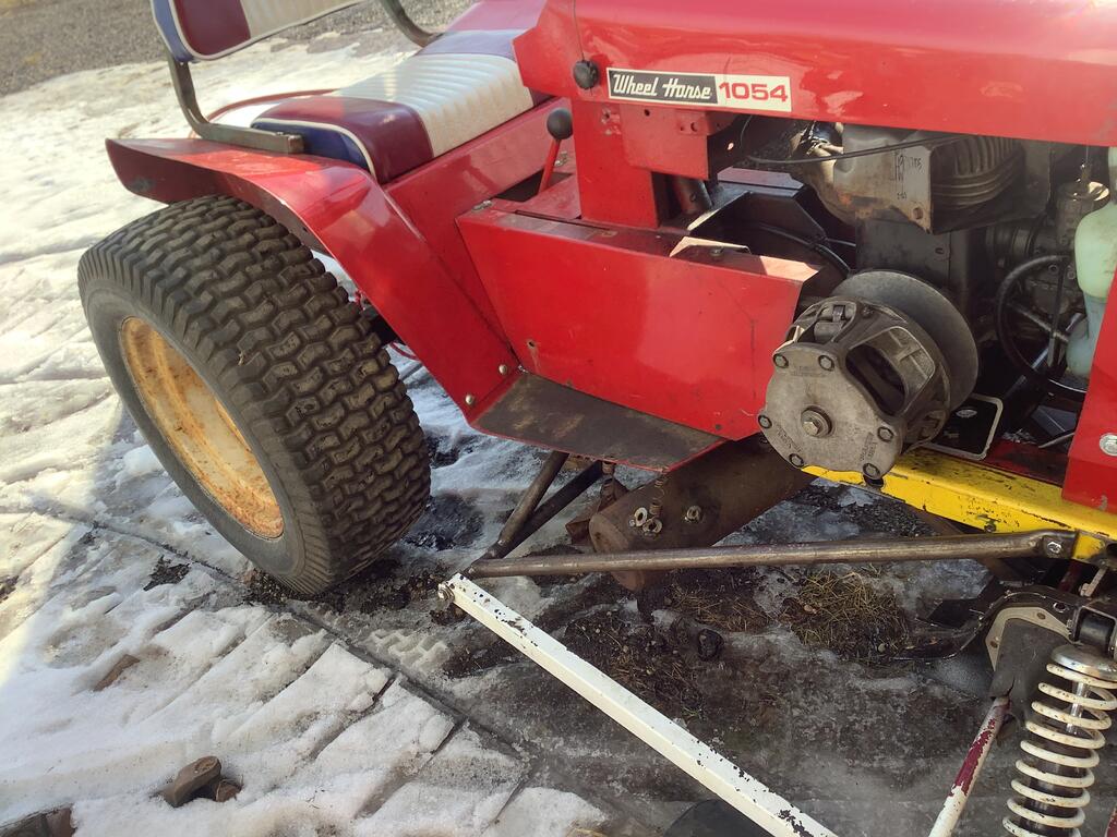

I took the primary apart, milled one face and and turned the other on the lathe, then reassembled it as a pulley with the spring applying positive pressure always.  I’ll be reverting back to the Wheel Horse clutch tensioning system but may have to use a @Bens vintage tractors idler setup on the tiny transmission pulley…
5AE7CB97-86F7-4277-8F28-401F06CC3150.jpeg.03e71bd1f4aa1de724fa8760ea7883e3.jpegThis belt might actually work, I just found it in a pile.  I need to grab the clutch idler pulley and see where it all lays.

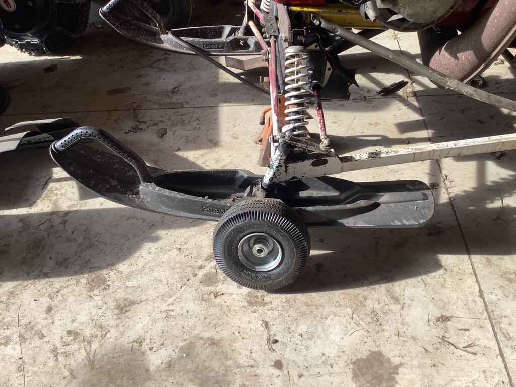

I also found a set of wheels and tires that’ll work to cruise the shows.  It’ll end up having a double shear mount and be supported by the top and bottom of the spindle bolts.  I’ll wait to get it all on the ground with the paddle tires mounted up again to see if I need to remove the springs up front for show season (or better yet pop the coil overs off a parts sled and cut the coils down to set the ride height).

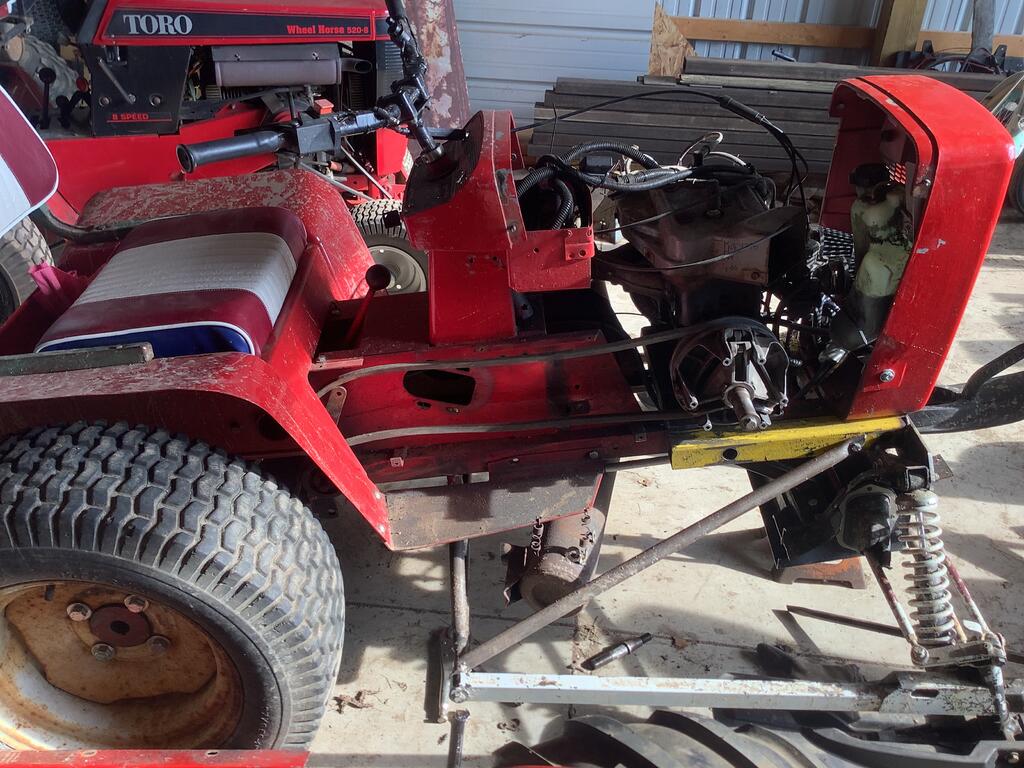

So, I modified the snowmobile engine clutch to become just a large pulley.  Check.  Introduce :wh: clutch pulley system, a hydro belt (remind me to measure it before I destroy it!) and it looks like I’ll be able to get it all going.  Well, I don’t think the engine has enough umph to start with a load on it, even in neutral.  Even after I pulled the belt and warmed it up, I shut it down, quick tossed the belt back on, and now it won’t start again.  It tries, it almost does, but just can’t quite.  It’s like the engine has zero torque to keep it running and it just dies.
I’m sure once I get the belt guides set, maybe setting the parking brake might help, but I’m thinking maybe not.
wallfish
There shouldn't be that much resistance with the trans in neutral. One thing I did on a fast hot tractor (35-40 mph) was change the gear oil to motor oil to reduce all that friction of the heavy oil. The thinner oil will sling plenty enough to lube everything at those speeds and will stay cooler too. Oil can get pretty hot from all that friction resistance.
IMO you should keep that pulley as variable. That gives a big wide range of speed beyond just the throttle and allows for more taking off torque from a stop. Plus it clutches on it's own.
Thanks for the thoughts on oil selection!  Unfortunately the modifications I did to make the pulley diameter larger for more output speed rendered it not variable.  Hopefully though, it’ll allow me to come to idle, press the clutch pedal, shift gears, then let the clutch out and pull the throttle like a motorcycle or vehicle.

Not to rehash since it's fixed position now but did you ever try the variable with the longer belt and the spring idler set up? The spring idler should allow that belt to ride high in the groove when the pulley closes all the way. Like it is now. Curious because I'm working on one now with a varible pulley

You could be on to something.  I was thinking maybe more fuel, or different plug gap?  Maybe I’ll put the clutch back to opening and closing and see what happens..
wallfish
If you can make it variable again, the spring tension on the idler arm may need to be adjusted for tension until it allows the pulley to fully close but also not slip on the small trans pulley. That's the trick to see if it works with a small fixed pulley on the trans. Possibly some belt length changes too.
And you can go with a rubber sided belt which will grab the grooves more since the clutching is done with the variable. Also a cogged belt will bend a lot better around that small trans pulley. Something like this.
https://www.walmart.com/ip/5VX1120-Cogged-V-Belt-5-8-x-112in-Outside-Circumference/367796051?wmlspartner=wlpa&selectedSellerId=101007552&adid=22222222222307256484&wmlspartner=wmtlabs&wl0=e&wl1=o&wl2=c&wl3=74904337256595&wl4=pla-4578503886446703&wl5=&wl6=&wl7=&wl10=Walmart&wl11=Online&wl12=367796051_10001026921&wl14=5%2F8 cogged v belt&veh=sem&msclkid=fc4853c2bf4d10aa7002315410572b5b&gclid=fc4853c2bf4d10aa7002315410572b5b&gclsrc=3p.ds
If it works that thing would have great low speed torque and pretty good high end speed
