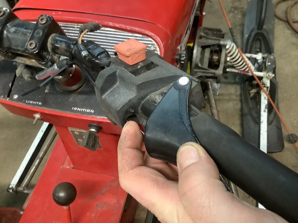

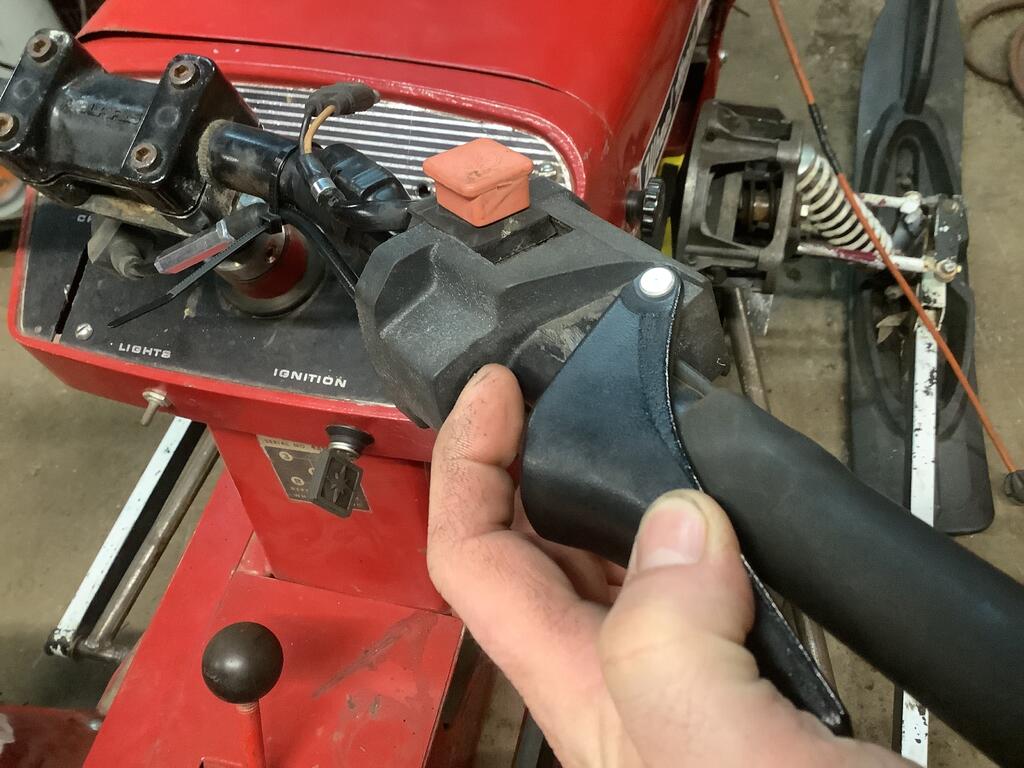

Isn't that a throttle safety swith?
  • Like 1
Oldskool
Pullstart
I believe you Mike.  I’m not saying the other guy is wrong, I’m just saying your video has a better explanation.  I got it running with no wiring but a kill (key) switch.  Once I put the throttle extension on, I had an idle issue.
  • Like 1
Oldskool
I didn't know but the video would help the masses follow along as well.

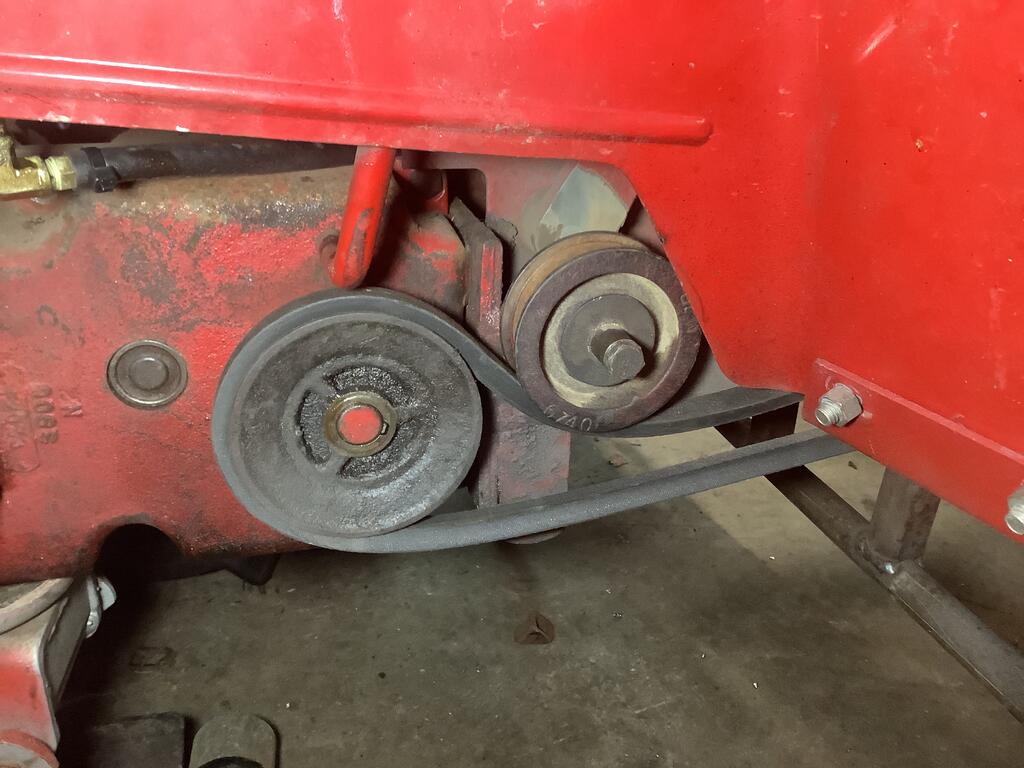

This is a stock 3 speed pulley off a 606.
  • Like 1
  • Excellent 1

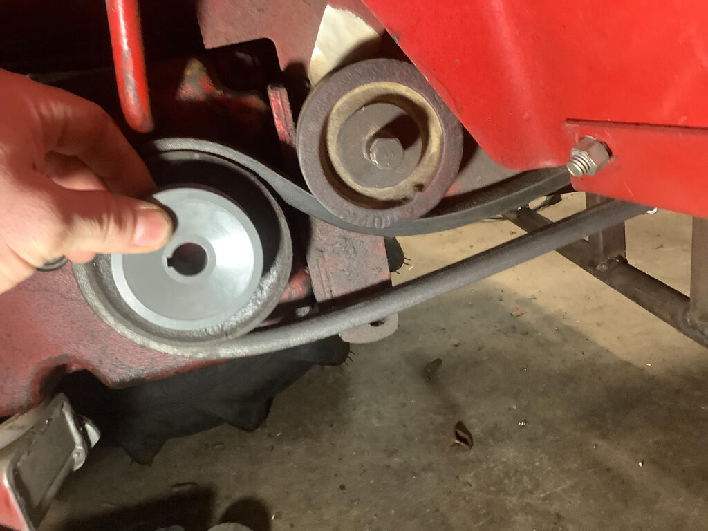

Pullstart
This is a 2.65” pulley (of the wrong shaft size).  A replacement will arrive tomorrow.
  • Like 1
  • Excellent 1

Lee1977
I think your going to destroy belts with that much HP and that small pulley just not enough area on the pulley. Wallfish posted a pulley layout on the Colossus Project ( can't call it a build ) . You need to move the engine an inch or so to the right and add a jackshaft with the spring loaded pulley from the snowmobile. The finish gearing with larger pulleys to the transmission.
Wall fish's drawing on page #5 post #111.
Pullstart
I’m well aware of the possibility for destroying a belt, but thanks for your concern!  Stay tuned for carnage details!
