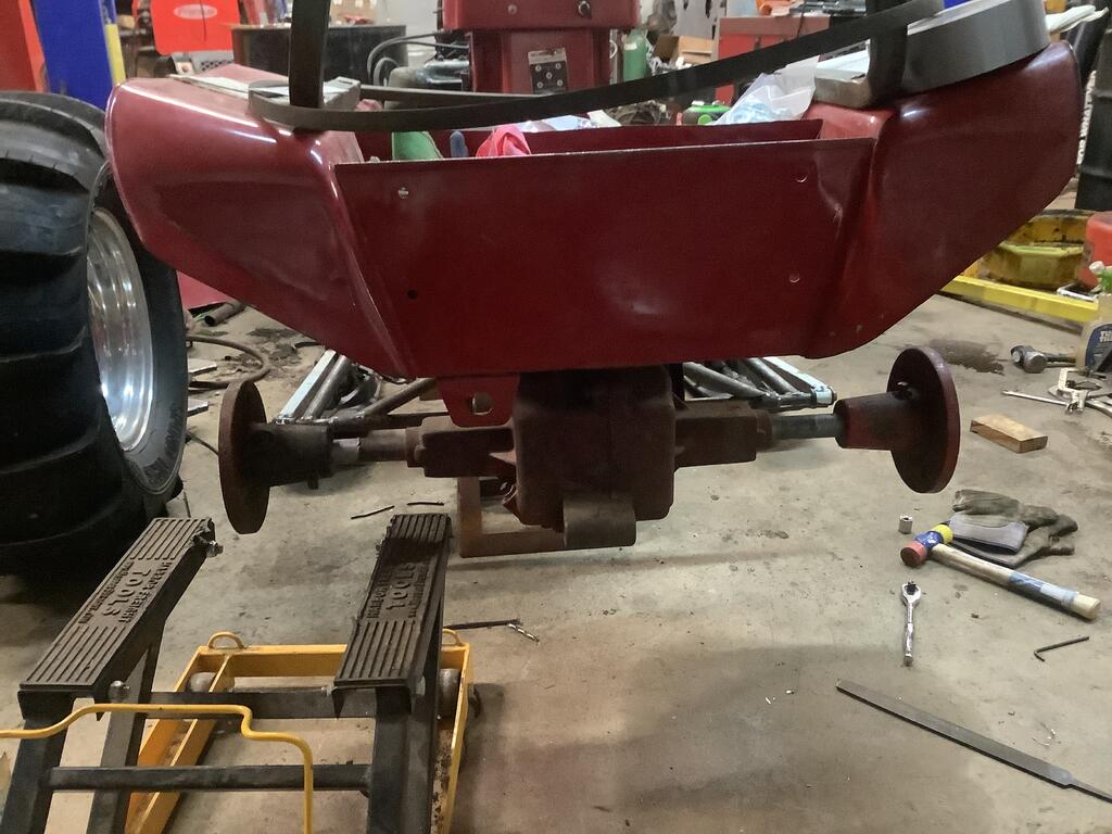

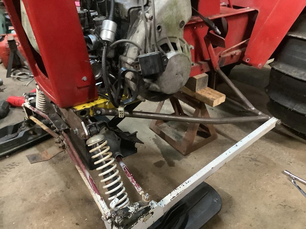

Engine is in, front end is all bolted down tight.  Everything is coming together so well!
I’ll pop the rear tires off and work on brakes, trans pulley keyway , fuel line and trans lube.

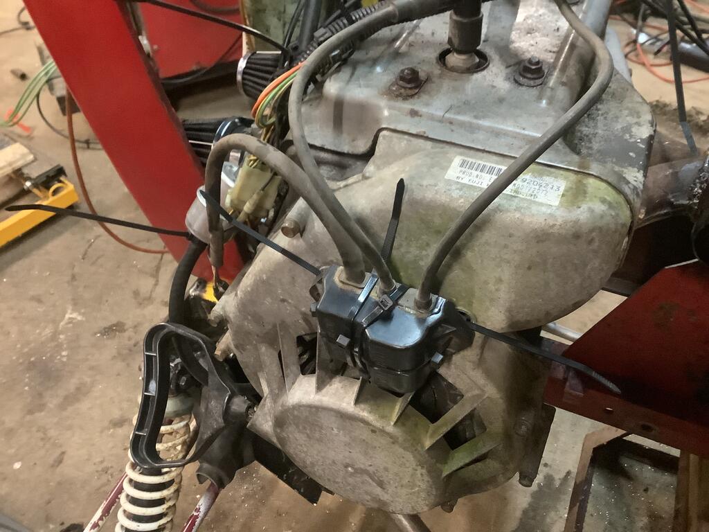

  On 1/28/2022 at 12:31 AM, 8ntruck said:
Remember the horsepower rule - if some is good, more is better, and too much is just enough.
I applied this rule to zip ties and cdi box mounting.
probably should have put studs on from the back side when I cleaned the mice out…

  On 2/9/2022 at 5:25 PM, Pullstart said:

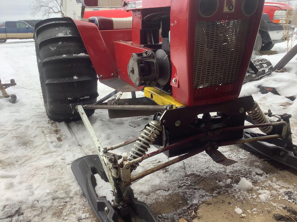

Lots of little braces to go, but the Snowmotractor is sitting, on it’s own weightbearings, with support to the trailing arms.  I’m calling this a small victory!  @Handy Don the frame is 1/4” thick 2” angle iron and the F plate is 3/8” thick FYI.  Because of some frame modifications done, I’ve made the choice to not have this alterable back to stock front end components.  For that reason, I’ve done some welding to the frame today.
:dance:
You got me very curious and, since today is a bit warmer, I gathered my ruler and calipers and headed out for a "frame check".
'95 520: 6 ¾" outside, 2 x 2 x ¼" rails; F-plate = ¼"
854: 6 ¾" outside, 2 x 2 x 9/32" rails (checked in two places!); F-plate = 5/32" (and cracked!)
So the 1054 vs 854 differences are the extra 7/32" (to ⅜") at the F-plate and the wider (8") rail spacing. Both of those will help a lot with resisting twist. (I'm considering the 1/32" difference on the rail thickness a tolerance range.)
I'm enjoying following your progress. The triangulating of the struts should be adequate for keeping the front end pointed straight ahead, but am not convinced on leaving it all on the frame ahead of the F plate.
  • Thanks 1
Pullstart
Thanks Don!  There’s one way to find out how well it’ll hold up.  Run it hard!  Hopefully I can get it buttoned up before the weekend.  If not, soon after!
  • Excellent 1
Handy Don
Agreed. I do tend to overthink and overbuild sometimes as though I were building the Pyramids or something. :lol:

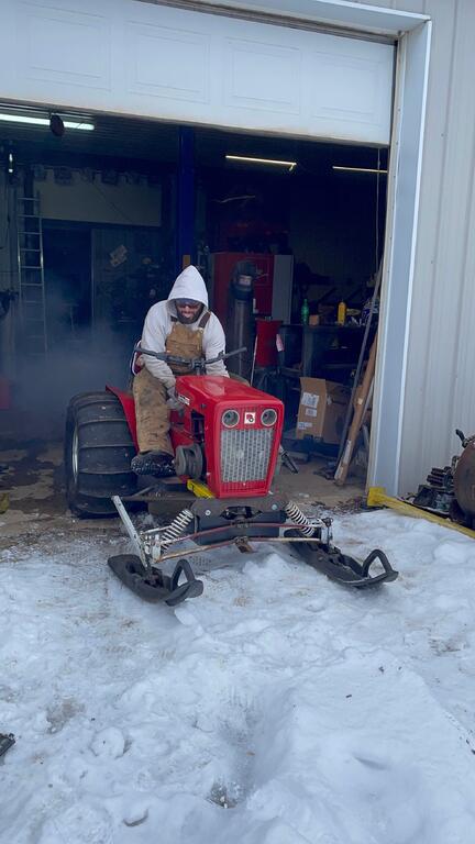

It moves…
  • Like 2
