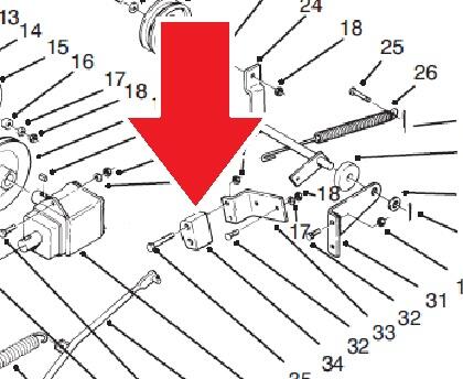

This idler thing and my response to the original post is concerning a 2 stage blower not an idler for a SS. There was no original sprocket/bearing there on a 2 stage blower for chain tension so not sure how you are looking up that exact replacement bearing. You're easily looking up the wrong thing!. From the factory it was a wood or plastic rubbing tensioner as written before if you read the post. SEE BELOW for the part reference!
The idler I posted is smaller and only a 10 tooth size and more easily fits into that very short small span of chain between the gearbox sprocket and the big sprocket on the back of the blower housing and does so without any contact to any other sprockets or parts. No difficult modifications to add that at all. It's very easy to do. And for only $10 each it's better to replace the whole thing every 10 - 15 years or so than it is to spray that grease crap in it every where and every time before and after when using it. That areas is not easily accessable as it's under a bolted on cover plus mine has the electric chute motor bracket attached there too.
The 17 tooth sprocket exactly like you posted was taken out and replaced with this 10 tooth on purpose because the 17 does not fit as well in that tight space. Plus the 10 tooth holds the chain tension better. Upgrade! This is only an idler sprocket used on the slack side of the chain loop. So without any side load, or any load at all for that matter, there's no need for a big huge bearing and sprocket in there. It's only purpose is to take up the loose slack of the chain and guide it to keep the chain links engaged with the drive sprocket better. If there is slack on the chain it tends to raise out of the teeth grooves of the smaller drive sprocket from centrifugal force and that allows only partial engagement with less teeth of the sprocket.
I've had one of these 10 tooth sprockets for chain tension in my 2 stage for a while now. No problems at all ! IT"S VERY EASY. Super simple.
Spinning twice as fast as a 17 isn't any issue so far either. Do whatever you want. And like Garry posted, I use steel bushings for changing size of bore on pulleys or sprockets. That's an upgrade to those bronze bushings so you may want to try them.
Not sure why you posted like that with CAPS and all and with the nonsense directed at me by the tag,  like I'm the stupid one ?
tension.jpg.1e47a0ff4b5e999d9e3076144580c105.jpg34 is not a 17 tooth sprocket
