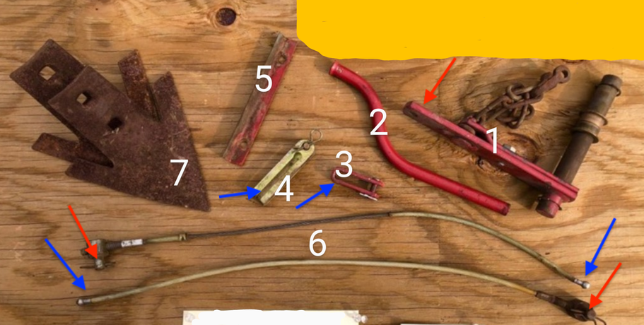

ebinmaine 70,739 #1 Posted January 24, 2022 What exactly are these parts and where do they go? 1. Appears to be a rear hitch mounted rock shaft? For what? 2. Transmission cable tunnel? For what tractor? The rest? Share this post Link to post Share on other sites
JCM 10,017 #2 Posted January 24, 2022 You will need # 1.2,3 and 6 to operate a tiller. # 2 fits the maroon stripe tractors for the rear cable lift. Never using my tiller not sure about 4 and 5. 7 might be for a cultivator ? 2 Share this post Link to post Share on other sites

JCM 10,017 #4 Posted January 24, 2022 I consider 1985 through 1989 to be maroon stripe. I think those parts are used for a rear slot hitch but not 100% sure. 1 Share this post Link to post Share on other sites
grinchsr 642 #5 Posted January 24, 2022 Number 4 is the long clevis used on the hydros to mount the tiller. The 8 speeds use a shorter one 1 1 Share this post Link to post Share on other sites
Ed Kennell 40,484 #6 Posted January 24, 2022 5 might be a PO made battery clamp. 1 Share this post Link to post Share on other sites
ebinmaine 70,739 #7 Posted January 24, 2022 Any thoughts from anybody where 7 would go? Looks like some kind of a row maker for potato hiller? 1 Share this post Link to post Share on other sites
lynnmor 7,560 #8 Posted January 24, 2022 #5 might be the attachment point for the lift assist spring on a tiller. Roll it over, is it like a piece of angle iron? 1 Share this post Link to post Share on other sites
Skwerl58 750 #9 Posted January 24, 2022 Number 7 appears to be a cultivator cutter or tooth??? Dad had some implements for his old 77? Sears ST16 and the cultivator had cutters like that on it. That was a fine old tractor and he sold it to a family member about 5 years ago with all equipment and they love it. Those other parts do appear to be parts for the lift for the clevis hitch. I have one on my 87 414-8 but can't say for certain it is for it. They are good parts to have around. 3 1 Share this post Link to post Share on other sites

Achto 28,778 #11 Posted January 24, 2022 1 hour ago, ebinmaine said: Any thoughts from anybody where 7 would go? There are many different types of shovels for cultivators. #7 is one variation. 1 1 Share this post Link to post Share on other sites
oliver2-44 10,367 #12 Posted January 24, 2022 1 hour ago, ebinmaine said: Any thoughts from anybody where 7 would go? Looks like some kind of a row maker for potato hiller? Its not a large tractor row maker, those are larger shovels. However for a home garden you could probable use it to make rows, just not as high/deep as a large Hiller Shovel. Once a crop is planted and is growing its used to "cultivate" ie run down the row between the plants to de-weed and soften the soil to help absorb water. Think of it like a chopping hoe. 1 Share this post Link to post Share on other sites
Handy Don 13,340 #13 Posted January 24, 2022 Cables #6 go through tube #2 to skirt around a hydro trans on the 300, 400, 500 (and others?) between the mid- and rear (#1) rock shafts. Pins on red arrow ends of cables go through the red arrow hole in rock shaft #1. Blue arrow ends of long (#4) and short (#3) clevises hold blue arrow ends of the cables. Long clevis (as noted above) is needed for hydros, short for 8-speeds (which use a shorter, straight version of tube #2). Not shown is the clamp, held down by one of the transmission-top bolts, that holds the tube in place. I agree that #7 are cultivator points. I've seen #5 somewhere but can't recall where! 1 1 Share this post Link to post Share on other sites

Handy Don 13,340 #15 Posted January 24, 2022 9 minutes ago, ebinmaine said: Eaton? Yep. At the forward end the tube nestles into a hole in the transaxle casting and lines up with a hole in the F plate. On a lot of tractors up to the mid-80's the tube was factory installed, Then it seems they stopped on the lower horsepower and 300 models. 1 Share this post Link to post Share on other sites

Handy Don 13,340 #17 Posted January 24, 2022 2 hours ago, ebinmaine said: @JCM Any idea if that should be on a 417A? Easy to check. It'll be clamped to the seat bracket where it sits on the transaxle. It uses one of the two bolts that secure the seat/tank/fender bracket to the transaxle. My '95 520-H chassis didn't come with one but I was able to get one off the '89 518-H parts tractor, with clamp, and drop it in with wiggling and gentle tapping. 1 Share this post Link to post Share on other sites
JCM 10,017 #18 Posted January 25, 2022 I think all my 3,4 and 500 series tractors have that tube. 1 Share this post Link to post Share on other sites
