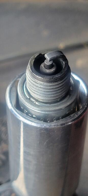

RED-Z06 2,479 #4 Posted January 21, 2022 Plug comes out dark cocoa brown, she had 217⁰ cylinder head temps...shes tuned well. Only hits 245⁰ under a 25% load. Share this post Link to post Share on other sites
Jeff-C175 7,203 #5 Posted January 21, 2022 (edited) 19 minutes ago, RED-Z06 said: Plug comes out dark cocoa brown, she had 217⁰ cylinder head temps...shes tuned well. Only hits 245⁰ under a 25% load. So what are you saying? That you think that it's normal? Edited January 21, 2022 by Jeff-C175 1 1 Share this post Link to post Share on other sites
Snoopy11 5,717 #6 Posted January 21, 2022 (edited) That is not normal. Don Edited January 21, 2022 by Snoopy11 1 Share this post Link to post Share on other sites
RED-Z06 2,479 #7 Posted January 21, 2022 11 minutes ago, Jeff-C175 said: So what are you saying? That you think that it's normal? At night...thin walled muffler glowing at the port of a running engine, its not abnormal...most people dont run engines in pitch black conditions, most people dont run saws at night either...but the mufflers will take on a nice glow if you ever get a chance to really run one like that. Going by the plug, cht, the fact it's not bogging at all...yes, its normal. My phone in night mode also makes it seem much brighter than it is...to the naked eye there was only a small patch of orange where the port dumps in. 1 Share this post Link to post Share on other sites

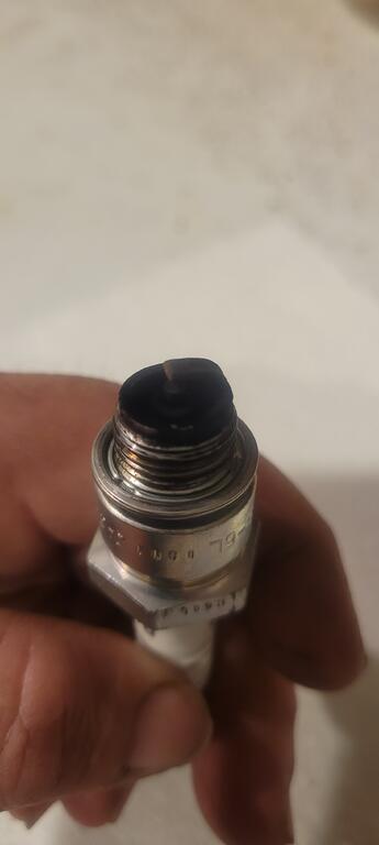

RED-Z06 2,479 #10 Posted January 21, 2022 Went out and pulled the plug...havent touched it since i made that video...you tell me... 1 Share this post Link to post Share on other sites
Jeff-C175 7,203 #11 Posted January 21, 2022 1 hour ago, RED-Z06 said: you tell me Too rich. 1 1 Share this post Link to post Share on other sites
RED-Z06 2,479 #12 Posted January 21, 2022 22 minutes ago, Jeff-C175 said: Too rich. But @WHX?? and @Achto said to give it more fuel...??? The ground strap was just starting to clean up the soot from the choke from starting cold...with a load it cleans right up to dark cocoa. Its running very well, temps dropped from 65 to 35 in a couple hours with a chance of snow tonight. 1 Share this post Link to post Share on other sites
Jeff-C175 7,203 #13 Posted January 21, 2022 (edited) 6 minutes ago, RED-Z06 said: But @WHX?? and @Achto said to give it more fuel...??? Yeah, I saw they said that... but that plug is telling me it's too rich. But, what do I know? Lean it out and see what happens... How would a ground strap clean up soot? Edited January 21, 2022 by Jeff-C175 1 Share this post Link to post Share on other sites

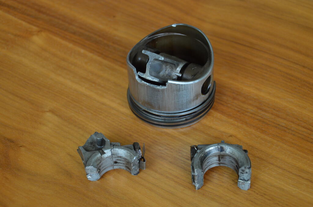

Maxwell-8 4,366 #15 Posted January 21, 2022 (edited) 3 hours ago, RED-Z06 said: when they are lean, you can always tell, they take forever to warm up When lean, temperatures go trough the roof very fast. explaining the exhaust glowing. The last engine I ran lean looks like this currently: Edited January 21, 2022 by Maxwell-8 2 1 Share this post Link to post Share on other sites
RED-Z06 2,479 #16 Posted January 21, 2022 4 hours ago, Maxwell-8 said: When lean, temperatures go trough the roof very fast. explaining the exhaust glowing. The last engine I ran lean looks like this currently: Looks like a chrome piston out of a kool bore briggs possibly. Im seeing a lubrication issue at the big end, the high break suggests potentially an oversoeed issue. A lean 4 stroke will detonate and eventually seize the top end...but im not seeing a seized piston there. 1 Share this post Link to post Share on other sites

Snoopy11 5,717 #18 Posted January 21, 2022 5 hours ago, RED-Z06 said: Looks like a chrome piston out of a kool bore briggs possibly. Im seeing a lubrication issue at the big end, the high break suggests potentially an oversoeed issue. A lean 4 stroke will detonate and eventually seize the top end...but im not seeing a seized piston there. NoNoNoNoNo... @Maxwell-8 and @Jeff-C175 are both correct. Although... I am not there... and can't see what has been done to the engine... here is my analysis of this issue: It would appear, in my opinion that the glowing could also be caused by mal-adjusted valves, leaky, and/or burnt valves. It is possible that you are pouring in more fuel... enabling it to run at what you consider to be normal... but it is not at the correct mixture/ratio... which could be causing SOME of the issues we see here. I am wondering... if possibly... since you say that you measured everything on the bottom-end and put everything together properly... and more information is now coming along... you need to disassemble the top end and check. Ignition timing... which I have already mentioned several times to check (but have gotten ignored)... is another possible suspect. @squonk... I hate to throw you into the fire... literally... but what is your opinion? Don 2 Share this post Link to post Share on other sites
