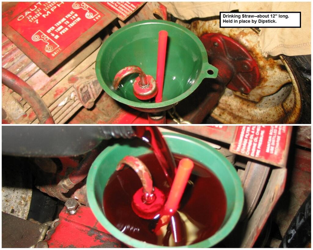

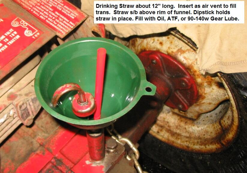

Pullstart 63,529 #7 Posted January 18, 2022 It seems some people stick a small straw down the fill tube as well, just into the case. It creates a vent that allows faster pouring… 2 Share this post Link to post Share on other sites
SylvanLakeWH 26,587 #8 Posted January 18, 2022 39 minutes ago, Pullstart said: It seems some people stick a small straw down the fill tube as well, just into the case. It creates a vent that allows faster pouring… That’s what I do, slow and steady… oil follows the outside of straw down and air vents out the straw… Still slow… but not as slow… 2 Share this post Link to post Share on other sites

daveoman1966 3,768 #15 Posted January 18, 2022 This method workls very well...at no extra cost either 3 Share this post Link to post Share on other sites
