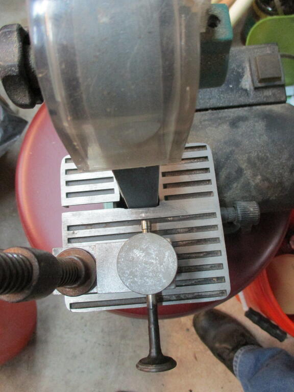

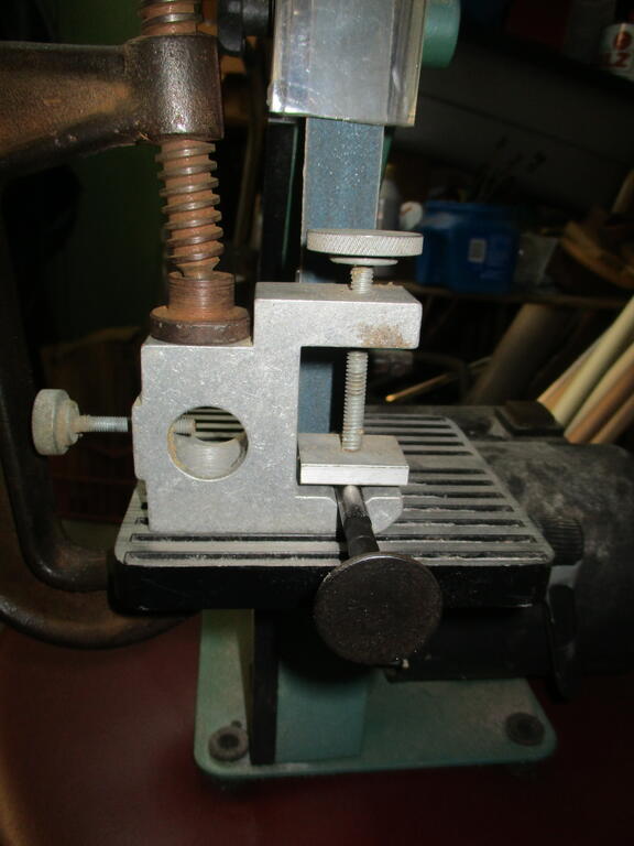

Got my parts from Lincoln, governor gear and shaft. So, I started assembly today. Took me three tries to get that two-piece crank in, thankfully it was within spec when done so I didn't have to take it back apart to shim!  Got the crank in, lapped valves and ground to spec. I found this old aluminum fixture from a hospital bed oxygen filter mount and squared it up on belt sander that worked really well on valve stem. Progress at last, will finish up soon. Hope it runs well when done! Going to put it on my 653.

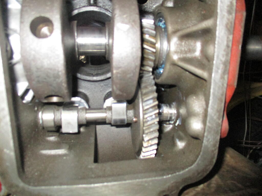

      Okay engine Guru's, newbie needs some help! Rebuilding older 8 horse and I am new to small engines. I have rebuilt numerous car/truck engines but never a kohler k. I have researched all available videos and really appreciate the small block tutorial by Prondzy. I am at reassembly stage, so my question is, related to timing marks. I have camshaft with centrifical advance which has a groove or line on spacer that engages pawls. does this groove line up with pointed part of casting on inner rim of gear? Also, there is a groove on opposite side of camshaft gear that I believe should align with pointed mark on casting of crankshaft. See attached pictures. Thanks for any help. Just want to be sure!
