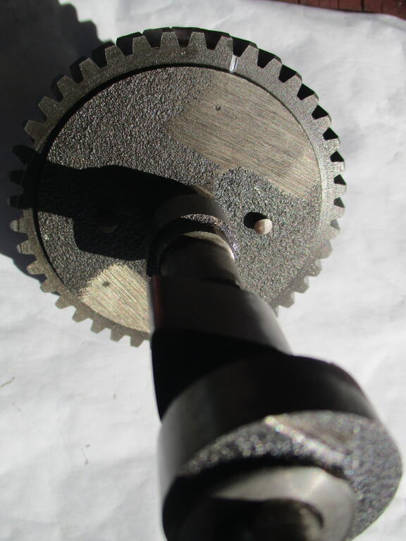

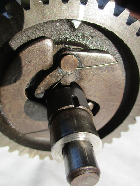

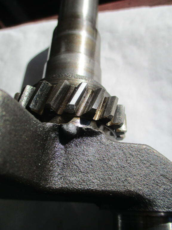

Okay engine Guru's, newbie needs some help! Rebuilding older 8 horse and I am new to small engines. I have rebuilt numerous car/truck engines but never a kohler k. I have researched all available videos and really appreciate the small block tutorial by Prondzy. I am at reassembly stage, so my question is, related to timing marks. I have camshaft with centrifical advance which has a groove or line on spacer that engages pawls. does this groove line up with pointed part of casting on inner rim of gear? Also, there is a groove on opposite side of camshaft gear that I believe should align with pointed mark on casting of crankshaft. See attached pictures. Thanks for any help. Just want to be sure!
You want that triangle shaped thingy on the cam to line up with  the little nubby thingy on the crank. And that groove is the timing mark for the points lobe and you want that lined up with the triangle as well. Don't forget your cam shim.

Thanks for that reference, somehow missed that originally. I am having similar experience with this build. Didn't pay much for engine that was supposedly all ready to go except for governor arm and spring. When i got inside found all sorts of broken/missing parts. Finally sorted out and attempting to reassemble. Since I never attempted kohler before wanted to be absolutely sure of timing. That cam is an interesting animal to get correct!
That's why I ash-canned the spark advance cam and installed a compression release version with matching tappet.
