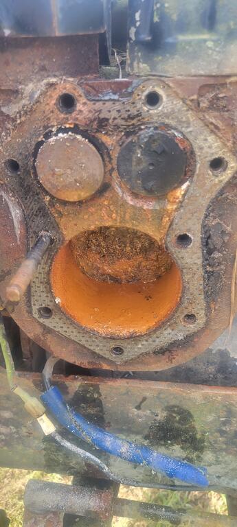

Was given one this morning...had high hopes but the KT was stuck...pulled a head and
  • Sad 5
ri702bill
Yup - intake valve is open, cylinder (and probably the pan) is full of water - flood tractor???
Nothing a little old school Liquid Wrench wouldn't fix...
... With help from a sledgehammer maybe.
  • Haha 2
RED-Z06
Nothing in the pan but oil, both cylinders are like this, i loosened the head bolts and water ran out.  Its a goner, whole tractor was rough...i stripped a few parts off, wheels/tires, knobs, hood, carb/intake/filter and probably pull the rear fender off before she takes that last ride

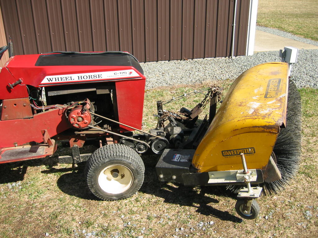

My brother has had JD 317 for many years and he got it used.  Back in the 90s he replaced the KT-17 with a new one as the original was over two thousand hours and leaked like a sieve.  Family trait of never throwing anything away he put in the loft of his barn.  About 2006 I picked up a C-175 that had a ventilated crankcase.... Got the stored motor put in some new seals, swapped sheetmetal and intake/exhaust manifolds and she is now on sweeper duty.  Smokes a bit on start up but it clears pretty fast and she goes to work.  Meanwhile he is still using the 317.. it is a beast....

Scrap man coming Sunday to get her.  Love to keep the hydro but not sure how we would load the tractor on his trailer
oliver2-44
Keep the Hydro and put the rear end on a hand truck to get it to his trailer, or just let the scrap man earn his free scrap metal.

We were planning to use a jack to get the wheels and tires off the front and rear after pushing it up with a Z mower.  The trans has the hydraulic lines, brake connections, the hard mounts, drive shaft..it would be a bit of a task to get it loose

This one rolls about 1/4 turn...but its a series1, would need to be bored and go oversized, valves are seized, carb is waterlogged, starter seized...the 1/2 turn steering play says its got well over 1500 hours on it.
pfrederi
 Agree!!! a series 1 in that shape is  a boat anchor not worth thinking about.....
