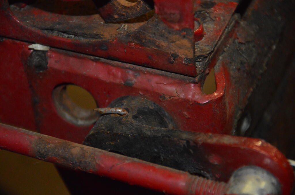

A bad fix on my C141D ( not done by me)
Edited by Maxwell-8
  • Sad 1
peter lena
@Maxwell-8   sure looks like a roll pin to me , never seize it in , use a flat faced punch , easy , pete
