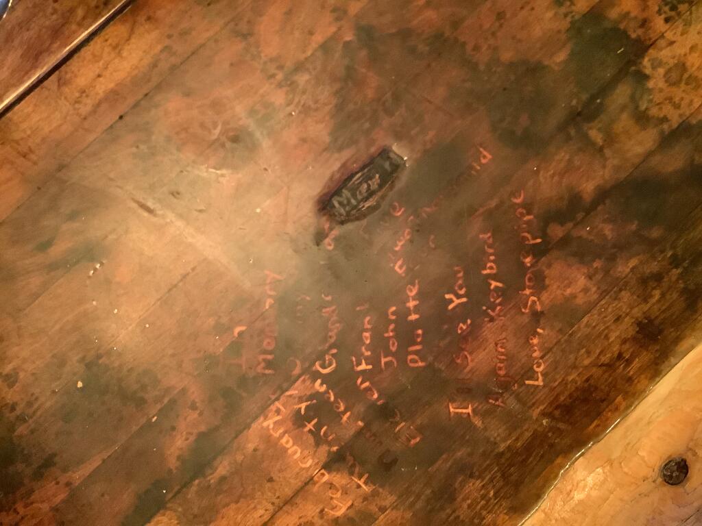

I made a huge mistake, carving the death date wrong.  It was a moment that my mind wasn’t clear enough to remember that April was month number 4 in the year.  Nerves.

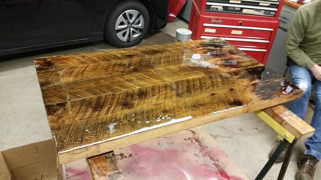

A vanity top I build for some friends and covered in 50/50.

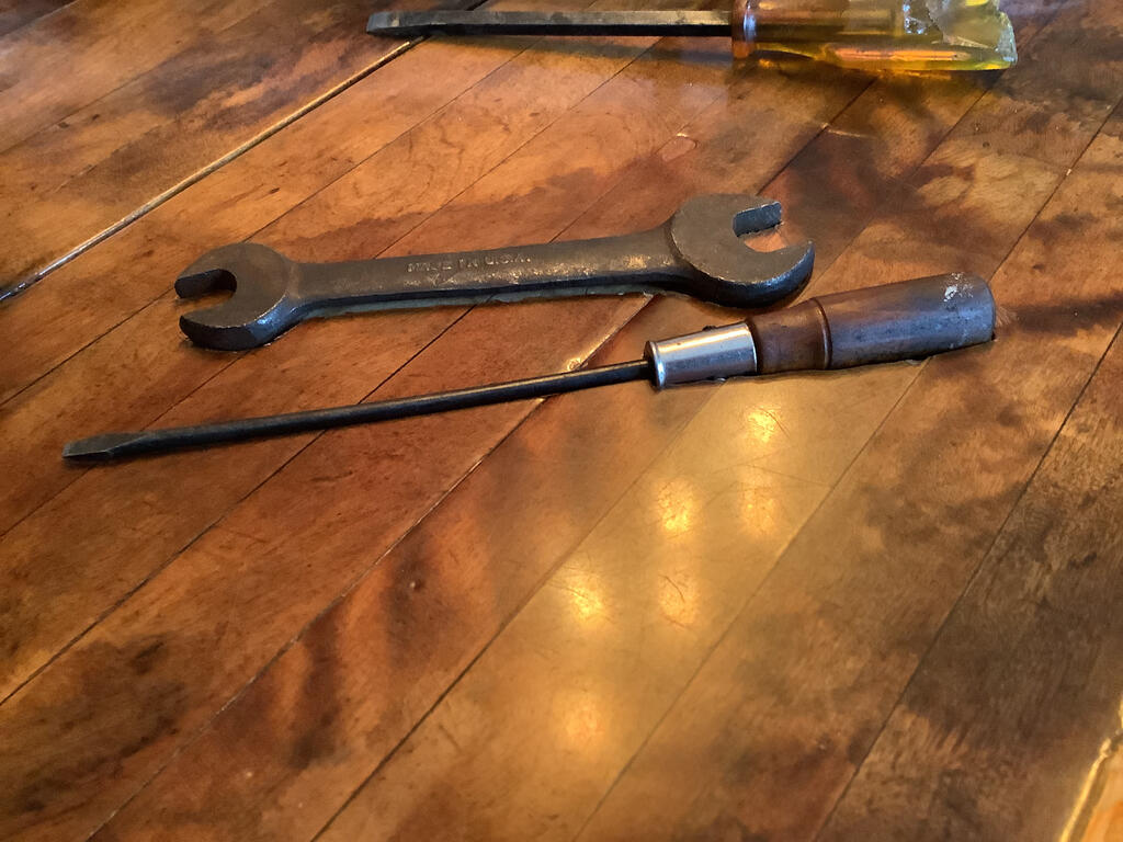

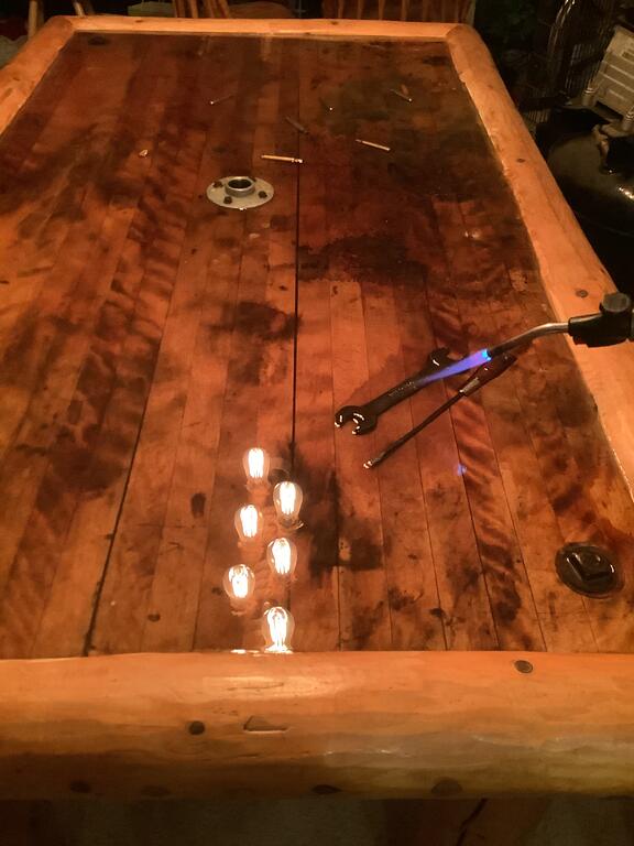

I’m planning to fill the table about 3/8” thick, over numerous pours.  The tools are about 1/4” above currently at the max.
johnnymag3
Use a Dremel tool to get those items deeper...darn near flush...then top coat. Nice job so far !!!!!

Read up heavy on the 50/50 tips & tricks before you start the pour. Once you start there ain't no going back. I remember a propane torch was my best friend for getting air bubbles out.
I'm thinking the more up they are the more "3D" they would look tho??
My plan… if it goes well, is to pour 1/8” at a time and cure well between pours.  With that plan, if needed I can always wet sand the epoxy smooth before the last pour if the screwdriver handle for example creates a ripple in the over coats.
I believe that part of Kevin's intent may be to make it look like those items were just left on table as if just used. Sinking the rounded items such as screw drivers handle  and shells past the widest part will leave big gaps around them detracting from that purpose. Minimal pours each time will allow epoxy to flow away as much as possible from inside corners maintaining the items' "projection" clearly defined rather than having a "ramp" there.

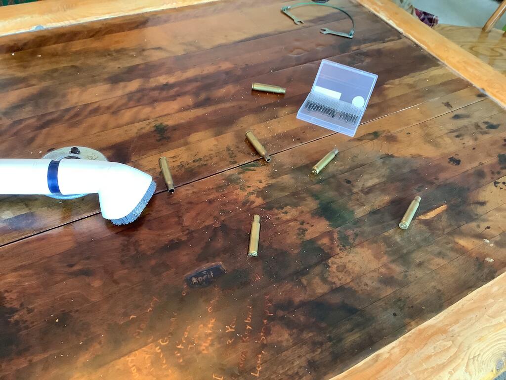

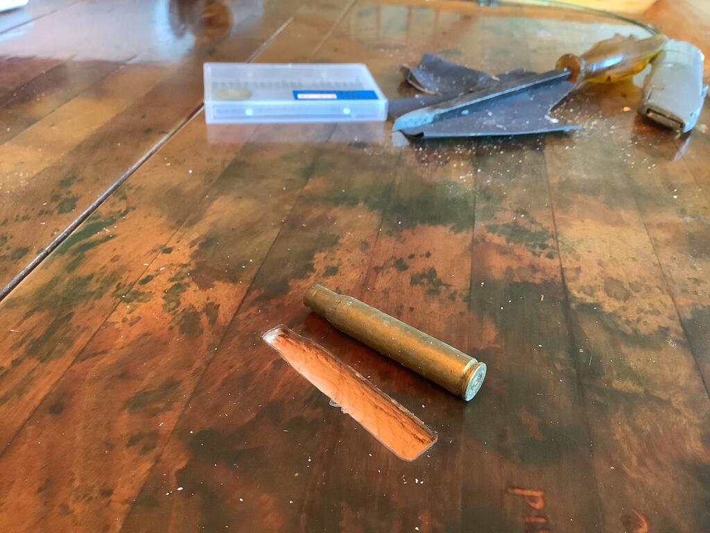

I’ve got a little time this morning…
We’ve acquired more of Grandpa’s 21 Gun Salute casings.

:twocents-02cents:            Too much of a good thing is too much.  I would stick with one shell and look for something else that tells us about your Grandpa. Perhaps a coin or two from is birth year and the year he passed. PM me with the years and I will fix you up if you like the idea. I inherited my brother's coin collection and would be honored to be a part of this project.
Edited by 953 nut

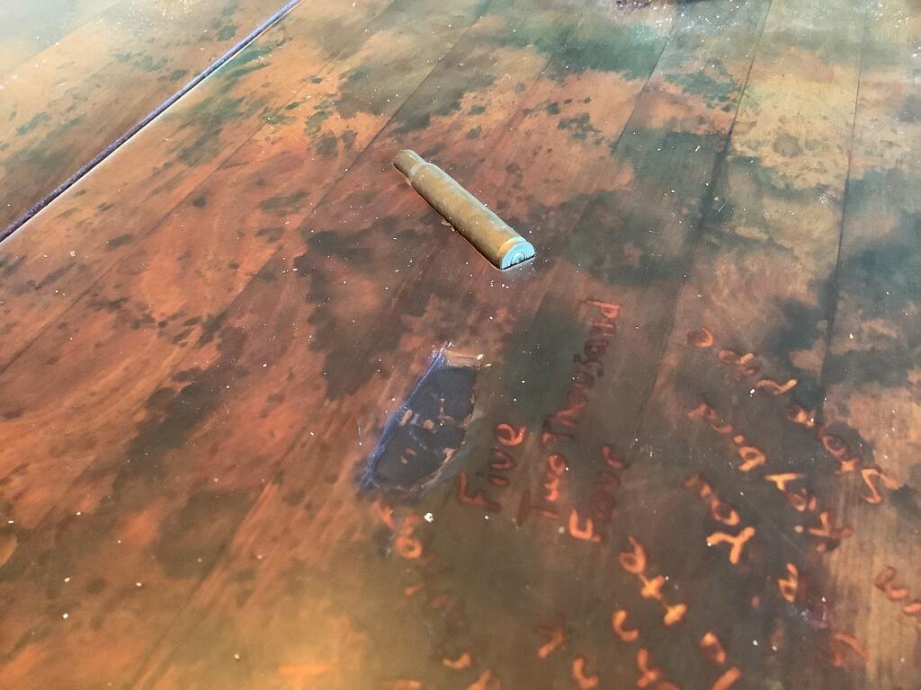

Thank you for the offer Richard!  The casings are in the table, along with the screwdriver, wrench and this button.  We have narrowed it down to four pictures.  Two of his semi truck (one with Grandma posing next to the truck), his US Army photo and one of us two.  We stopped there, because the work bench itself has the story to tell as well.  We’ve verified that the trinkets are deep enough below the finished surface and we’re doing final cleaning and will pour a layer of epoxy tonight.  :handgestures-thumbupright:

We did about a gallon pour last night.  Oh man it looks so good!  I’m glad to even have the voids from where the epoxy found it’s way through the first time filled up.  Mrs. P and I kind of both agreed after that pour… no pictures.  We’ll mix up another gallon tonight for another go-round!

Momma wants new flooring!  :ROTF:  Having done a previous coat 12 years ago, we found no leaks last night.  Just air bubbles and a torch job every 30 minutes.  :dance:

And now we’re pretty much up to date.  Second coat should be applied between 4 and 24 hours from first pour.  Tonight we’ll likely do it all over.
