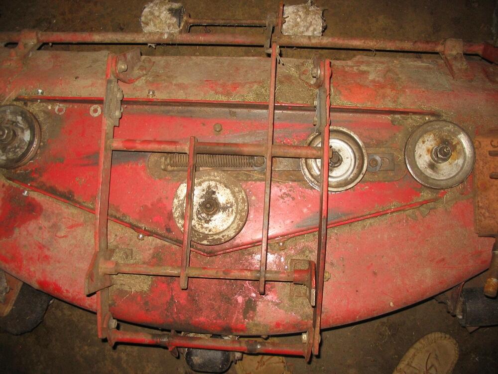

Maxwell-8 4,366 #3 Posted January 1, 2022 Is it this you mean? (not the belt shields) I got it with my c175, my other deck doesn't have it either. sorry for the bad picture. 1 Share this post Link to post Share on other sites

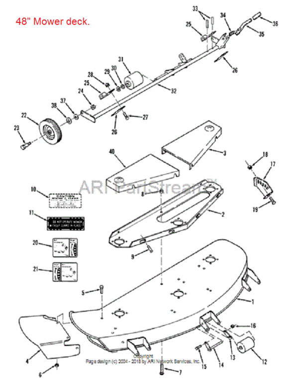

Brockport Bill 1,815 #7 Posted January 1, 2022 to various responders:::: i looked at diagram on PartsTree -- it shows model deck # 05-48ms05 with an item # 41 - part # 106117 -- its the disc plate i was referring to -- yes, it makes sense for the 42 deck because the 42 mower does not have the added 3 spindle plate frame as the 48 shell across most of the shell for reinforcement of the entire deck - however, ithe disc plate is shown in the diagram for the 48 which is why i believed i should have that disc plate to install ???????????? Share this post Link to post Share on other sites

Jeff-C175 7,203 #10 Posted January 1, 2022 (edited) 33 minutes ago, Brockport Bill said: # 05-48ms05 with an item # 41 - part # 106117 49 minutes ago, Ed Kennell said: thought the 48" decks had a large enforcment plate that covered all three spindles Mine doesn't have that plate Bill (but it's an 05-48MS01 and not a 5) If that goes UNDER item 2 I don't understand how that can work unless there is a depression in the deck shell for it to sit. Ed is referring to item #2 I believe. Edited January 1, 2022 by Jeff-C175 1 Share this post Link to post Share on other sites
Brockport Bill 1,815 #11 Posted January 1, 2022 1 minute ago, Jeff-C175 said: Mine doesn't have that plate Bill. If that goes UNDER item 2 I don't understand how that can work unless there is a depression in the deck shell for it to sit. Ed is referring to item #2 I believe. yes jeff the yellow highlite is the plate i was referencing --- although the diagram shows the disc "under the plate frame" i believe you are correct - it would be impossible to be under the larger 3 spindle frame - so i concluded it goes above the 3 spindle frame and under the pulley - of course there is a chance the diagram is incorrect -- and the disc plate is only made for the 42??? --- i 've often been confused looking at the online diagrams for the 42 and 48 because they seem to interweave the 42 and 48 diagrams Share this post Link to post Share on other sites

Jeff-C175 7,203 #13 Posted January 1, 2022 (edited) 4 minutes ago, Brockport Bill said: there is a chance the diagram is incorrect Yes, there sure is. I have noticed that partstree often mixes the 42 and the 48 up and there are significant differences! So one must be very careful! It's because they aren't looking at the 'big picture'! The WH parts lists CLEARLY show what's what and whoever loaded those diagrams clearly doesn't understand how to read them, and that the rest of the picture is essential! Note the highlighted column on the left, gives quantity and part numbers for the different widths: Edited January 1, 2022 by Jeff-C175 1 Share this post Link to post Share on other sites

Brockport Bill 1,815 #15 Posted January 2, 2022 30 minutes ago, gwest_ca said: An original illustrated parts list will contain the answers. ah ha -- thats helpful -- if i am reading parts list correctly????? clarifies the disc plate is for the 42, not 48 - but of course the diagram is VERY misleading suggesting the disc plate is on the 48 and UNDER the main 3 spindle plate - that drawing certainly didn't get scrutinized by the WH headquarters folks - should have been note in the diagram indicating the disc plate is on 42s only and the full 3 spindle plate is on 48s 1 Share this post Link to post Share on other sites

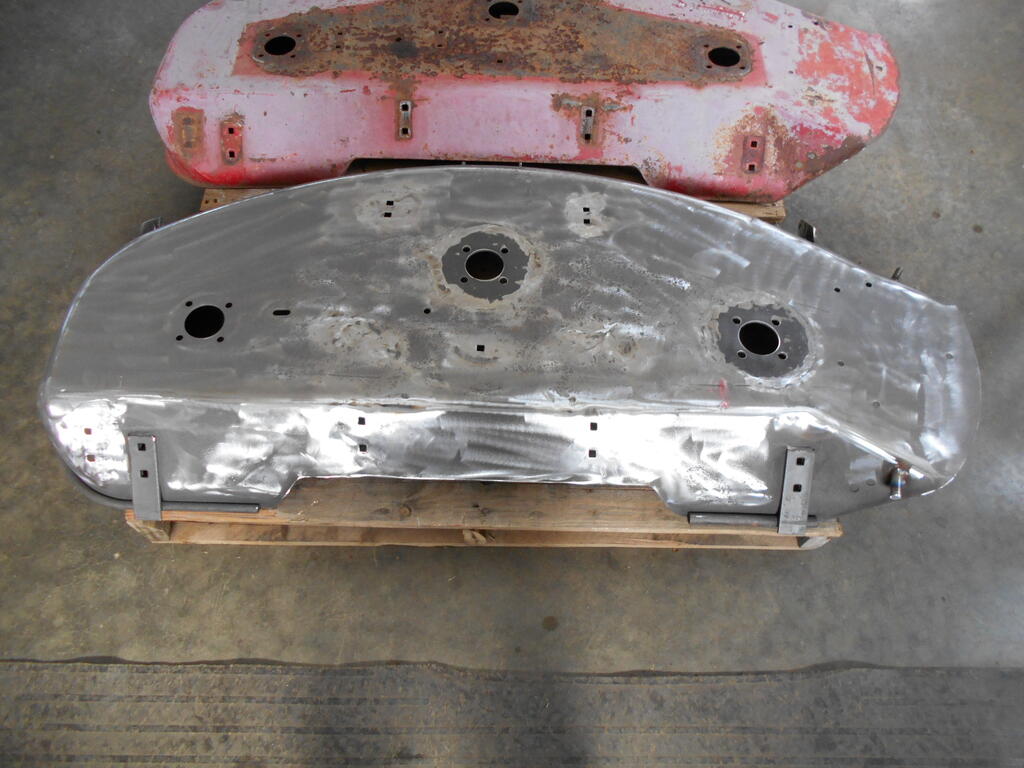

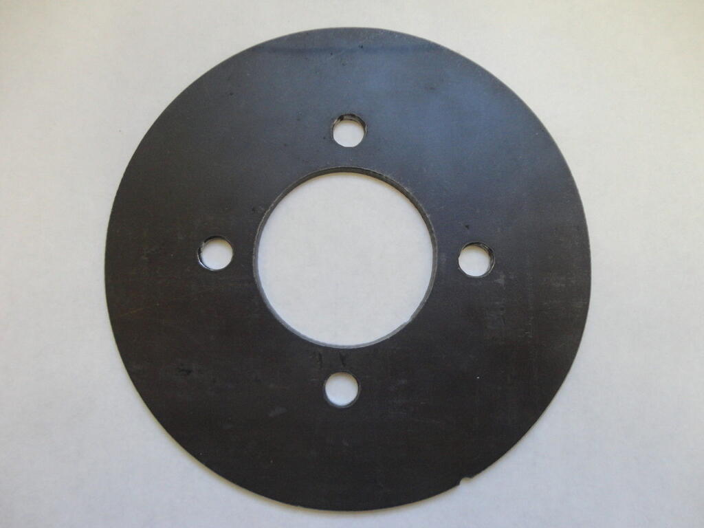

oliver2-44 10,226 #17 Posted January 2, 2022 Just to confuse things a little more, I've come across this photo titled "Welded in deck reinforcement" which I believe was available from WH. But it didn't have a part number, soit could have been aftermarket. 1 Share this post Link to post Share on other sites

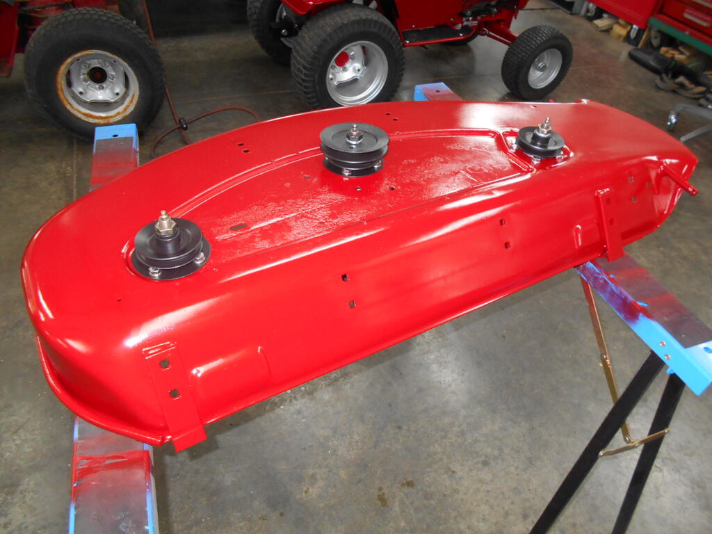

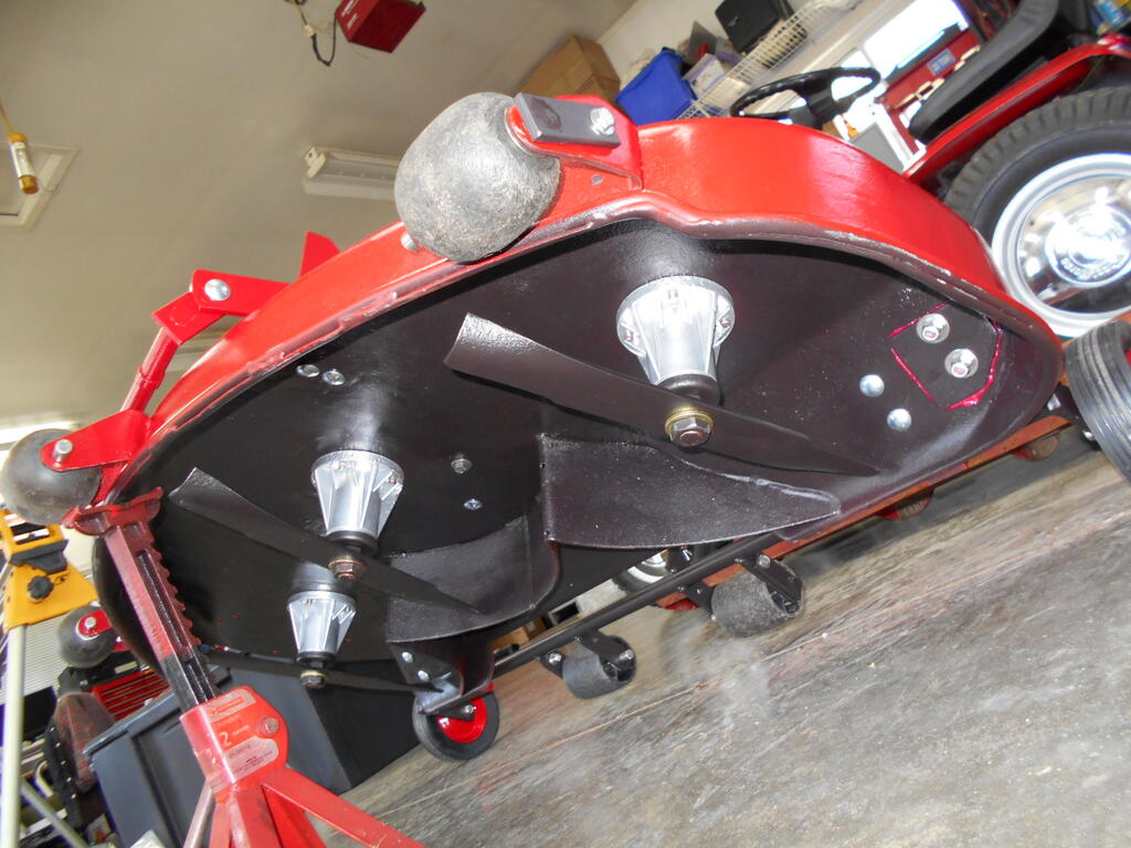

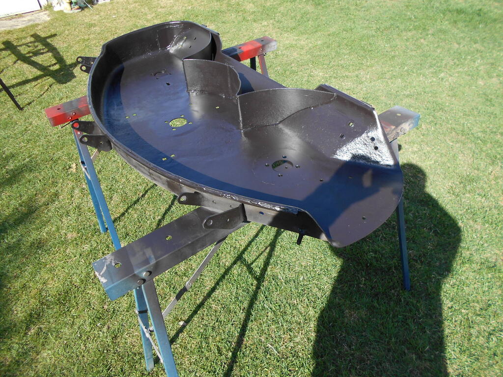

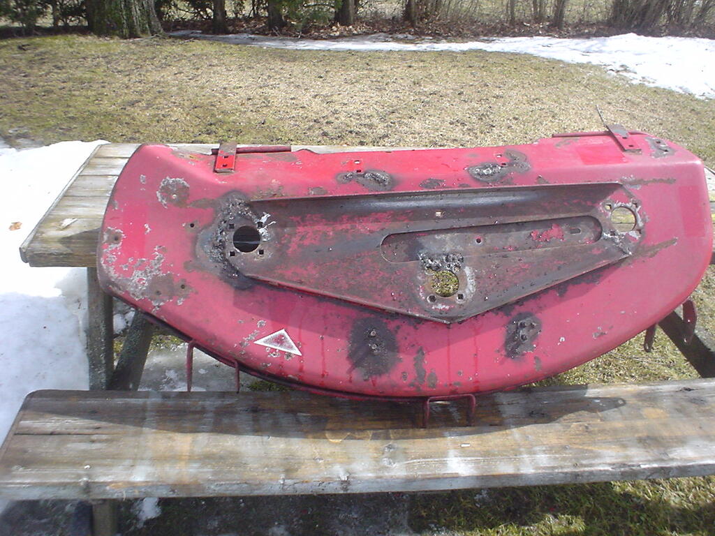

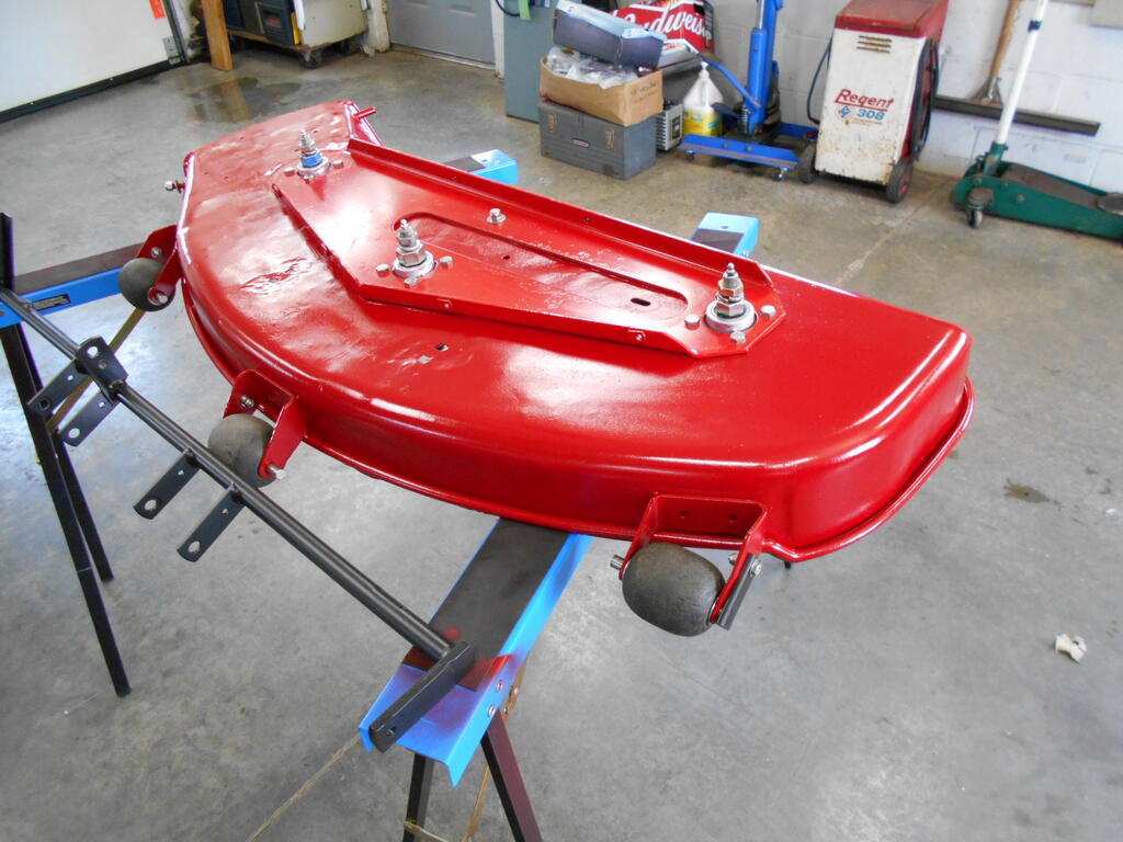

cleat 6,911 #18 Posted January 2, 2022 (edited) I believe those are aftermarket. There are 2 of them welded into this deck. I bought those round inserts online then cut out the very cracked up spindle mount areas from the deck and had these welded in. I actually bought 3 but only needed 2. Of course this is a 48 deck so it also has the big plate on top. This is the deck as received. And the deck painted then assembled. I have others but this is my main one. Works perfectly with those plates welded in. Edited January 2, 2022 by cleat 2 Share this post Link to post Share on other sites

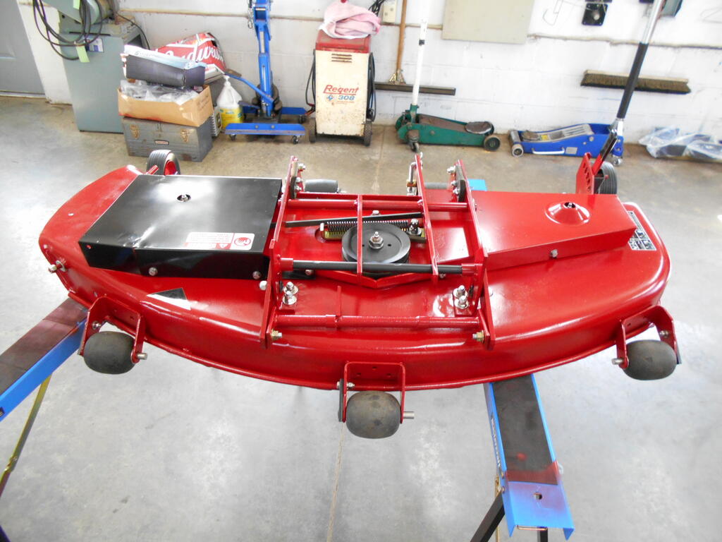

cleat 6,911 #19 Posted January 2, 2022 Sorry to get off topic, back to the OP's question. Here is a 42" deck I restored and you can see the reinforcement ring on the center spindle under the pulley on top of the deck. I also added one on the left side just because I had it here. 1 Share this post Link to post Share on other sites
Jeff-C175 7,203 #20 Posted January 2, 2022 31 minutes ago, cleat said: deck as received. Somebody sure made a mess of that one, didn't they? Share this post Link to post Share on other sites

cleat 6,911 #22 Posted January 2, 2022 That 48"deck needed lots of parts that luckily I had here including a new top plate. The 42 just needed a good cleanup and going over along with new paint. Share this post Link to post Share on other sites
