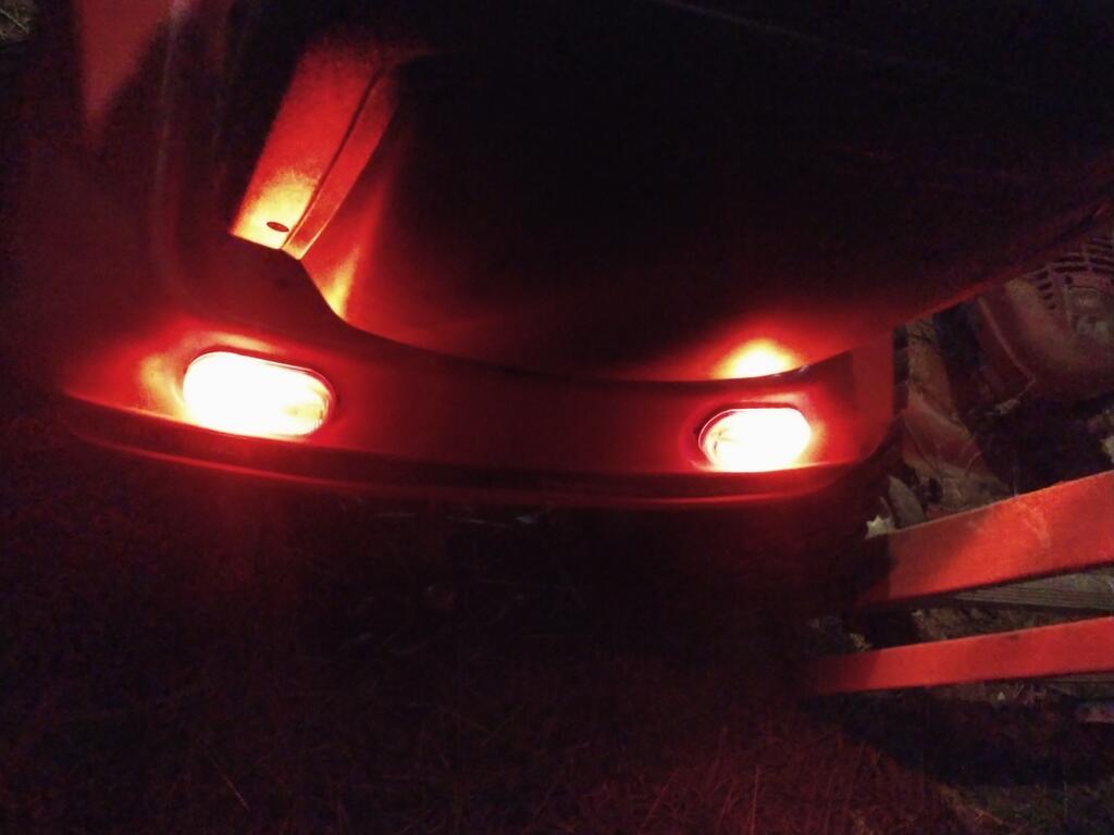

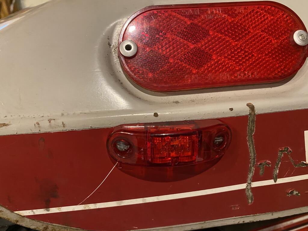

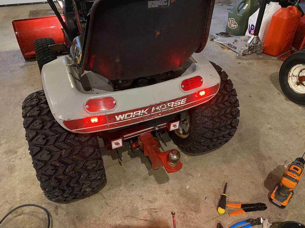

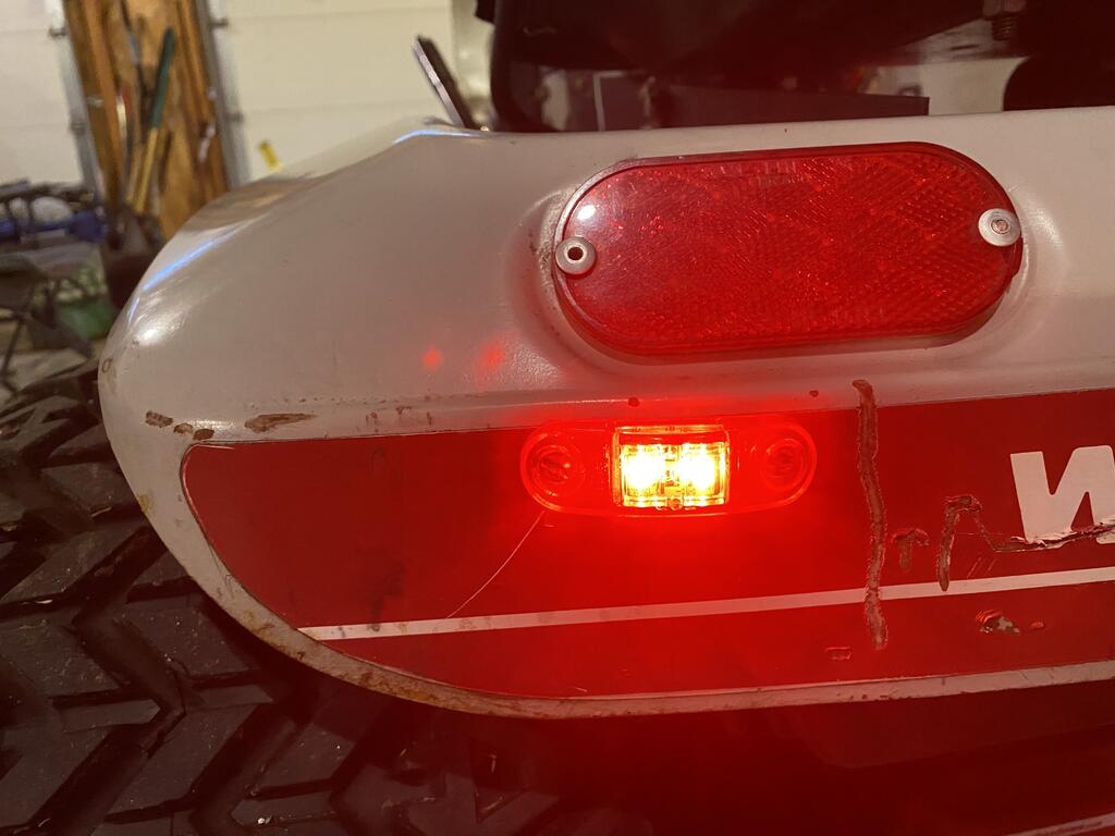

Sparky-(Admin) 21,743 #1 Posted December 31, 2021 While working on my garage cleaning task I found these LED marker lights that I probably bought 4 or 5 years ago. My plan back then was to install em on my GT1600 plow tractor…so today that’s what I did. Decided to leave the factory reflectors and mount the new lights just below. Pretty happy with the results. 11 4 1 1 Share this post Link to post Share on other sites

Sparky-(Admin) 21,743 #3 Posted December 31, 2021 14 minutes ago, stevasaurus said: Question is, "How much stuff do you intend to find (that you did not know you had) and how many more projects is this making for you"? Haha! Finding this “stuff” has really slowed the garage cleaning process. There I was cleaning and organizing the garage when something shiny caught my eye…..2 hours later I have rear tail-lights Garage still needs some attention 2 5 Share this post Link to post Share on other sites

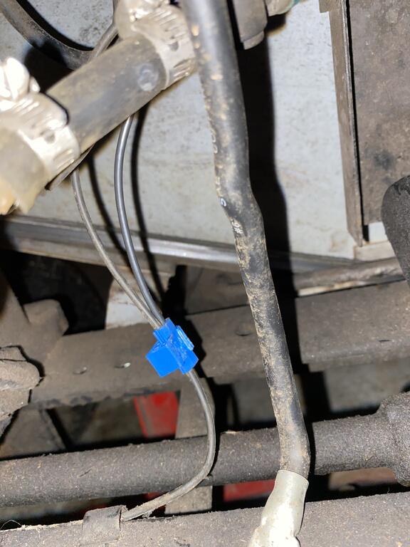

Horse Newbie 7,168 #13 Posted January 1, 2022 16 hours ago, Sparky said: 2 hours later I have rear tail-lights How did you wire those in to your existing wiring on the lights circuit ? I have a 1984 Work Horse GT-1600 that I am currently working on refreshing, and plan to change the rear reflectors to lights. Share this post Link to post Share on other sites
Sparky-(Admin) 21,743 #14 Posted January 1, 2022 32 minutes ago, Horse Newbie said: How did you wire those in to your existing wiring on the lights circuit ? I have a 1984 Work Horse GT-1600 that I am currently working on refreshing, and plan to change the rear reflectors to lights. Used one of those blue plastic “t” taps that come with trailer wiring kits to tap into the hot wire going to the headlights. The taillights themselves are grounded to the fender metal. 1 Share this post Link to post Share on other sites
Horse Newbie 7,168 #15 Posted January 1, 2022 15 minutes ago, Sparky said: Used one of those blue plastic “t” taps that come with trailer wiring kits to tap into the hot wire going to the headlights. The taillights themselves are grounded to the fender metal. I plan on using LED lights on rear fenders. Do you think the light circuit will handle the extra load without any alterations. Share this post Link to post Share on other sites

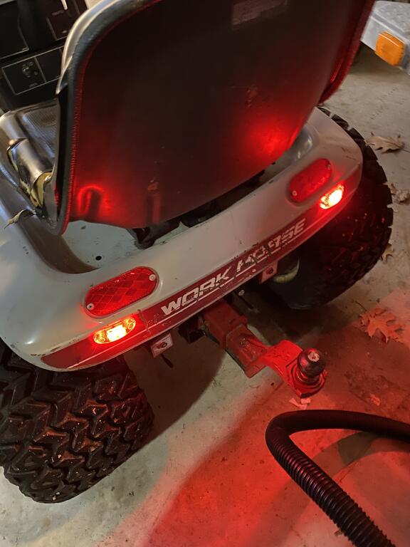

peter lena 8,970 #17 Posted January 1, 2022 @Sparky have led tail lights on y 3 horses , walmart has them , exact fit for original reflectors . emphasis should be on very reliable connections and grounding , used wire wrap to insure no chafing , very bright , pete 1 Share this post Link to post Share on other sites
Jeff-C175 7,203 #18 Posted January 1, 2022 (edited) 3 hours ago, Horse Newbie said: extra load LEDs draw almost no current. The original circuit won't even notice. Each tail light draws about 50 milliamps ( or 0.05 Amps). The backup lamp draws about 400 milliamps (or just under a half amp.). Edited January 1, 2022 by Jeff-C175 1 Share this post Link to post Share on other sites

Sparky-(Admin) 21,743 #20 Posted January 1, 2022 3 hours ago, Horse Newbie said: I plan on using LED lights on rear fenders. Do you think the light circuit will handle the extra load without any alterations. That’s the beauty of LED’s…minimal amperage draw, so definitely no problem adding to the existing circuit. In the case of my plow tractor I also swapped in LED headlights. 3 Share this post Link to post Share on other sites

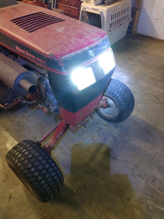

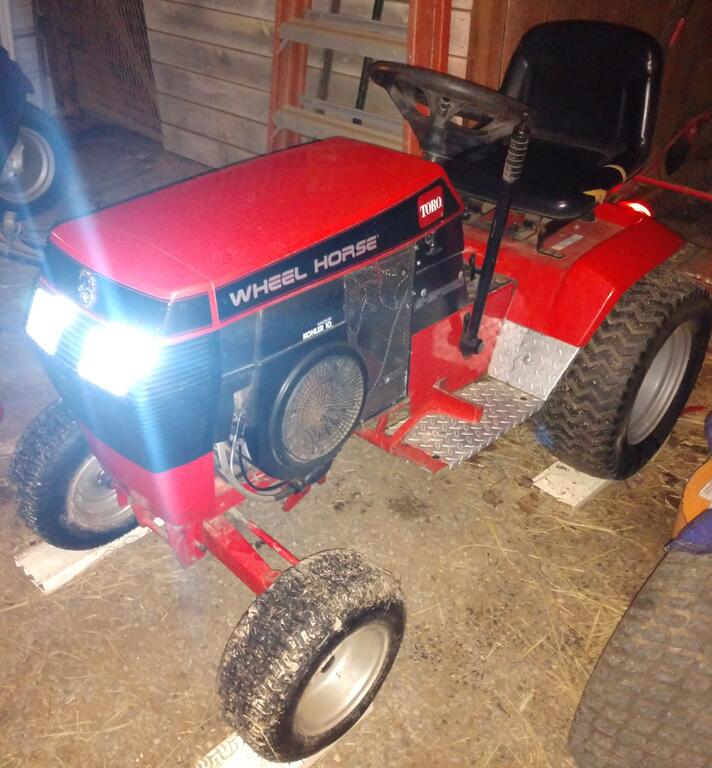

Horse Newbie 7,168 #22 Posted January 2, 2022 6 hours ago, Sparky said: also swapped in LED headlights. I am strongly considering going to LED’s on my ‘94 520H, and my ‘84 Work Horse GT-1600… the only reason I haven’t yet is I don’t really mind the old school “ orange “ headlights, and I will almost certainly never be operating them at night where I need lots of illumination. But, then again swapping over to LED would certainly save on the wear and tear and strain on the voltage regulator/ charging system… y’all think ? Share this post Link to post Share on other sites
Jeff-C175 7,203 #23 Posted January 2, 2022 4 minutes ago, Horse Newbie said: y’all think I actually don't. I don't believe that lowering the load would make it last longer. 2 Share this post Link to post Share on other sites
kpinnc 13,105 #24 Posted January 2, 2022 (edited) 33 minutes ago, Horse Newbie said: But, then again swapping over to LED would certainly save on the wear and tear and strain on the voltage regulator/ charging system… y’all think ? On both those tractors, it's simple plug and play. PAR-36 bulb style. Check Superbrightleds.com. Not cheap, but likely a one time purchase. They produce more than double the light output, and they last forever. As has been said before, they use almost no power. ...sorry, I'm a bit of a fan. I got sick and tired of finding dead bulbs with incandescent lights every flipping time I needed them. Edited January 2, 2022 by kpinnc 3 Share this post Link to post Share on other sites

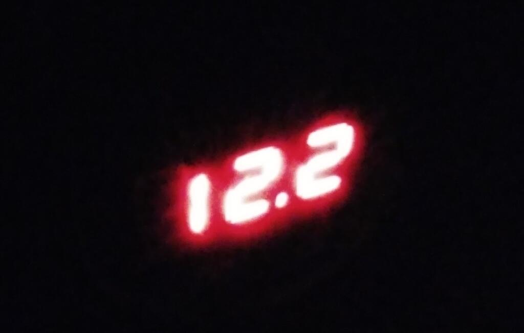

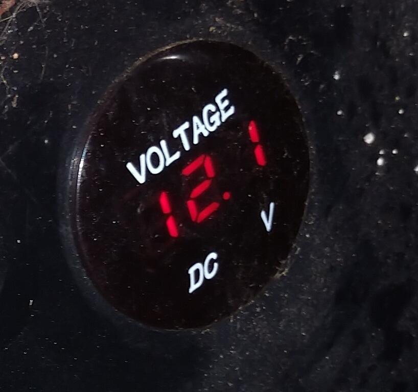

kpinnc 13,105 #25 Posted January 2, 2022 (edited) I gotta add one more comment: My 310-8 has a battery that is several years old, and is only good for a couple start attempts. The voltages below are with the tractor not running. Four LED lights drop the battery from 12.2 to 12.1 VDC, and as I said the battery is just about gone. Any other type (incandescent, halogen, whatever) of high output light would drastically load the battery or charging system. Some folks prefer incandescent for the originality factor, and I respect that. Unfortunately each of my tractors has a job, and performance is my priority. Edited January 2, 2022 by kpinnc 3 Share this post Link to post Share on other sites
