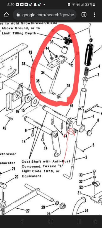

Looks like this is it.
Moparfanforever
Those are the parts you need, and the L bolt goes in the curved slot on the lift handle.
Click on the picture to see a list of models

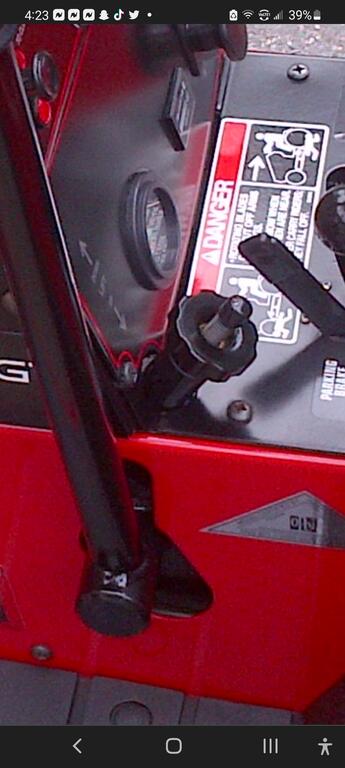

Tom, I did my '89 312 a couple of years ago bought everything except the new decals from Lincoln at A-Z tractors. Not sure what I paid but I'm sure It wasn't bad. Once you remove the dash and console plates you'll see that all the hole for mounting it are all ready there, you'll have to notch out the plates or in my case Lincoln had a set, they were cheap.
moe1965
I just added one to my 85. 312. It didnt have one either but all holes are there.I also made a bottom bracket and a trailer hitch while I'm waiting for my engine to get bored . Looking forward to using this tractor when its finished.
