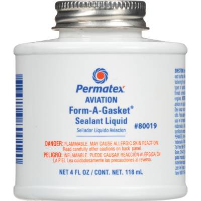

squonk 42,522 #3 Posted December 28, 2021 If I'm gluing a gasket in place Permatex High Tack Sealant. If I just want to seal an irregular surface Permatex Aviation Gasket Sealant. 1 Share this post Link to post Share on other sites
Gregor 4,847 #4 Posted December 28, 2021 21 minutes ago, squonk said: Permatex Aviation Gasket Sealant. But don't plan on reusing any gasket you put this stuff on. 1 Share this post Link to post Share on other sites

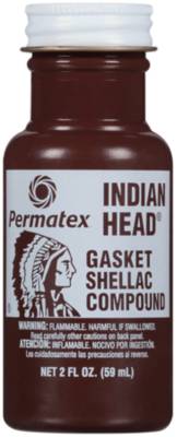

WHX?? 50,712 #14 Posted December 28, 2021 2 hours ago, stevasaurus said: .especially on a Wheel Horse transmission. T Tranny for the 701 I didn't Steve.... and it leaks.... Right on the bottom & not a great lot but it ain't coming back apart. Park it next to the Harley and let her leak. Surfaces were as clean as a whistle too and I hand filed nicks and burrs flat from the last guy that was in it. Like Squonky I do use this once in awhile. https://permatex.com/products/gasketing/gasket-sealants/permatex-high-tack-spray-a-gasket-sealant-6-oz/ Anybody use this?? Used to be the go to for old skool mechanics. https://www.amazon.com/Permatex-20539-Indian-Shellac-Compound/dp/B0008KLOG6/ref=asc_df_B0008KLOG6?tag=bingshoppinga-20&linkCode=df0&hvadid=80333120120295&hvnetw=o&hvqmt=e&hvbmt=be&hvdev=c&hvlocint=&hvlocphy=&hvtargid=pla-4583932699546844&psc=1 1 1 Share this post Link to post Share on other sites

squonk 42,522 #16 Posted December 28, 2021 55 minutes ago, WHX?? said: Tranny for the 701 I didn't Steve.... and it leaks.... Right on the bottom & not a great lot but it ain't coming back apart. Park it next to the Harley and let her leak. Surfaces were as clean as a whistle too and I hand filed nicks and burrs flat from the last guy that was in it. Like Squonky I do use this once in awhile. https://permatex.com/products/gasketing/gasket-sealants/permatex-high-tack-spray-a-gasket-sealant-6-oz/ Anybody use this?? Used to be the go to for old skool mechanics. https://www.amazon.com/Permatex-20539-Indian-Shellac-Compound/dp/B0008KLOG6/ref=asc_df_B0008KLOG6?tag=bingshoppinga-20&linkCode=df0&hvadid=80333120120295&hvnetw=o&hvqmt=e&hvbmt=be&hvdev=c&hvlocint=&hvlocphy=&hvtargid=pla-4583932699546844&psc=1 Jim the InJun shellac is very similar to the aviation sealant. Napa # 765-1229 765-1210 1 Share this post Link to post Share on other sites
