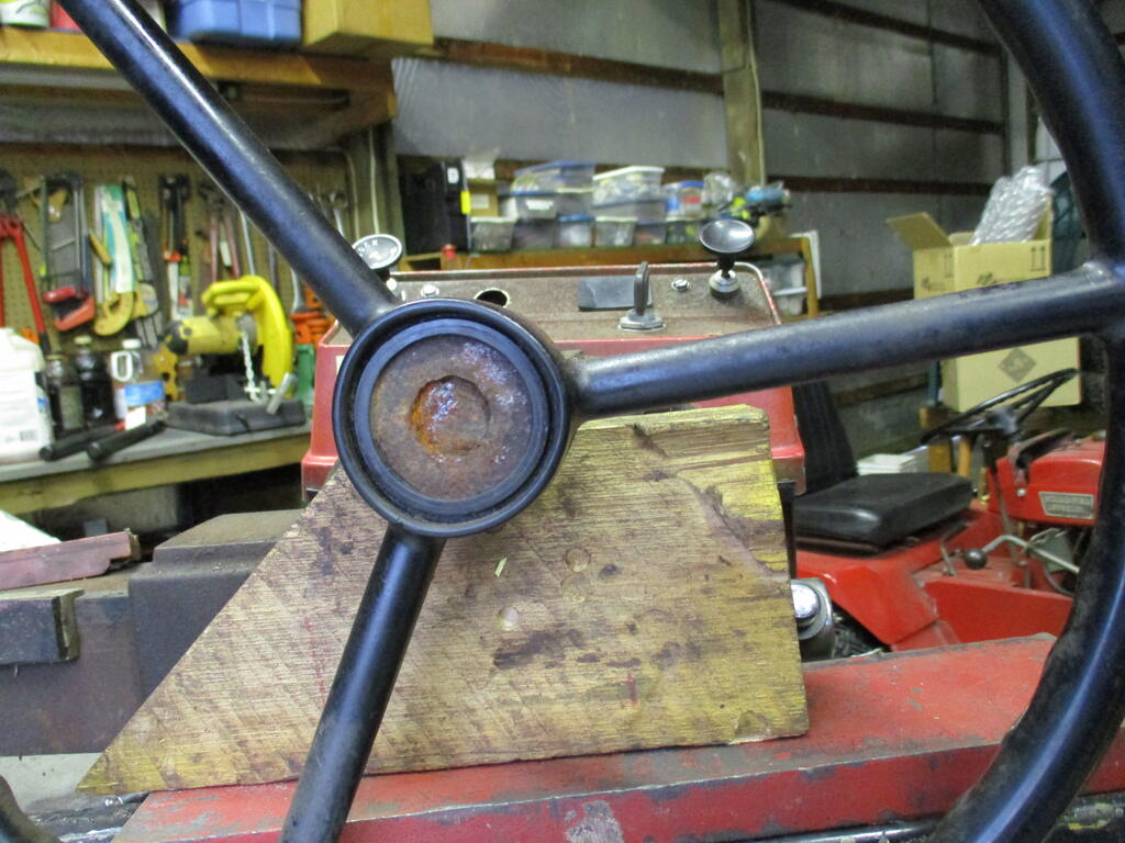

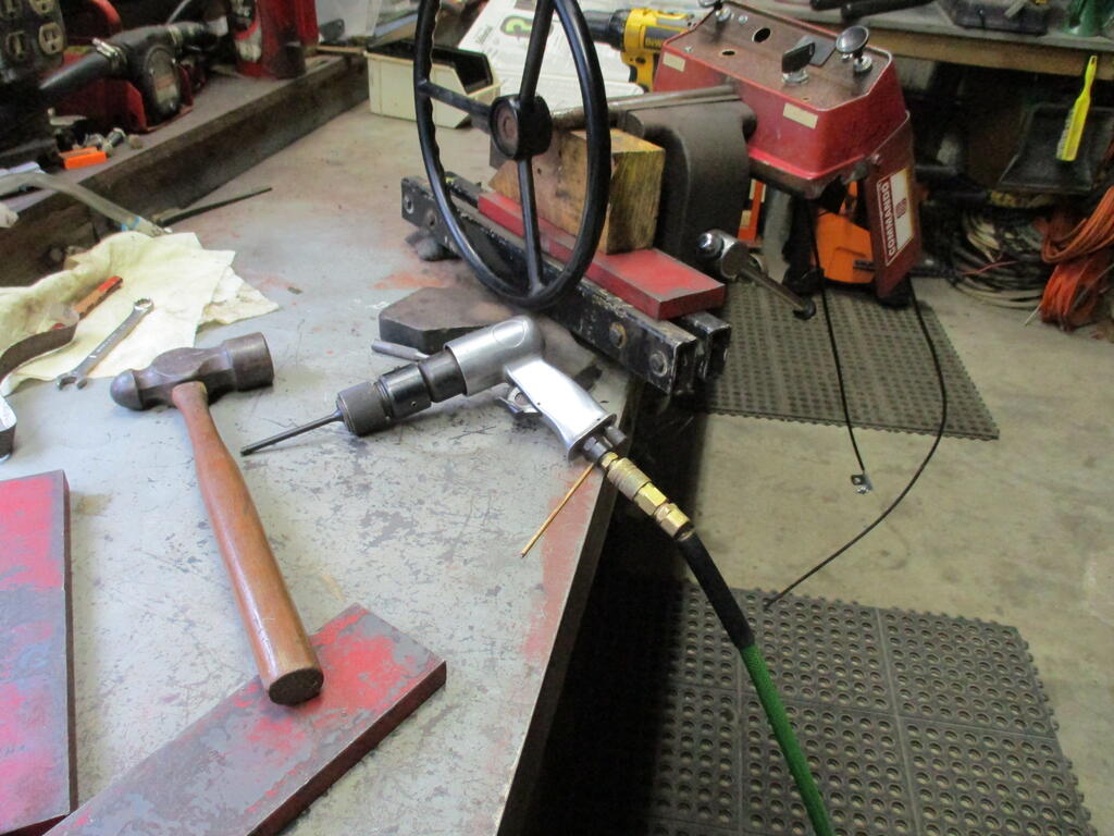

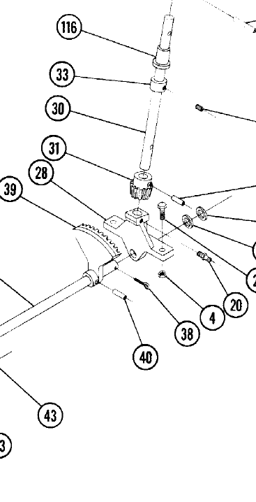

pfrederi 18,301 #1 Posted December 27, 2021 I knew this one would be tough so I pulled the whole instrument panel and steering. Put some different kinds of penetrating stuff inside it a couple times last week. Initial attempts with roll pin punch and hammer equaled nada. Bought a roll pin punch for the air chisel Tried that today figured easy game...nada.. I know it took a long time to get stuck so more soaking and waiting... 2 1 4 Share this post Link to post Share on other sites

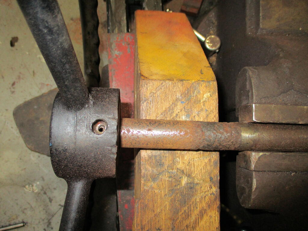

lynnmor 7,550 #5 Posted December 27, 2021 I'm not seeing any penetrating oil. That wood block will act as a bit of a cushion, try backing it up with heavy steel as close as possible to the steering wheel. 2 1 Share this post Link to post Share on other sites
pfrederi 18,301 #6 Posted December 28, 2021 2 hours ago, lynnmor said: I'm not seeing any penetrating oil. That wood block will act as a bit of a cushion, try backing it up with heavy steel as close as possible to the steering wheel. Oil ran thru. put a cue tip in the bottom and refilled it. Block is Oak. not much cushion. Will try some more steel. Share this post Link to post Share on other sites

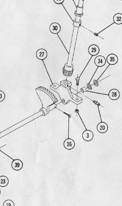

pfrederi 18,301 #11 Posted December 28, 2021 Feeling a bit stupid today. Soaked it again over night got more steel under the shaft and hit it again with air chisel roll pin punch. Nothing ..but the paper towel I had wrapped around the gear end (as it was greasy) fell off. Guess what the gear is held on by a roll pin that tapped right out... The wheel can stay on just clean up the shaft and new bearing... 5 3 1 Share this post Link to post Share on other sites
WHX?? 50,603 #12 Posted December 29, 2021 (edited) Rite of passage so says Richard... along with hubs & hitch pins. What tractor we workin on here Paul ...looks to be a Commando but wheel looks '62 '63ish? Odd that the lower gear was pinned not welded? Edited December 29, 2021 by WHX?? Share this post Link to post Share on other sites
pfrederi 18,301 #13 Posted December 29, 2021 It is a Frankenhorse i assembled for my brother a few years ago i do not remember all the sources... Share this post Link to post Share on other sites
WHX?? 50,603 #14 Posted December 29, 2021 (edited) Ahhh...well don't wreck that wheel then they are hen's teeth. 702 & 753 only. Pinned lower pinion would suggest that too. Every thing else is expendable. Edited December 29, 2021 by WHX?? 1 Share this post Link to post Share on other sites
953 nut 57,683 #15 Posted December 29, 2021 24 minutes ago, WHX?? said: Odd that the lower gear was pinned not welded? Take a look at your 1055, mine has the gear pinned to the shaft, think that was the last year that was done. 2 Share this post Link to post Share on other sites

WHX?? 50,603 #18 Posted December 29, 2021 (edited) 15 hours ago, 953 nut said: Take a look at your 1055, Will do Richard ... this 1055 build pic looks like it may have been pinned. Correct you are Dick... shows it pinned '66 shows no pin. Edited December 29, 2021 by WHX?? 1 Share this post Link to post Share on other sites

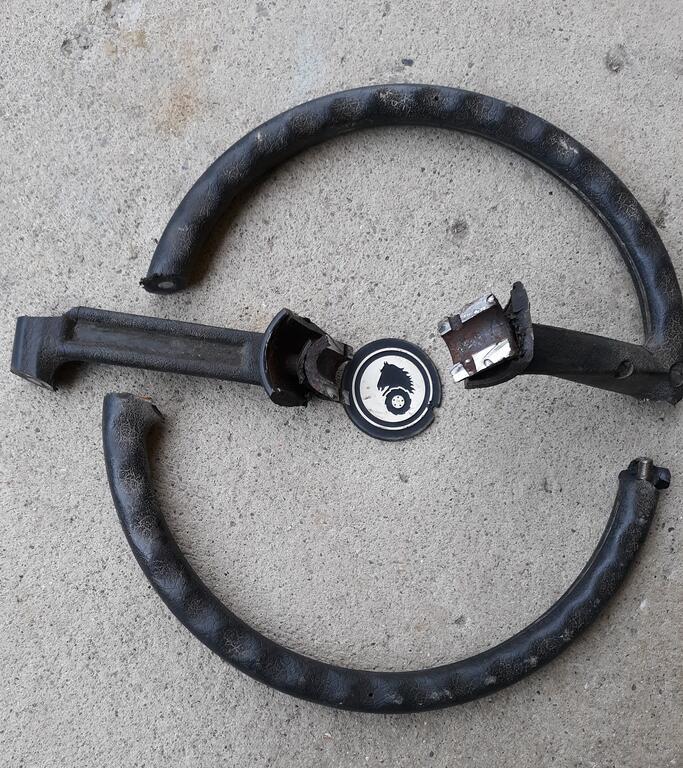

1973Auto 80 #19 Posted December 30, 2021 here is what I ended up doing 2 Share this post Link to post Share on other sites
ebinmaine 70,473 #20 Posted December 30, 2021 4 hours ago, 1973Auto said: here is what I ended up doing That's not as much of an issue on a more common wheel like 70s B/C series but for an older rare model a save is a win. 1 Share this post Link to post Share on other sites
WHX?? 50,603 #21 Posted December 30, 2021 3 hours ago, ebinmaine said: That's not as much of an issue on a more common wheel like 70s B/C series but for an older rare model a save is a win. Agreed EB the early sixties wheels now have a replacement. Achto has one on his 701. https://www.steinertractor.com/GTS002-Steering-Wheel 1 Share this post Link to post Share on other sites
