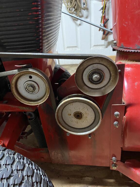

Hi Guys. Thx for all the suggestions. I verified the belt routing is correct. I also verified that the gear box moves freely.

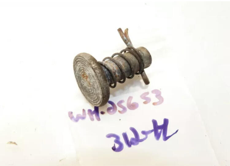

Thx. Just ordered one online….
Jeff-C175
18 minutes ago, PWL216 said:
ordered one online
That's not the actual switch though.  That may be just the plunger that pushes on the switch, is it not?
But maybe that part is missing on your machine?
If it is missing, of course the switch won't push...

I have to say that I don't know what that part is that you have pictured.
Edited by Jeff-C175

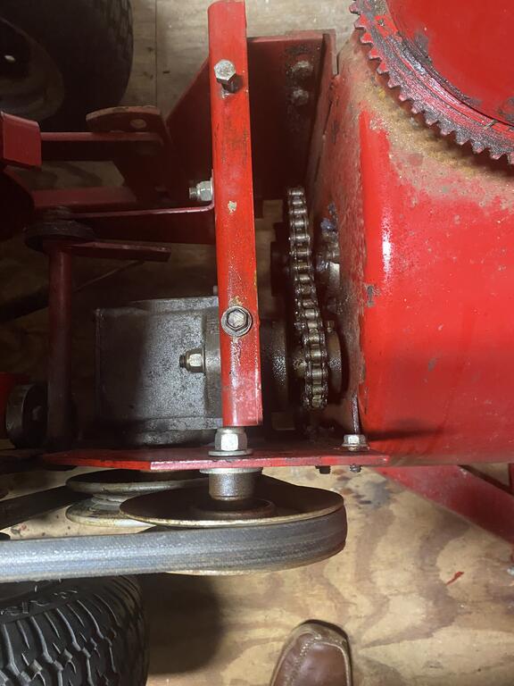

peter lena
@PWL216  noting 3 rd picture down , that chain drive slack , on belt driven pulley set up , looks like maybe a little loose , also use a gear /chain rated lubricate on that , it will stay with it and cut down on the gear wear , pete
Jeff-C175
@PWL216  I believe that this thingy:
is actually one of the seat 'bumpers' that is missing the rubber piece.
But definitely NOT the 'seat switch' in any case!
Edited by Jeff-C175

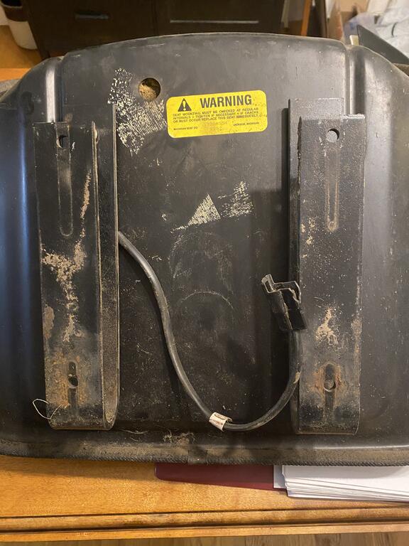

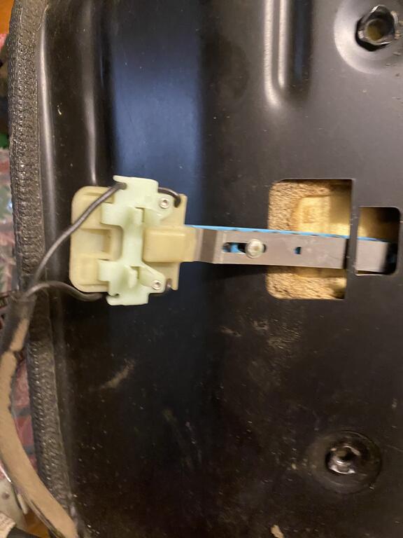

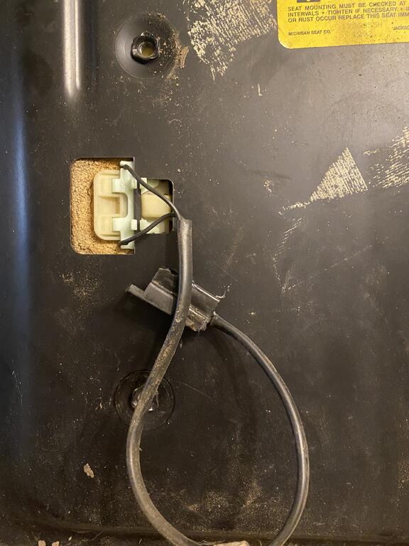

First, thank you all for your help. You are correct, what I bought was not the seat switch. After seeing the posted pics of what a seat switch looks like, it looked familiar, and so I checked the box of new parts the previous (original owner) owner had given me. Sure enough, it contained a seat switch. I replaced it tonight and will put the seat back on tomorrow and test it. I thought it was going to be a complicated exercise, but it was easy. I have attached some pics below. Thx again and I’ll let you know if this fixed it.
PWL216
It was indeed a bad seat switch. Thanks again to you all.
