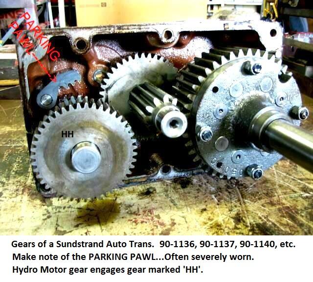

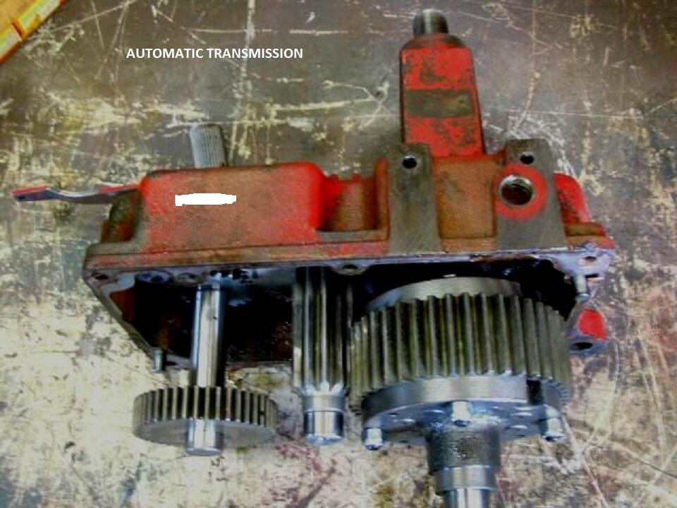

This Auto tranx has far fewer parts than a manual trans making repair and parts replacement much easier.  Here are a few pics a 'C' series Auto Tranx and gear setup.  The 'D' series is nearly exactly the same.
ps...I did not find a Youtube video for the Auto Trans repair.

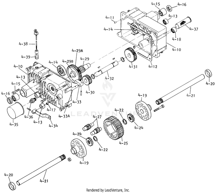

Yes.. there is a trans gasket part # 5999 (item 12 in schematic) widely available.  There wouldn't be any 'surprises' when you open this for surgery.  After you remove the 5 or 6 bolts holding it together, I suggest you invert it to avoid parts 'dropping' out.  That is, position the tranx with the LEFT side UP...(Hyd Motor side).
The filter SCREEN is also in the schematic as # 37... CAUTION...this screen MAY drop out when your remove the Hyd Motor.

The axle seal (#16 in schematic) is OEM part # 6449. It is shown as available from this source for about $16 each (x2).  I often use this website for OEM parts...cheapest I've found.  'Pats' also has the 'reverse look-up' feature.     https://www.psep1.biz/arinet.asp?aribrand=TO#/Toro_Consumer/1-0601%2c_18_hp_AutomaticTractor%2c_1973/Transaxle-Component_Parts/329512fe-c981-4f00-9605-21c4bf7a218e/d9083e49-da20-4662-a7ad-0d803fd06ff8

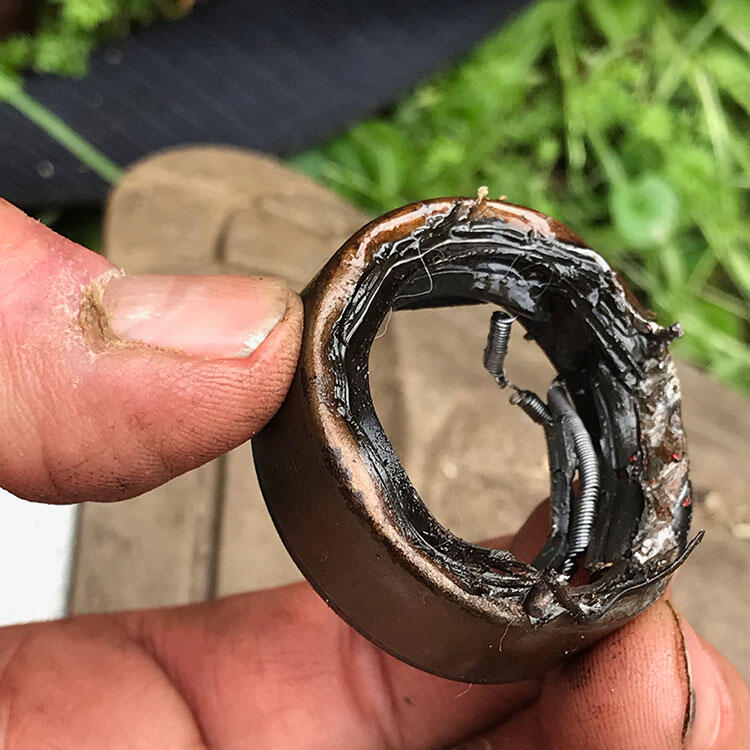

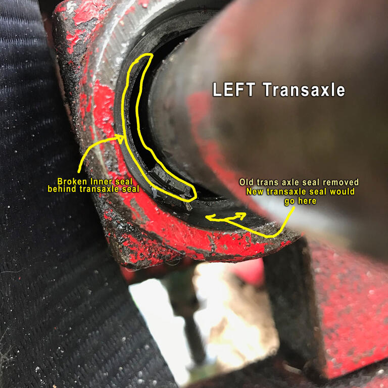

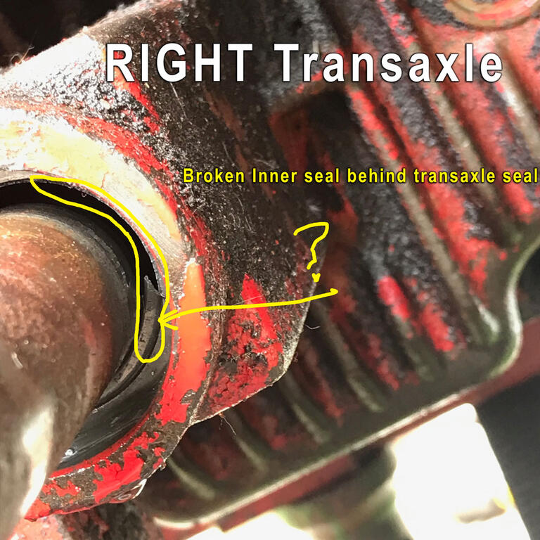

So I managed to pull off both old transaxle seals, with my shinny new seals ready to be popped back in, so I could hopefully put her back together.
Instead I discovered behind both transaxles a thin sleeve with a broken rim, (it appears) against which the new seals would rest against.
So I have played out my hand to the end of the easy solution.
Can you confirm what I am looking at in these photos?   Obviously I will now proceed to drop the transaxle to open it up.
If I can rebuild this transaxle with the generous guidance of your knowledge, I think it will be easier than to drop the whole Ark 550 FEL cage and transfer it to my spare tractor, which is a last resort.

Jeff-C175
Are you sure those aren't pieces of the old seal that broke off and went further in, hiding from your poking metal tools?
Handy Don
:text-yeahthat:
Can you see beyond to confirm that the carriers for the axle needle bearing is intact?
Is there still no lateral or vertical movement of the axle that would indicate worn or broken axle bearing?
If yes, then I do think you are looking at debris from an earlier seal that you can carefully pull out and examine.
