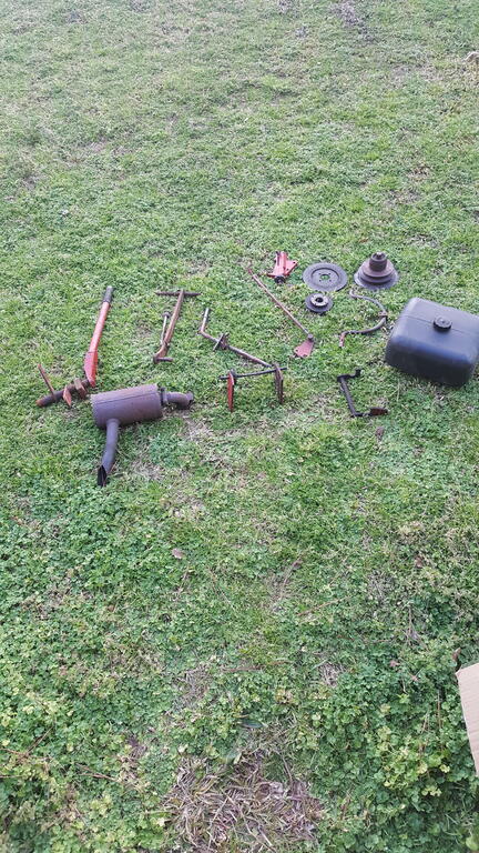

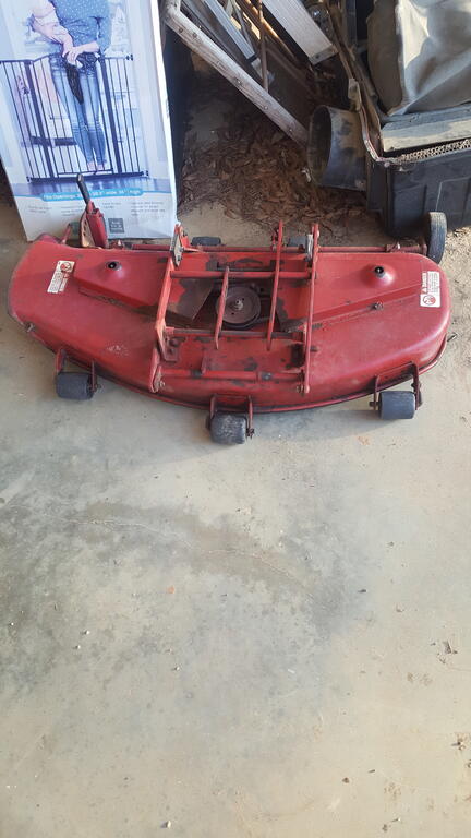

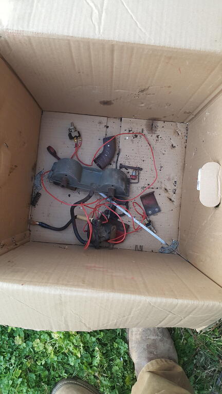

Southern_Secret 464 #33 Posted January 25, 2022 (edited) Sorry all for not posting pic's of the blade my buddy gave me, me and my better half have been down with the VID. While in the middle of that happening, scrolling on FB market place I seen a add very very very close to me. The add said he had a 42" wheel horse SD deck $100, I tell him i'm interested can i come look and he said that was fine. I go to his house to look at it and i see that i was off a C-120 and i told him that it wouldn't work on my 1994 314-H and thanked him for letting me look, but as i was about to leave he stop me and said he thought he could make me a deal to come in his shop and look. I go and look and he says for a $100 you can have everything including the deck.....wait....what?? The "everything" he was talking about was the deck, mule drive, all the links that come off the C-120 to hook the deck up, the lift handle and the Kohler that he pulled off of it......um here is the $100 can i back up to this door here? Long story short i fell like i got a deal, my plan is to use the deck links if i can for my mid-mount blade and im going to mod the deck so it will fit my 1994 314-H and what i dont use i will donate to anyone on here that needs it! I will be posting pic's soon, sorry for the long on and off topic post. Edited January 25, 2022 by Southern_Secret 1 Share this post Link to post Share on other sites

Southern_Secret 464 #35 Posted January 25, 2022 @WHX?? Now that you say that, for all you gurus on here, is it possible on the C-120 deck "attachment rod?" to move the slide stops from the inside to the outside like on my 314-H so it will hook up? Share this post Link to post Share on other sites
Southern_Secret 464 #36 Posted March 10, 2022 Well everyone I know it has been a few weeks from when I said I would get some pics for y'all, and I still dont have one of the blade I got. First we got the c-vid and both got over that pretty well, and then my better half who has alot of other medical conditions started filling bad about 2 weeks ago. She felt bad but not bad enough to worry her to much, and then last Wednesday she seem to be goind down hill, friday she was admitted to the hospital for pneumonia and bowl obstruction. As the days went on she got worst and the hospital let her go anyways, so the ambulance had to come get her and take her back Tuesday afternoon cause she had gotten pneumonia delirium and was in a different world, it was very scary not know what was going on and they transferred her to st. Vincent in Birmingham and she getting better............ all that so say I got my laptop and thought what better time to get on the fourm and slap some pics up! The stuff in the pics i got for $100 including a K341, the stuff is off a c120 and im thinking I can use some of the stuff for my mid-mount blade? Share this post Link to post Share on other sites
WHX?? 50,778 #37 Posted March 11, 2022 24 minutes ago, Southern_Secret said: bowl obstruction. For God's sake then Secret take her bowling! Laughter the best medicine! Hope she's on the mend and . Nice little haul there for the buck and the 341 icing. 1 Share this post Link to post Share on other sites
