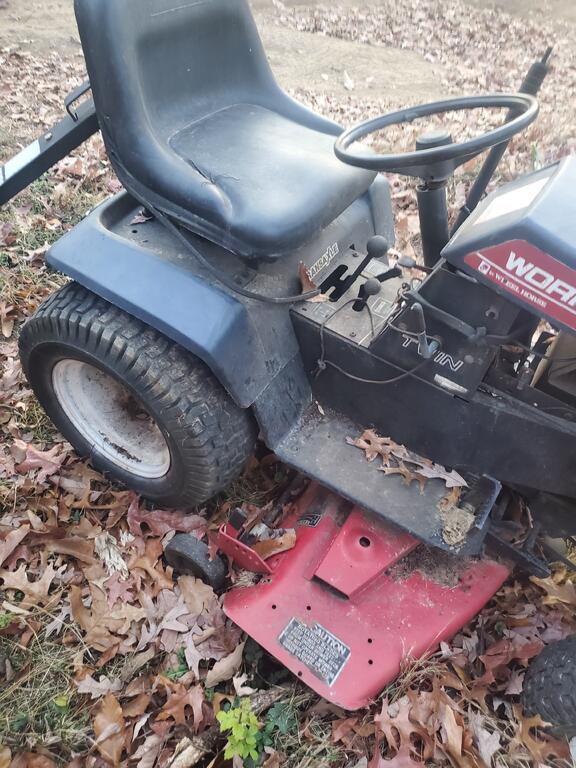

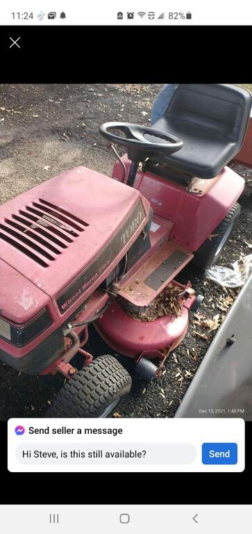

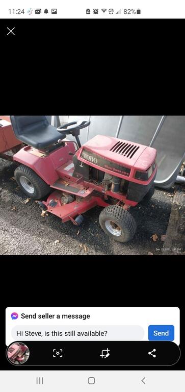

Hi guys, New member here and also new to Wheel horse tractors. I've recently inquired a Workhorse GT-42 from my dad along with a 36" single stage snow thrower. Long story short... I found out the blower was meant for a vertical shaft mower. I found a good running 210-5 riding tractor (much smaller than I prefer) but nonetheless I purchased, removed the deck and got the thrower hooked right up and runs great. The issue im having is the 210-5 had the deck lever mounted to the deck itself. Im looking trying to find a longer deck lever that mounts to the foot rest (so I have a way to raise and lower the blower) looks as if it was made to possibly have one installed as their are two pre drilled holes their. Anyone have a part number or know of any other 200 series that would work on my 210-5? Will attach pics of both tractors and more pics with snow blower attached once I get home! Thanks so much.

The 210 didn't have a regular lever with just the deck. It was a separate piece that bolted to the floor board. Came with the snowplow.
