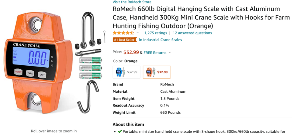

I wanted to see how much weight was on the front tires of Casper. Snow blowers, winch and all and all. 398 #  A 656 only weighs 388# total, as per tractor data. I finding that a little hard to believe. :confusion-shrug:
Jeff-C175
1 minute ago, Gregor said:
398 #
Howdja maysure it Greg?  Last time I borrowed the treasurers bathroom scale I broke it... accidentally dropped the plow blade on it!
Gregor
My HF electric winch is only rated at 400# .  Had to coax it just a little. FYI  A 2 stage 8 HP, self propelled. walk behind weighs in at 140. That's less than I thought.
