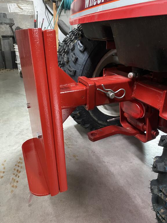

BeninCT 451 #1 Posted December 21, 2021 Just using what I had I made this little plate hanger to go in my 2” receiver hitch. It weighs like 75 lbs now but I have a couple more plates I could add. didnt want to add any length to the back of the tractor and it will be a strong number if I back into anything. Those 2 plates are 10x12x 3/4 steel leftovers from flitch plates on my jobs. I could prob hang a suitcase weight off it if I came across some of them too. Also considered making a basket for a couple solid concrete blocks too because it could just bolt on but going to try this for now. Fun little project and should get some more weeight on the back tires for plowing. Want to add another plate and a 2nd set or larger set of wheel weights. 10 Share this post Link to post Share on other sites

slim67 2,822 #3 Posted December 21, 2021 Good idea. I may be trying to figure something out on my 1054 since I have no wheel weights for it. 2 Share this post Link to post Share on other sites
Pullstart 68,521 #4 Posted December 21, 2021 Good job! I like the shelf on the bottom for more stackability! 3 Share this post Link to post Share on other sites
SylvanLakeWH 29,813 #5 Posted December 21, 2021 Nice, clean and one heck of a bumper!!! 3 Share this post Link to post Share on other sites

BeninCT 451 #10 Posted December 22, 2021 On 12/21/2021 at 6:02 PM, slim67 said: Good idea. I may be trying to figure something out on my 1054 since I have no wheel weights for it. Was going to do something simpler like a rod for some old weigh lifting plates…. Next going to make steel or concrete wheel weights not sure. Been trolling eBay for steel round plates and found some 1” x 6” dia circles that were not too bad. Could weld them on my current set to add weight or drill them to make a set. Need more time to analyze but thanks! Share this post Link to post Share on other sites
BeninCT 451 #11 Posted December 22, 2021 23 hours ago, SylvanLakeWH said: Nice, clean and one heck of a bumper!!! Yes it will take a hit for sure. Tires would be better for whatever I hit I think tho Share this post Link to post Share on other sites

c-series don 10,777 #18 Posted December 24, 2021 Drill a hole in the bottom plate and you have a trailer hitch again without removing the weights! 3 Share this post Link to post Share on other sites
