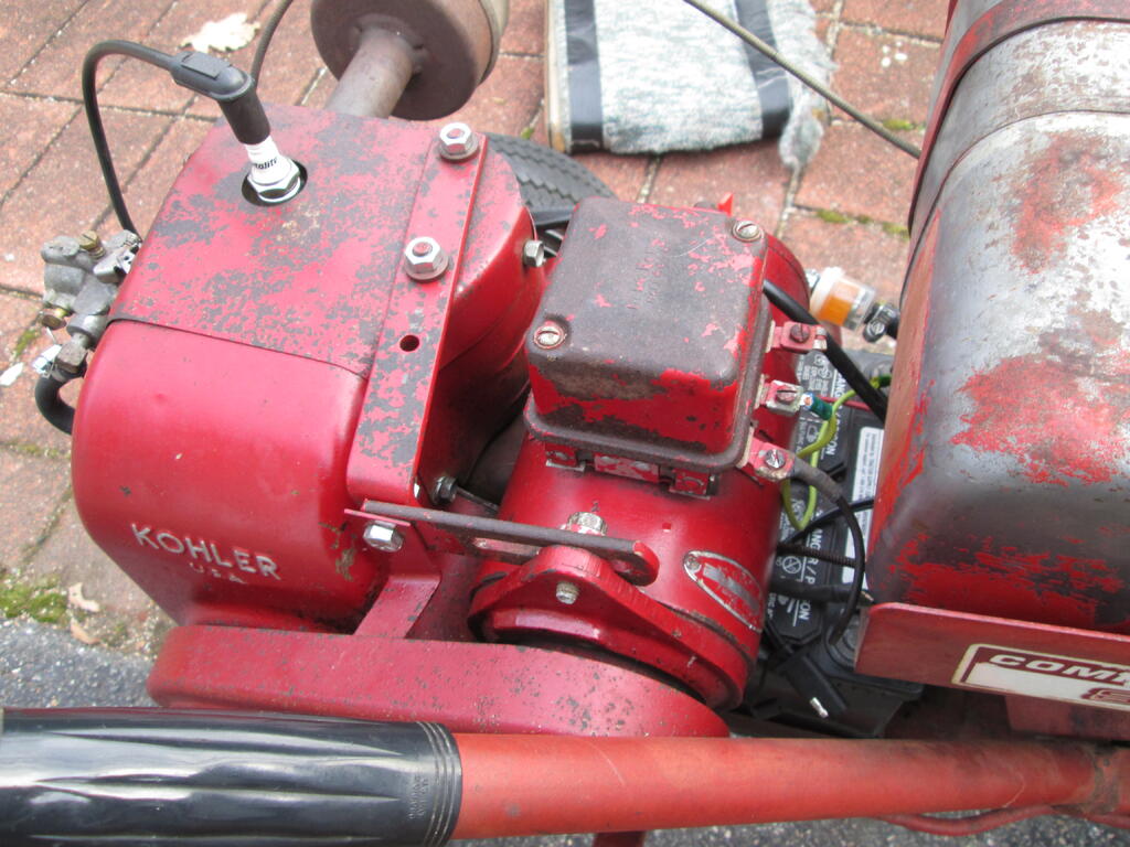

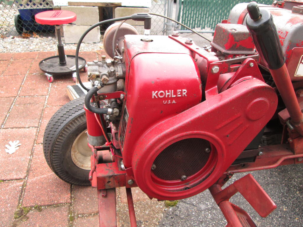

Retired Wrencher 5,651 #1 Posted December 21, 2021 Getting there with the Commando 8. Going thru it from front to the back. I finally got it running. Waiting for the new carb to come in It has the original on it now. Thanks for looking. 9 4 Share this post Link to post Share on other sites
stevasaurus 23,086 #2 Posted December 21, 2021 I think it is the buyers of these products that got there money's worth...times ten. 11 1 Share this post Link to post Share on other sites
Mike'sHorseBarn 3,146 #3 Posted December 21, 2021 Looks good! What wrong with original carb? 3 Share this post Link to post Share on other sites

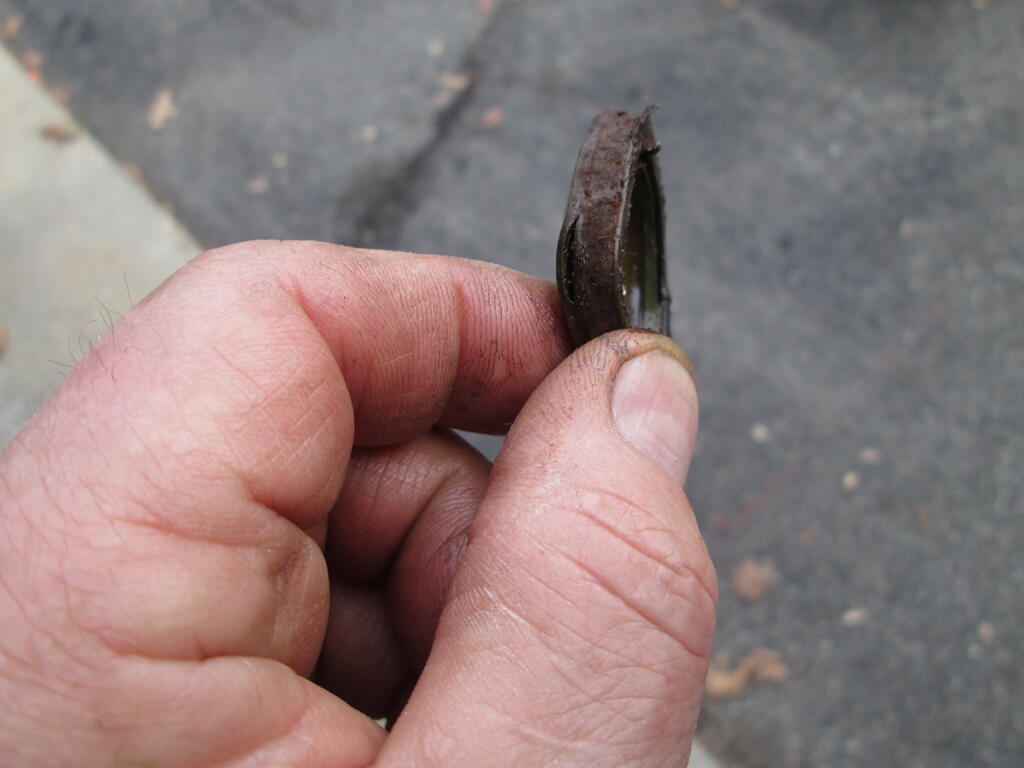

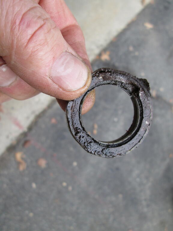

pacer 3,176 #4 Posted December 21, 2021 (edited) Whew! I sure hope your engines insides dont look like that gunk caked on the seal!! OK, I just realised that thats the outside of the seal.......sorry Edited December 21, 2021 by pacer 1 1 Share this post Link to post Share on other sites
squonk 42,592 #5 Posted December 21, 2021 1 hour ago, Mike'sHorseBarn said: Looks good! What wrong with original carb? Yes. I haven't had any luck with new carbs. Fix the old one. 4 1 Share this post Link to post Share on other sites
Retired Wrencher 5,651 #6 Posted December 21, 2021 (edited) 1 hour ago, stevasaurus said: I think it is the buyers of these products that got there money's worth...times ten. Agreed Steve. 1968 53 years I would say yes. Edited December 21, 2021 by Retierd Wrencher 2 Share this post Link to post Share on other sites
Retired Wrencher 5,651 #7 Posted December 21, 2021 11 minutes ago, squonk said: Yes. I haven't had any luck with new carbs. Fix the old one. I have for I what I am using it for Mike a show putter. 3 Share this post Link to post Share on other sites
Retired Wrencher 5,651 #8 Posted December 21, 2021 1 hour ago, Mike'sHorseBarn said: Looks good! What wrong with original carb? Very tired. Bushing and everything else. But I will keep it for the next owner. 1 Share this post Link to post Share on other sites
Retired Wrencher 5,651 #9 Posted December 21, 2021 1 hour ago, pacer said: Whew! I sure hope your engines insides dont look like that gunk caked on the seal!! OK, I just realised that thats the outside of the seal.......sorry So far so good. 1 Share this post Link to post Share on other sites

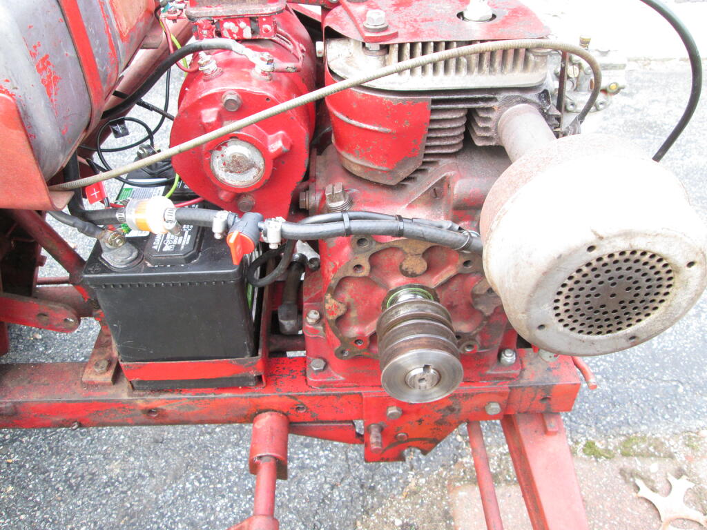

WHX?? 50,783 #18 Posted December 22, 2021 (edited) 13 hours ago, ebinmaine said: If you want to send that carb up to me I'll take a stab at it. Next time tho swap the filter and the gas cock around so you can change the fuel filter easer. Guessing the cock on the tank was fubar. Edited December 22, 2021 by WHX?? 1 Share this post Link to post Share on other sites

Retired Wrencher 5,651 #22 Posted December 23, 2021 22 hours ago, WHX?? said: Next time tho swap the filter and the gas cock around so you can change the fuel filter easer. Guessing the cock on the tank was fubar. WHX. Far as I know you cannot get the original shut off anymore. I did look around. I had an aftermarket on on there could not stop from it leaking. Thanks for the reply. Share this post Link to post Share on other sites
