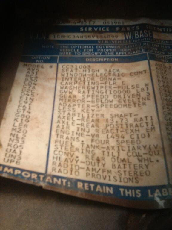

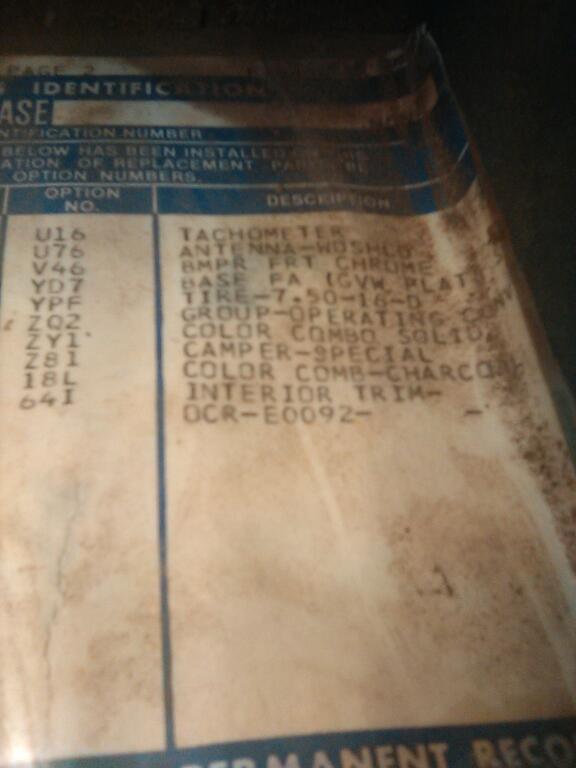

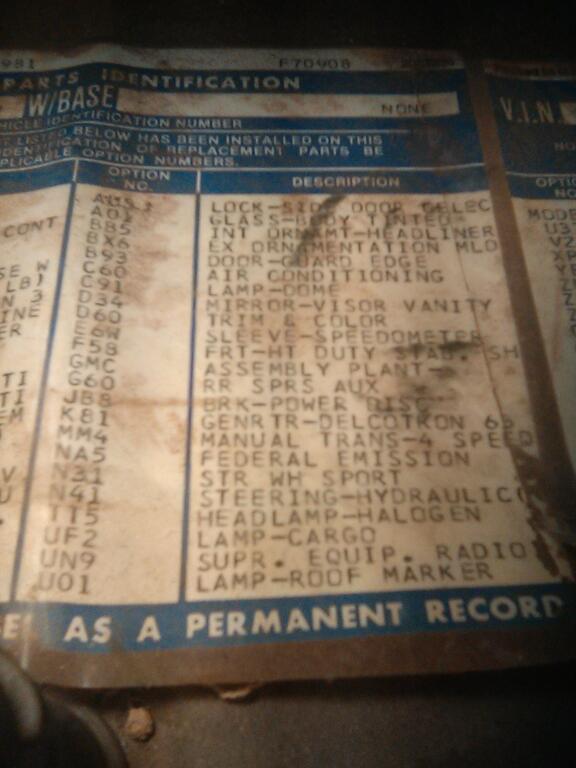

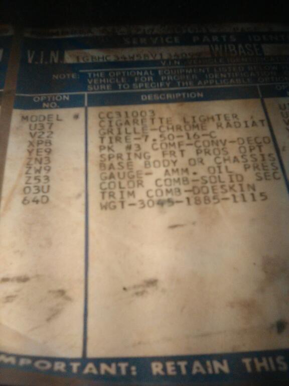

ClassicTractorProfessor 5,366 #2 Posted December 21, 2021 Here are all the RPO codes from inside the glove compartment if that helps any. I'm leaning towards probably the HD but want to be sure. Share this post Link to post Share on other sites
Pullstart 63,609 #3 Posted December 21, 2021 Camper special alone is telling me HD. 1 Share this post Link to post Share on other sites

Darb1964 1,086 #6 Posted December 21, 2021 After looking at the window sticker closer I think the guy from the other group may be right. Looks like a comfort package, that's why coils. Better ride but lighter. Share this post Link to post Share on other sites

cschannuth 3,817 #10 Posted December 21, 2021 Depending on the return policy you might be able to order both types and then send back what you don’t need. As a sidenote, that thing was really optioned up for a 1 ton dually work truck back in the day. Pretty cool stuff. 1 Share this post Link to post Share on other sites
Pullstart 63,609 #11 Posted December 21, 2021 1 hour ago, squonk said: front sway bar diameter. 1 1/4" is HD and 1 1/8" is LD his RPO codes listed a HD bar too. Share this post Link to post Share on other sites
squonk 41,967 #12 Posted December 21, 2021 WGT is the weight rating Basically a ton and a half. Frt axle 1885 rear axle 1115 lbs. Share this post Link to post Share on other sites
