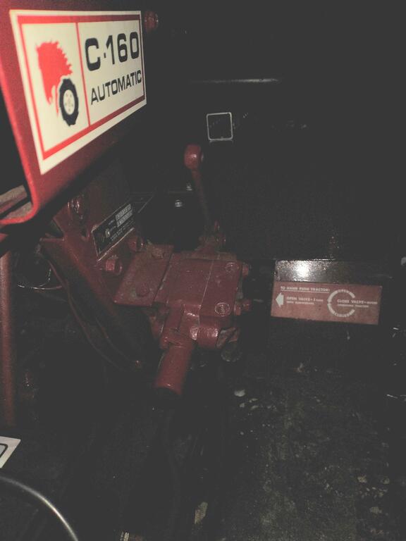

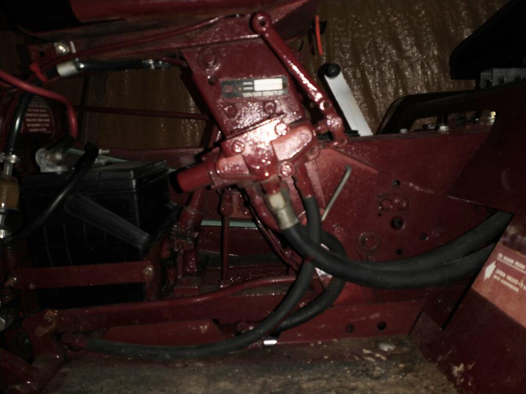

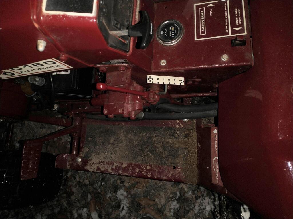

Here's a few pics of the C-160 control valve.
pfrederi
Not sure if yours is the same inside.  Just hope it is easier for you to deal with the istsy bitsy snap ring and get it together with out nicking the new cups...
I had to reseal one of mine as it leaked pretty badly.  i have not noticed the sagging on my plow tractors...but I usually only use full up or full down.  Also my plows are not as heavy as yours that may be a part of your issue...
Hope the new seals work
