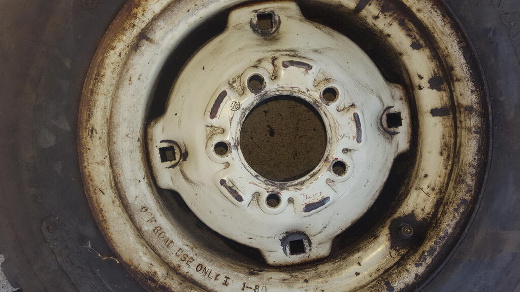

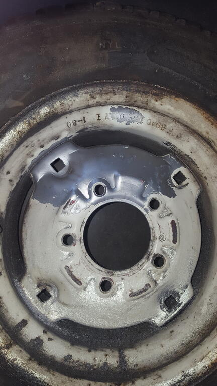

Gregor 4,847 #1 Posted December 18, 2021 A few days ago I said I was going to take a wheel outside and blast it with some coarser media, with my HF blaster. I can't seem to find that post now. I finally got I bought some coarser media and a face mask, (which I strongly recommend) and blasted a while. This was 5 lbs of media, and 15 minutes. Stopping 3 times to let the compressors catch up. That took a couple minutes each time. I think I could have trapped at least some of the media if I had a large box, and the wind would slow down to at least a gale. Before and after pics. I have a friend with a LARGE compressor in his shop. If it were warmer outside, I would take everything there, and try it out with an adequate compressor, but it snot. I think I could use coarser media if I could find it. I don't know if this would be better or not. It says large Grade. What does that mean? At this rate, the way I am doing it, I am sure it would take more than 50lbs. of media. That's not economically feasible. I need a box! Share this post Link to post Share on other sites
