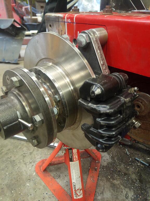

Since the whole hydraulic pump situation is a bit of a challenge and i've got to re-think the setup I turned my attention to the brakes.
I was going to use some calipers of a small car, Peugeot 106 but it turned out that, although small, they were to big to fit between the frame and the caliper.

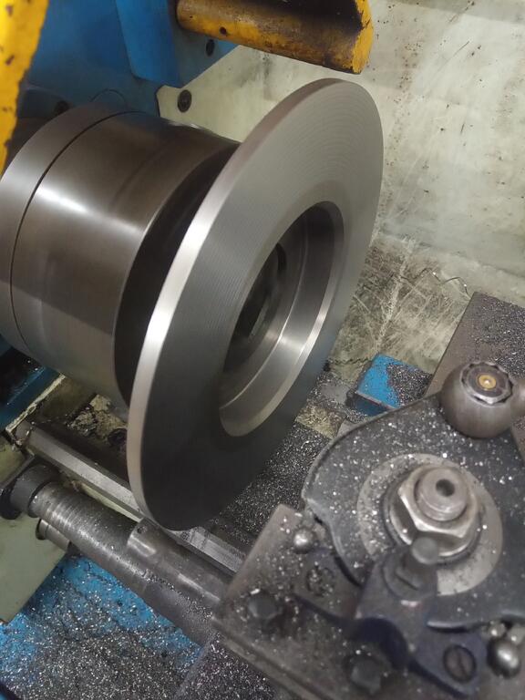

My dad pointed me to motorcycle calipers of some vintage bikes. So I went a bought a set of calipers off a '77 Honda CB 750.
Almost fit but the discs were a little to thick. So I skimmed both sides and made them fit.

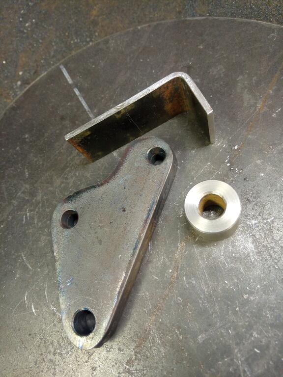

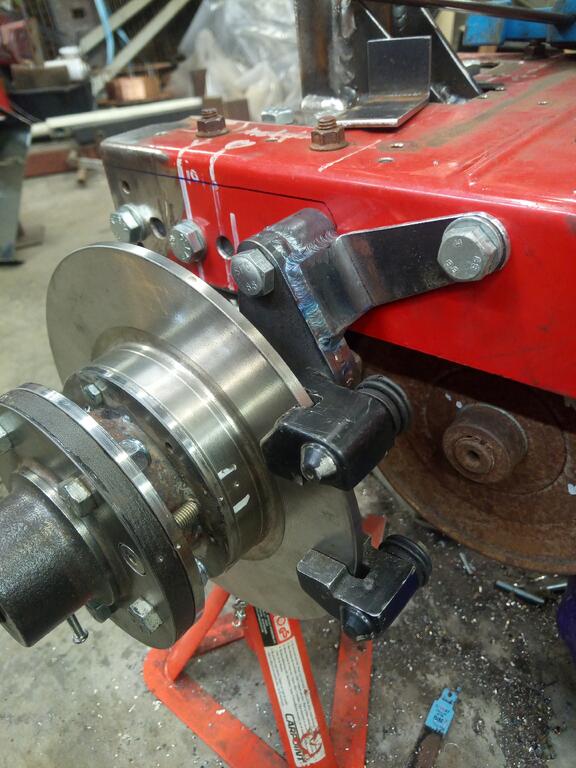

IMG_20220510_113605_4.jpgNext up mounting the calipers to the frame. Needed a bracket. Using Cardboard Aided Design I made a template and then transferred it to steel.

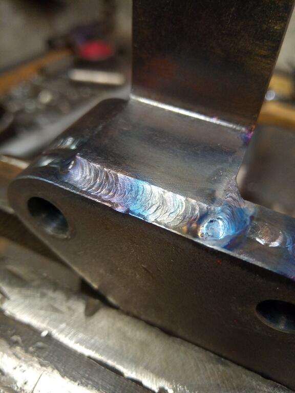

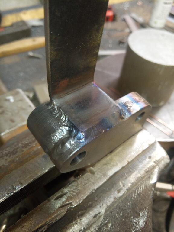

Some welding later gave me this nice mount.
There is still some flex in the frame but I think that will won't be an issue.
Dang you are good at welding. Those are beautiful.
  • Like 1
  • Thanks 1
sjoemie himself
  On 5/22/2022 at 12:48 AM, Handy Don said:
good
Thanks! I'm not an expert by a long shot, but practice does help improve my welds for sure.
  • Excellent 2
EB-80/8inPA
Well you must have been practicing a lot.  Those welds look fantastic.
  • Like 2
  • Thanks 1
Dan.gerous
Tig welder?

sjoemie himself
  On 5/22/2022 at 2:09 PM, Dan.gerous said:
Tig
 Yes
  • Like 2
Dan.gerous
  On 5/22/2022 at 3:49 PM, sjoemie himself said:
 Yes
Phew! You had me worried, those welds are beautiful 😍

sjoemie himself
  On 5/22/2022 at 3:59 PM, Dan.gerous said:
worried
No need to worry, just use what you've got.
That being said, buying a TIG machine is something you probably won't regret. I've got mine for about a year now and i'm using it more and more.
Quality of the welds is better, also stronger if you know what you're doing, less cleanup and it's a little bit neater look overall.
The disadvantage is the required skill, also it's a slower process and you need both hands (most of the time).

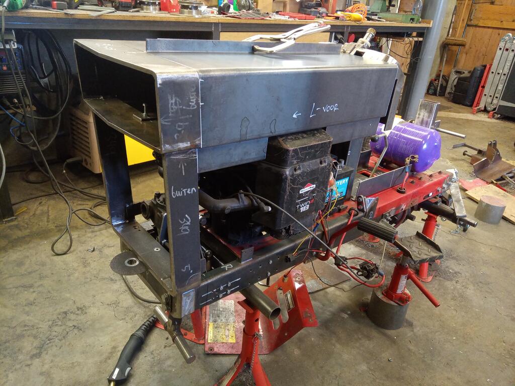

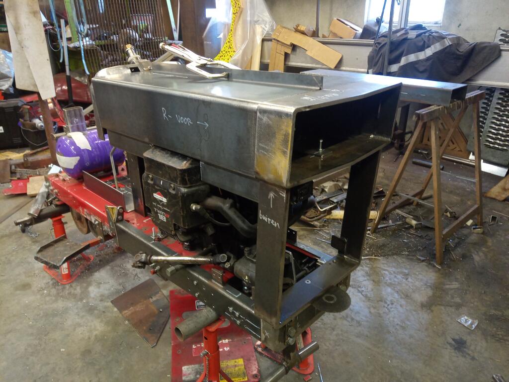

WAUW! dat is wat BEEFY metaalwerk Sjoemie!
  • Haha 3
Maxwell-8
indeed, she ain't going to be light haha
  • Like 1
  • Thanks 1
  • Haha 1
sjoemie himself
It's not that I didn't warn you guys :P
But you're right, I probably could've gone lighter on the sheetmetal gauge but I just don't like (working with) flimsy stuff.
My only concern are the front tyres, not that they can't handle the load, but more the fact that they're quite narrow and might sink into the dirt.. might have to go for something with a little more flotation..
