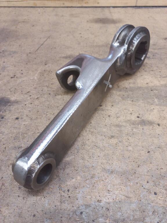

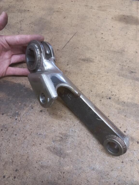

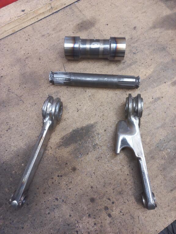

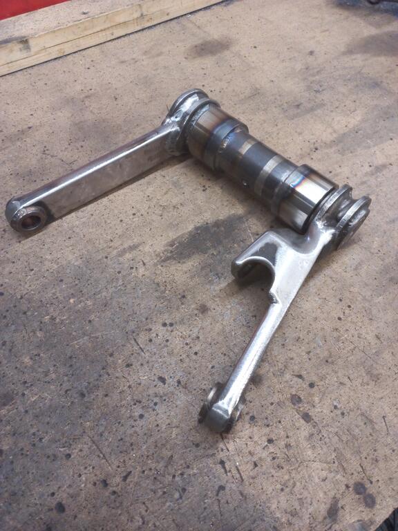

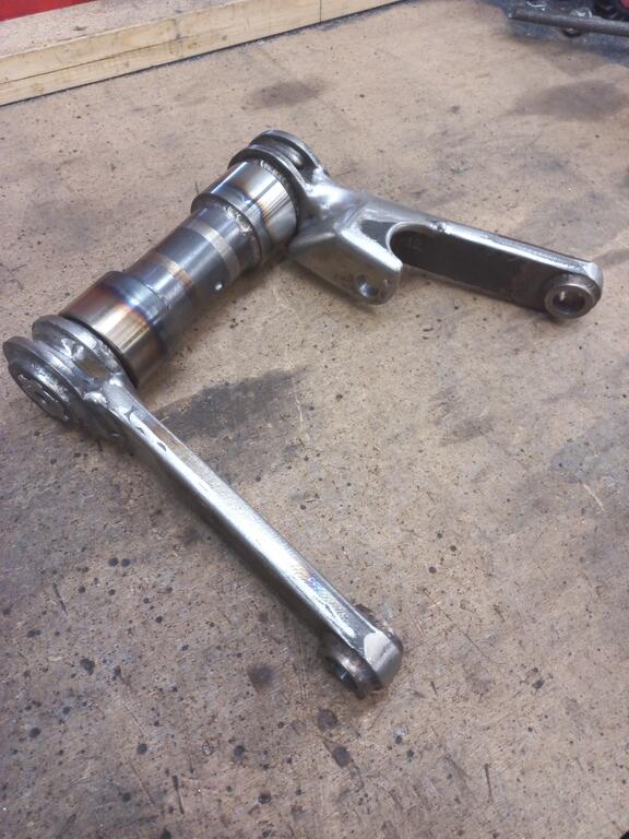

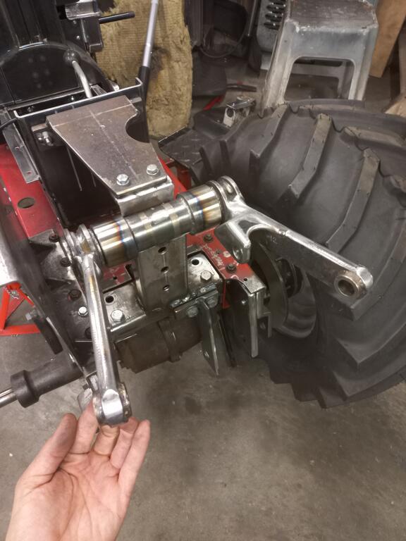

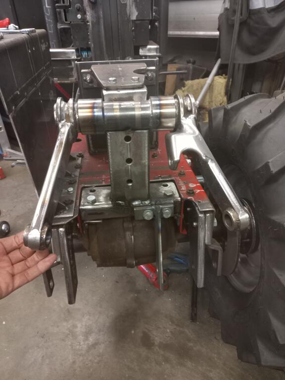

Now for an update. Been working on the 3-point some more and beefed up the upper liftarms.
Since that is were all the force will be applied I made sure that this will not break. Again probably overkill but hey.. more weight over the rear axle is not a bad thing. Anyway here's some pictures for your entertainment.
Any comments, questions or remarks are very welcome.
Greetings from the Netherlands, Mark

Those are purty. That's alot of blending right there. Absolutely a piece of art. I can't wait to see a video of this running and working.
sjoemie himself
Thank you both. Yes that was indeed a lot of blending. Welding, grinding, diegrinding, filing.. all the good stuff. I tried to make the arm look like it could be a cast and machined piece once it's all painted. Probably going to give the big round parts some more attention. They aren't as smooth as I would like yet, stand out in a negative way.
Still a few hurdles to go before I can lift implements with the tip of my fingers but slowly and surely we'll get there.
With the amount of work and craft going into this, I'm amazed you have time to do anything else (work, social life, eating, sleeping, etc.)
Even without the paint, those arms do look like worked castings or even CNC'd components.
Thank YOU for the entertainment.

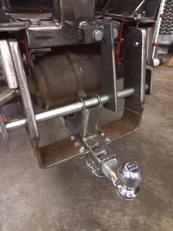

It's been awhile since I posted an update. Lost motivation after going to the harvest-show this summer and had some other things to do, life happened you could say.

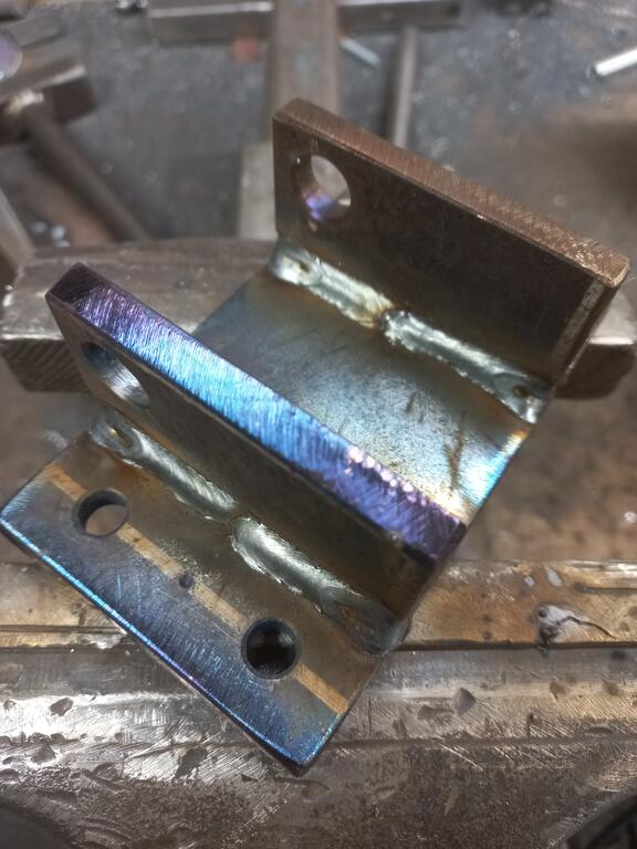

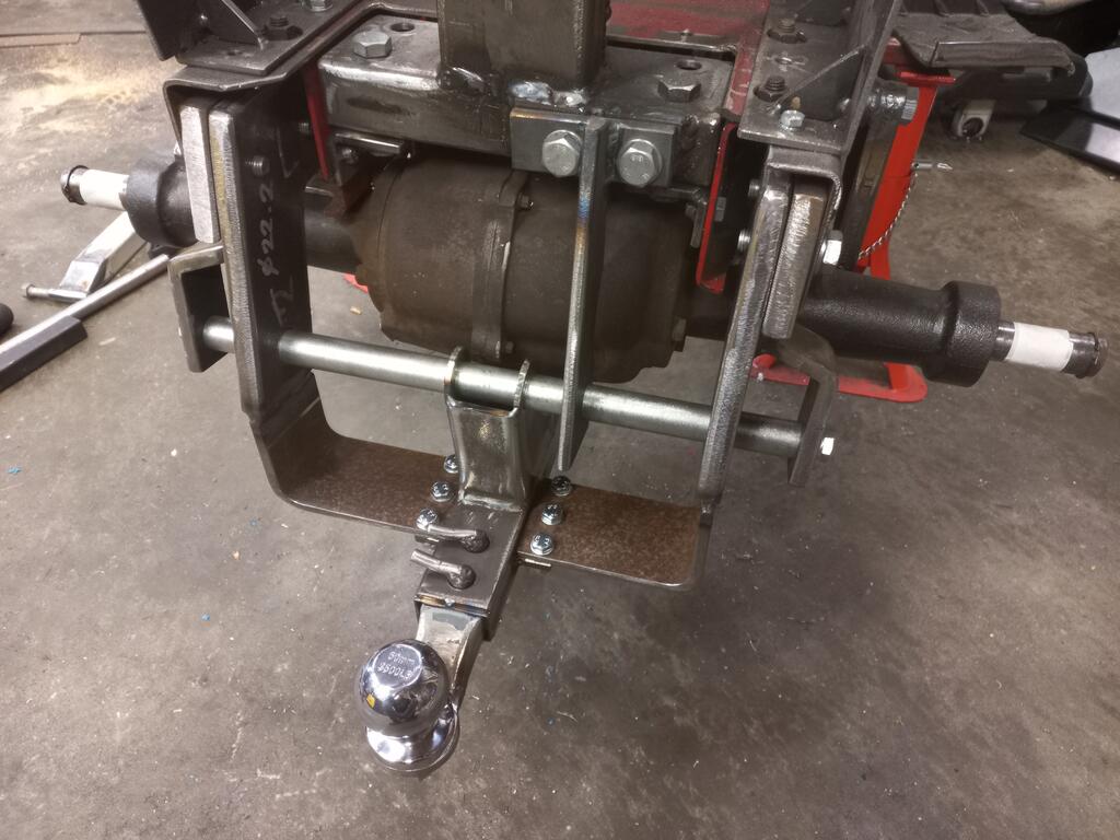

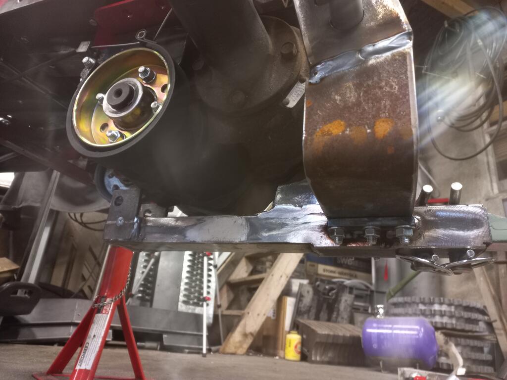

Anyhow.. worked on the hitch/drawbar thingy off and on for the last couple of days and this is what came of it.
  • Excellent 6
Fantastic welds!
Oldskool
I can say this.....it is absolutely obvious you love the hobby.
Everything looks  great
19richie66
I guess I have been sleeping under a rock. WOW what a build. Fantastic job. :handgestures-thumbupright:
10 hours ago, 19richie66 said:
I guess I have been sleeping under a rock.  :handgestures-thumbupright:
There are worse places to go...
Absolutely excellent 👍.
17 hours ago, Pullstart said:
Fantastic welds!
:text-yeahthat:

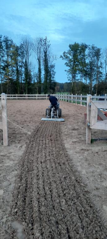

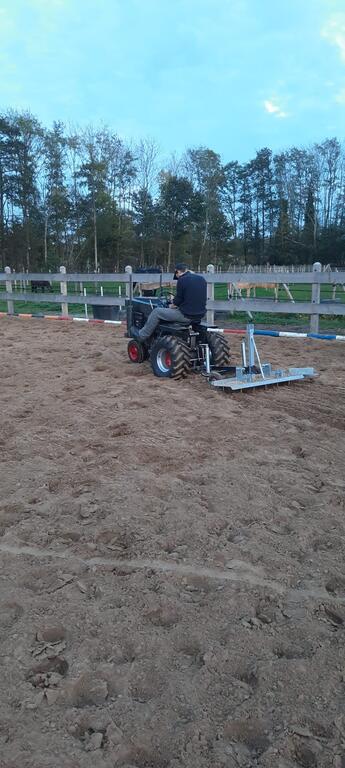

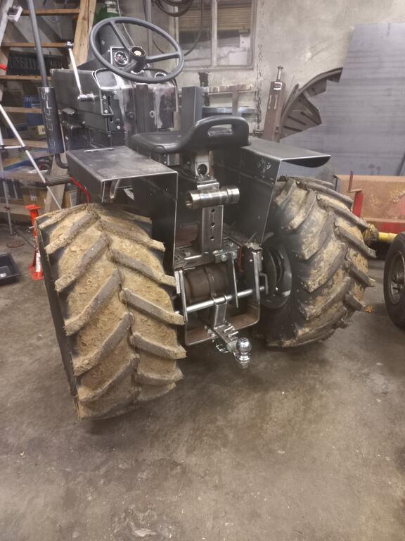

I was able to test the tractor today in a nearby horse arena. Let's say there's room for improvement.
The hitch could be a little higher and wheel weights are definitely desirable.
On hard and damp ground the tractor pulled well but in the dry loose sand I had quite a bit of wheelspin.
Was lots of fun though!
sjoemie himself
..aaand some pictures.
Was a bit too optimistic in the beginning
Aftermath:
How 'bout fluid filled tires in addition to the weights?
Sounds like you've got oodles of power and looks like the implement really wants to grab in.
Get that rig to bite ground and you'd be off n running!!

I agree with Eric. Fluid fill is a good way to go. Weights would help and always look cool of coarse. It does look like you have plenty of power to the wheels. Again, looks great. It looks like a successful first trip.

As for liquid filling, I am still a bit skeptical. Not because it wouldn't work but 1. I have no experience with this and 2. I have tubeless tires, which I understood is not really ideal.
With any luck I'll find a pair of matching wheel weights. I'd rather try that first before possibly starting with liquid
I am also looking for a couple of bigger but narrower tires for the tractor to make it look even more like the big example. Probably a 14 or 15 inch rim, possibly with duals.
The 18hp B&S oppy performs well although it smokes a bit. I drove it in 3rd or 4th gear (out of four gears total) and the engine handled it just fine.
Oldskool
On my Hiram tractor I used Chevrolet 16in wheels from a dual wheel truck and mounted some 7.00x16 AGs on them. I made and welded spacers in the centers and redrilled the lug holes. Garden tractor 12in wheel weights fit perfect. You could do something similar and have duals
It more or less depends on the liquid used, and it’s tendency to be corrosive.  Tubes are always a good idea when fluid filling, but not required.  Some people even break just one bead on their tire, then fill it up and re-seat the bead with a little air pressure.  I prefer to pump the fluid into a tube, and run zero air pressure, just fluid.
