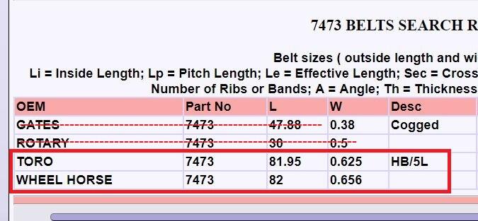

gwest_ca-(File Mod) 11,252 #2 Posted December 11, 2021 Yes it could be the problem. Should be transmission drive belt 78-7100 replaced by 7473 - HB x 81.9" or 5/8" x 81.9 The Gates replacement is 6982 or Napa 5L820W and green in color. A B-78 is 81" long if an industrial belt. A B-82 is 85" long if an industrial belt. 1 Share this post Link to post Share on other sites

Floyd Pink 44 #5 Posted December 11, 2021 7 hours ago, gwest_ca said: Yes it could be the problem. Should be transmission drive belt 78-7100 replaced by 7473 - HB x 81.9" or 5/8" x 81.9 The Gates replacement is 6982 or Napa 5L820W and green in color. A B-78 is 81" long if an industrial belt. A B-82 is 85" long if an industrial belt. 7 hours ago, gwest_ca said: Yes it could be the problem. Should be transmission drive belt 78-7100 replaced by 7473 - HB x 81.9" or 5/8" x 81.9 The Gates replacement is 6982 or Napa 5L820W and green in color. A B-78 is 81" long if an industrial belt. A B-82 is 85" long if an industrial belt. I went to NAPA & got the green belt. It is too long. About to call a psychiatrist. Share this post Link to post Share on other sites
squonk 42,587 #6 Posted December 12, 2021 Belt should be a 5L820W. Check to make sure the belt you got has the correct number on it. Sometimes belts get returned in the wrong sheave. Also pictures would help. Maybe some one has been in there before you and changed pulleys. Share this post Link to post Share on other sites
Floyd Pink 44 #7 Posted December 12, 2021 1 hour ago, squonk said: Belt should be a 5L820W. Check to make sure the belt you got has the correct number on it. Sometimes belts get returned in the wrong sheave. Also pictures would help. Maybe some one has been in there before you and changed pulleys. Now that I have tried the NAPA green belt (too long), should I take it back and get a belt 1" shorter? I am beginning to think that I might have inherited an oddball tractor. Everything says 81.9"............ The belt is marked right. The pulleys are all original. Everything is working right. The clutch pedal travel is back to normal. But when I put the belt on you could tell immediately it was too long. I am going to keep it for now and going to town for a belt 1 " shorter. Trial and error. One thing that may be considered, when I tighten the brake adjustment nut, I have no threads left to tighten the brake drum. Should there be any adjustment left on this? Or is it OK. The brakes are working as instructed in the manual. Sorry for being a pain. Share this post Link to post Share on other sites
