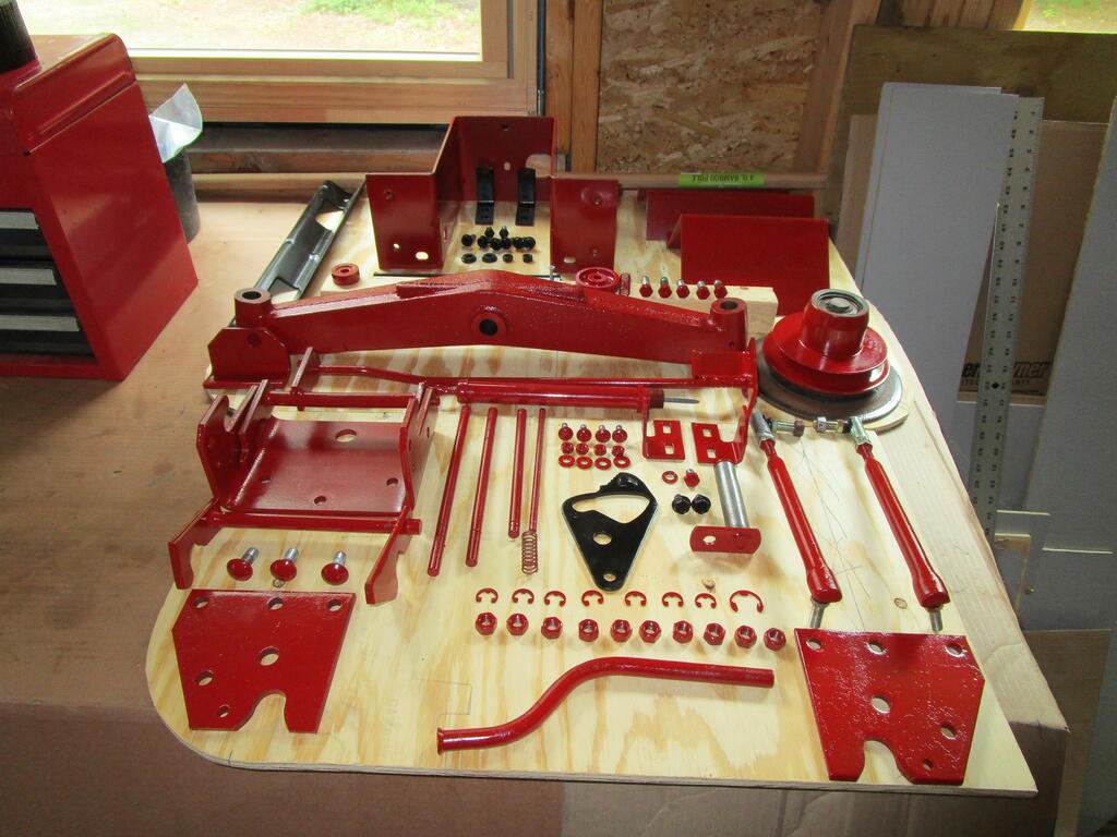

JCM 10,025 #15 Posted December 12, 2021 I use the cardboard method myself for hardware with 1 coat of primer and 2 coats of finish. Good results with small artist type brush for touch ups if needed @41chevy 3 1 Share this post Link to post Share on other sites
peter lena 9,093 #16 Posted December 12, 2021 @WHX?? agree with the stainless never seize lubricant , the stainless I use is the real thing , 316 -food grade stainless , left over from my work days , not the Chinese garbage they sell today , always flat washer it during build , no galling at any point , smooth threading , no problems, pete 4 Share this post Link to post Share on other sites
peter lena 9,093 #17 Posted December 12, 2021 @JCM nice lay out there , regularly detailing the hell out of any set up I use makes it work easier / better . that lucas x-tra heavy duty , green chassis grease would save every part of that , also use in the pto inside needle cone bearing , like butter. OPPORTUNITY for you to enhance the pto lever handle ,at your build state . look at the sloppy end of the pto lever , under battery area ground rail mount hole. added 3/8" or more washers and lube to firm up the play at lever end , 3 of mine are very solid and smooth in the lever engagement , also enhanced all related movement areas , also added heim joint at foward lever end , scary how easily that lever set up works , just what I do, keep it greasy , pete 5 Share this post Link to post Share on other sites
