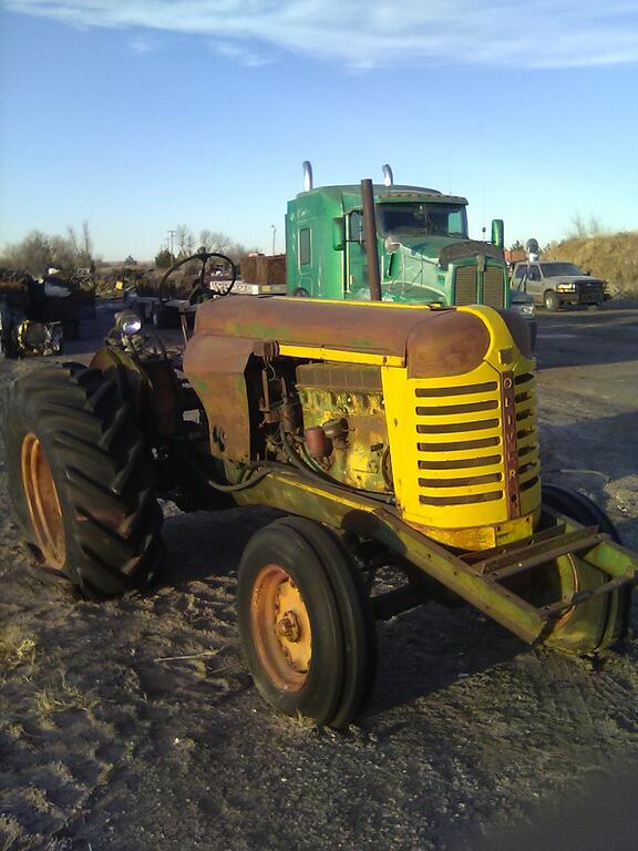

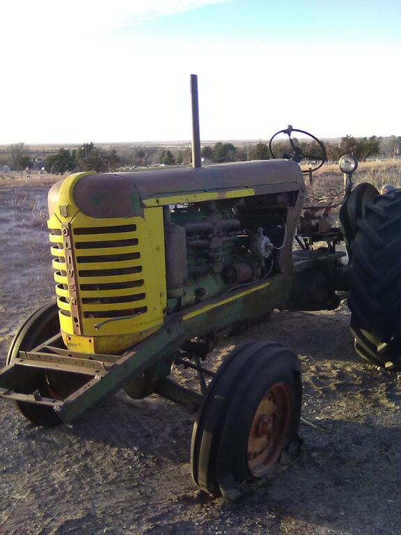

ClassicTractorProfessor 5,366 #1 Posted December 10, 2021 So this morning I was at work minding my own business, when a couple of the hands who work for the county came in to order some grader tires. Got to talking with them, and as it usually goes with me the conversation soon turned to antique tractors. Turns out that someone gave this old Oliver to the fire department to be crushed with a bunch of other junk vehicles. One of the guys was telling me about it and said they set it aside to see if I wanted it before they crushed it. The poor old thing is in pretty rough shape, engine is stuck and I'm sure it's bad inside, as it has been sitting outside for years with an open exhaust and missing 4 spark plugs. Missing several other parts as well, but I didn't have the heart to let it get crushed and be sent off to China to be made into junk. I was prepared to buy it for scrap price or a little over from the fire department, but was told I could have it as long as I brought something in exchange for it. As it turns out I happen to have a junk 2000 Silverado that's not worth fixing anymore, I just haven't taken the time to load it up and make the 65 mile trip to the scrapyard with it yet. So one day next week I'm gonna load it up on the trailer and haul it to the county barn to trade it for the tractor. Not sure what I'm ever gonna do with the old tractor, it's probably too far gone for my finances to be able to bring it back to life, but maybe I can find someone who can do something with it, or maybe parts of it can be used to save another one, no matter what happens at least it won't be crushed and melted down, and that makes me happy. 6 8 Share this post Link to post Share on other sites

Achto 28,183 #8 Posted December 11, 2021 9 hours ago, ClassicTractorProfessor said: I haven't been able to find any production numbers yet, but I'm almost sure there weren't a lot of them built to begin with. You see a few row crop versions here and there at shows, but this is the first standard tread model I have came across. Hard to tell from just pictures but it looks like an 88 standard. They were built from '47 - '54. They also made a 77 standard, the production was a little shorter those '49 - 52 We see a lot of Oliver's in our area. Row Crop 77's and 88's are very popular at the antique pulling tracks. With a lot of them having that 6cyl Waukesha modified and ripping down the track at 28 to 35 MPH. Share this post Link to post Share on other sites
ohiofarmer 3,314 #9 Posted December 11, 2021 (edited) http://www.tractordata.com/farm-tractors/000/6/7/674-oliver-88.html this site tells you where to find the serial number. Those Wakeshaw engines are tough. I have a Super 88 Diesel bought new by Dad in '52 Stuck might not be really be stuck badly. You can get a bore scope that has its own screen for fifty bucks. I just bought one for fifty bucks, but you can buy just the camera for attachment to a phone for less than that.. if the cylinders look horrible, high strength vinegar may do it after soaking for a week. Others use a combination of brake fluid and thin oil.. It also looks to me like there is a crank start on the front of the tractor. Always use the crank pulley on the front to do things by hand. Once it moves, crank it at intervals with no plugs in the pistons. i saw a father and son team get an old International KB1 straight six going with the kid prying o the flywheel teeth and the dad on the crankshaft bolt. they did it for hours before they were satisfied that the starter would turn it. Puddin's fab shop used vinegar for impossible datsun old engines as a last resort. Mortske Repair uses more conventional methods. . Vice grip Garage works on GM engines that are usually not stuck badly. Stuck engines are not always the rings. They can also be valves.. A patient person can turn an engine by hand forward AND back. good Luck Edited December 11, 2021 by ohiofarmer Share this post Link to post Share on other sites

wh500special 2,245 #11 Posted December 17, 2021 It looks like it had been set up to run propane. I hope you get lucky and find it was just abandoned and is in good shape inside. You can always pick an Oliver straight 6 out of a lineup of old tractors…they’re the ones NOT making a racket. So smooth. I love Olivers. steve Share this post Link to post Share on other sites

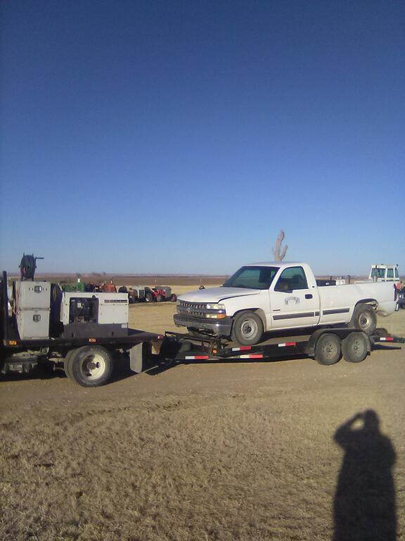

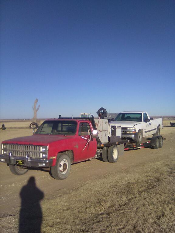

ClassicTractorProfessor 5,366 #13 Posted January 9, 2022 Don't worry I haven't forgotten or abandoned this save, just haven't had the time to get around to making it happen. Tomorrow is the day though, hooked up to the trailer and got the Chevy loaded, Tasha thinks we are finally getting rid of junk and cleaning up around here, so I may be in the doghouse when I leave here with a junk truck in the morning and come home with a rusty old broken tractor, oh well she's used to it by now 1 Share this post Link to post Share on other sites

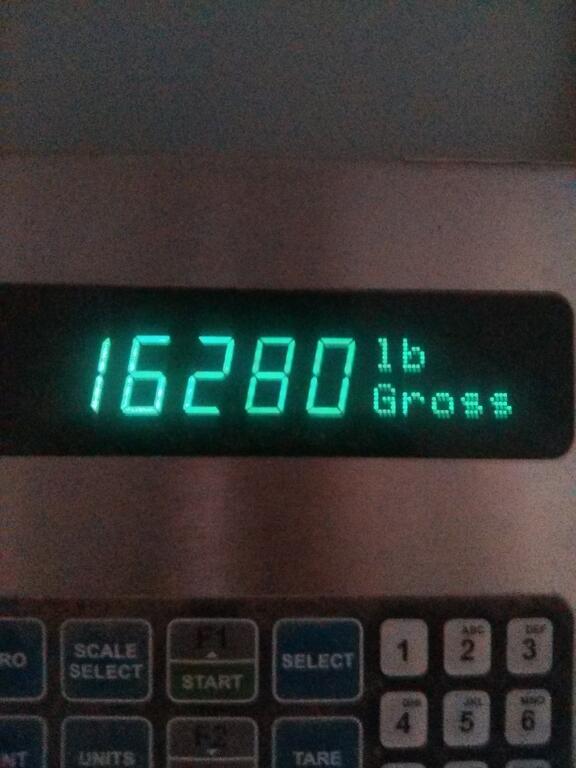

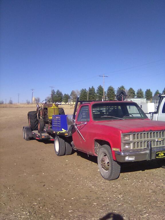

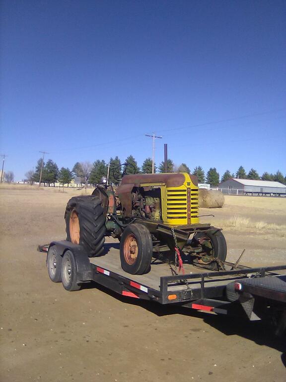

ClassicTractorProfessor 5,366 #14 Posted January 11, 2022 Made it home with the Oliver a little while ago, when Tasha came out of the house to meet me...had this funny knot appear on my head and the doc says the swelling in my eyes should go away in a day or too All kidding aside she wasn't upset one bit, she actually fell in love with the poor old thing and seems to think we need to save it, so I guess that might be what we're gonna do. I still need to get the borescope out and have a look inside, but from what I could see looking in the plug holes and down in the pan through the oil fill she's pretty rusty inside, gonna take a lot of hours and dollars to make this one run again. I should also report on how nice it is to have a big block standard shift dually again, came across the scales about 500 lbs heavier than I did with the F350 hauling the A home, but I could definitely tell a difference, the old 454 didn't even break a sweat hauling today. 2 Share this post Link to post Share on other sites
6wheeler 660 #15 Posted January 16, 2022 I think you have a repairable there. It looks too good to scrap it. I picked up an old Minneapolis Moline U that I was just gonna think about fixing. It was stuck. I didn't give up. She is up and running now. It was worth the time..... FIX IT. Good Luck Share this post Link to post Share on other sites
oliver2-44 10,073 #16 Posted January 17, 2022 (edited) Drain the engine pan of water and fill the cylinders and block with diesel and seal them up with plugs. Quickly pull the Tracy plug to check/ drain any water and if possible fill it with diesel on top the old oil (the thin diesel might leak out the old axle seals. Seal the shifter and let it soak several months, maybe all hot summer long. Its a good thing your not closer, I’d be in trouble taking it off your hands Edited January 17, 2022 by oliver2-44 Share this post Link to post Share on other sites
