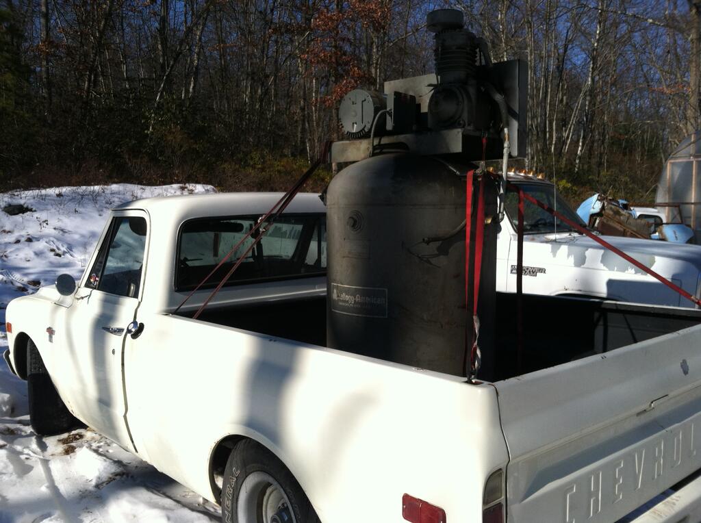

Jrain 276 #19 Posted January 8, 2022 On 12/10/2021 at 5:29 PM, pacer said: Heh!, aint they LOUD .... Theyre called 'oilless' and thats because .... well, they dont use oil in the compressor pump! and to my thinking that is why they are SO loud. The piston is not enclosed in a 'block' to dampen all that motion. Far as I can tell you will have to get up to a 'oiled' compressor and they dont seem to make that till you get on up into the more expensive ones. Course then they too can be a bit noisy because they ARE bigger. If you want to stay in the smaller types without the noise you'll probably have to prowl CL, facebook, garage sales, etc for a used one. Way back when .... 20-30....40? yrs ago the small compressors were oiled types - Sears, Sanborn, and many others had them in horizontal tanks of 20 or so gallons ran on 110 volts and they really were ... quite quiet . Pacer is spot on with what he said ,but you have to be patient and keep your eye on CL and FB market place , and I would add think of older air compressors like a older wheel horse ,they are built to last , when I was looking for another air compressor about 5 years ago that is what I did , I scored a Kellogg 2 stage 80 gallon for $300 , its big .it quiet and runs like a dream ,I have a old speed air 60 gallon single stage in my other garage its ok but no comparison to the Kellogg , its rebuildable and new parts are easy to find . Share this post Link to post Share on other sites
