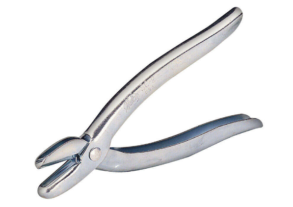

Jeff-C175 7,203 #1 Posted December 9, 2021 (edited) In another thread @Achto posted a video where a guy modified a set of duckbill pliers into a hand bender for Z-bends on control wires: So even though I have a Z-bender tool 'somewhere', I decided to make a pair like that. Thumbing through my tool box for a suitable set of junk donor pliers I came across these which I've had for ages. No idea where they came from, I know I didn't buy them, they just sort of appeared out of the air. Searched the interwebs for this model of plier and came up with NADA. I never knew what these were for. I thought maybe for twisting wires or something like that. Anyway, I decided to cut a notch in these to make the Z-bend tool and I gotta say, they work perfectly! By offsetting the notch to one side one can make two different depths of z-bend. The pliers would likely still work for their intended purpose, whatever that is / was. Does anyone know what these would have been used for? Edited December 9, 2021 by Jeff-C175 3 4 Share this post Link to post Share on other sites

Jeff-C175 7,203 #4 Posted December 9, 2021 6 hours ago, Gregor said: Was one of my thoughts too, but they don't open wide enough. 1 Share this post Link to post Share on other sites

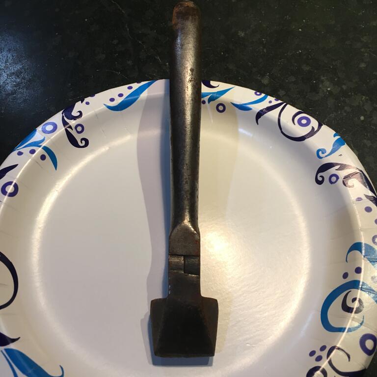

Jeff-C175 7,203 #5 Posted December 9, 2021 5 hours ago, Achto said: blacksmithing Sheet metal work? Flange crimper? Edge flattener? 1 Share this post Link to post Share on other sites
Gregor 4,847 #6 Posted December 9, 2021 I had (may still have somewhere) one of these for years and years. Took me a lotta years to find out what they were for. Share this post Link to post Share on other sites
Jeff-C175 7,203 #7 Posted December 9, 2021 3 minutes ago, Gregor said: I had (may still have somewhere) one of these for years and years. Took me a lotta years to find out what they were for. Looks like a crimping tool for ducting work. The one I have does several crimps at a time. That one could be used for gutter and downspout work, and for roof flashing. 2 Share this post Link to post Share on other sites

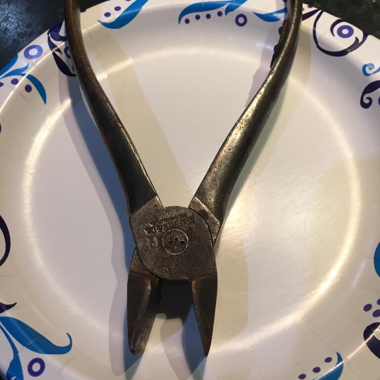

Jrain 276 #8 Posted January 8, 2022 On 12/8/2021 at 9:10 PM, Jeff-C175 said: In another thread @Achto posted a video where a guy modified a set of duckbill pliers into a hand bender for Z-bends on control wires: So even though I have a Z-bender tool 'somewhere', I decided to make a pair like that. Thumbing through my tool box for a suitable set of junk donor pliers I came across these which I've had for ages. No idea where they came from, I know I didn't buy them, they just sort of appeared out of the air. Searched the interwebs for this model of plier and came up with NADA. I never knew what these were for. I thought maybe for twisting wires or something like that. Anyway, I decided to cut a notch in these to make the Z-bend tool and I gotta say, they work perfectly! By offsetting the notch to one side one can make two different depths of z-bend. The pliers would likely still work for their intended purpose, whatever that is / was. Does anyone know what these would have been used for? Yes I know what they are ,you made me cringe when I saw what you did to those LOL , They are used in my trade , I collect them and have many sizes and styles of them, I have a collection of them my earliest ones were made in 1897 , Those are about the smallest version that were offered . I would say those are from the mid 1970s , The correct term for them are Hand Seamers , AKA Tongs or duckbill , from the pictures yours would have a up to 14 gauge seaming capability , those would be used in tight corner hand seaming situations , those would have worked magic on your wheel horse tins , like correcting the the edges of fenders or hoods that have been beaten up over the years. But hey you made good use of them Share this post Link to post Share on other sites
Jeff-C175 7,203 #9 Posted January 8, 2022 3 minutes ago, Jrain said: you made me cringe when I saw what you did to those I'm sorry! 4 minutes ago, Jrain said: But hey you made good use of them And they would surely still work for their intended use I think. So all is not lost! I still don't understand why Mrs. Google can't find the part number, and I can't find it in any of the Crescent tool catalogs I've found. 5 minutes ago, Jrain said: my trade Tin knocker? Share this post Link to post Share on other sites
Jrain 276 #10 Posted January 8, 2022 On 12/9/2021 at 11:59 AM, Jeff-C175 said: Looks like a crimping tool for ducting work. The one I have does several crimps at a time. That one could be used for gutter and downspout work, and for roof flashing. Correct hand crimpers those are light gauge single crimp , yes they make them in triple and quad crimp , they are rated by gauge of metal light duty up to 24 gauge and heavy duty version up to 14 gauge sheet metal Share this post Link to post Share on other sites

Jrain 276 #14 Posted January 9, 2022 Theses are the same size hand seamers , they were made in 1910 by Kraeuter & co Newark NJ 1 Share this post Link to post Share on other sites
