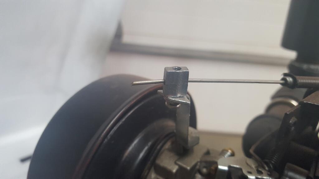

peter lena 9,093 #2 Posted December 8, 2021 @Jon925mn , think that cable should be a easy pick up , the important part of re cabling IS THE LAY OUT , mount it where it works best , with added cable clamp screw on tabs , and SUPER LUBE , teflon lubricant . continue to verify smooth easy function at every step , don't get to the end and find its stiff in function. I also put a light spring on each side of my end lever points , for a pull back at every use , mine work very smooth , no binding , pete Share this post Link to post Share on other sites

peter lena 9,093 #5 Posted December 8, 2021 @Jon925mn this is my set up , very easy to add perforated mount holes to any screw or bolt , springs put a balance to cable operation , have them on my 3 horses , ever try to PUSH A CABLE ? pete Share this post Link to post Share on other sites

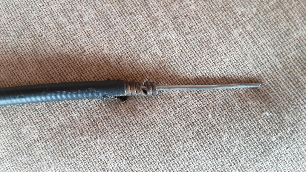

Jon925mn 39 #15 Posted December 8, 2021 Here is picture of cable end and sheathing issue which will need to be cut to pinch again. Share this post Link to post Share on other sites

Gregor 4,847 #17 Posted December 8, 2021 Carefully grind sheathing back 1/2". DON"T GRIND INTO WIRE !!!! You only have to grind through one side, the piece will slide off. If you don't have a bender, bending that Z tight enough with pliers can be a PITA ! You have a pic of the lever assembly? Share this post Link to post Share on other sites
Achto 28,806 #18 Posted December 8, 2021 5 minutes ago, Gregor said: Carefully grind sheathing back 1/2". DON"T GRIND INTO WIRE !!!! I just pull the wire back far enough so that I can cut strait through the sheath. 3 Share this post Link to post Share on other sites

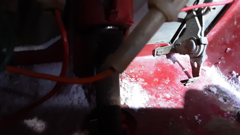

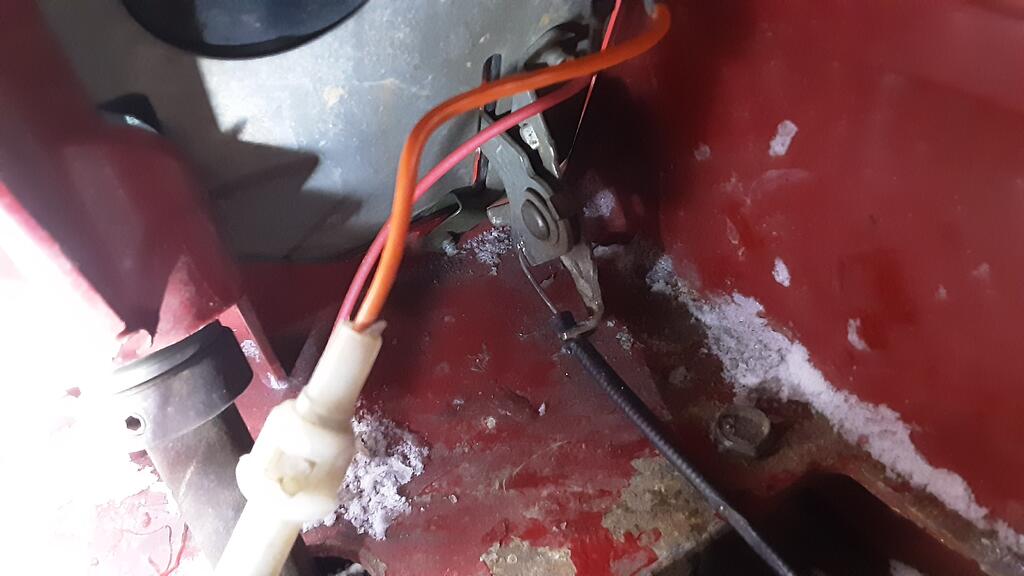

Jon925mn 39 #19 Posted December 8, 2021 Lever pic with snow. Can the rivets be drilled out and replaced with bolt/nut. I dont have a bender so will have to swear my way to a new bend. Share this post Link to post Share on other sites

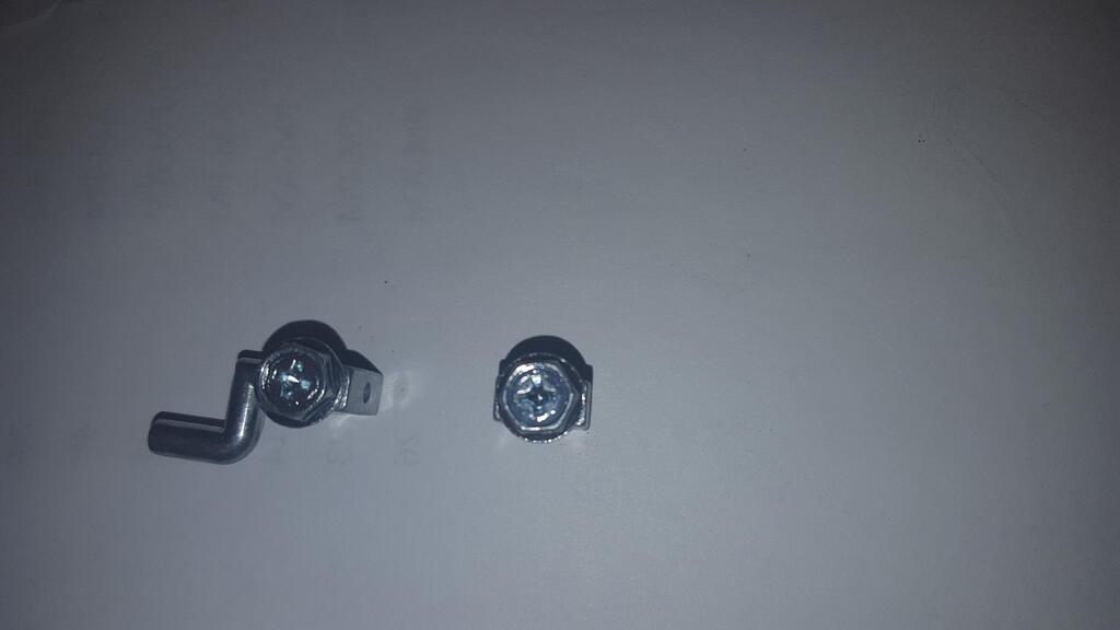

Gregor 4,847 #21 Posted December 8, 2021 Any rivet can be drilled out and replaced with a bolt I would think. Trouble is getting, and keeping the correct pressure on the lever assembly. A wave washer, or 2 , would be nice. I have used these when space allows. You don't have to bend the wire, and it gives you another adjustment point. Grind off that L shaped part. You don't need it. After looking at your lever, I don't think this little gizmo would work. No room for that Phillips head screw., I don't think, but can't really tell. 1 Share this post Link to post Share on other sites

Achto 28,806 #23 Posted December 8, 2021 22 minutes ago, Jon925mn said: Can the rivets be drilled out and replaced with bolt/nut. Definitely. Share this post Link to post Share on other sites
