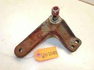

Achto 32,026 #13 Posted December 8, 2021 10 hours ago, tractorhogg said: steering gears were "like glass", This steering part is a common fail on the D-series. The one in this pic was for sale, note that it has a weld repair on it. On the D160 that I have, both arms had been broken off, welded back on and broke off again away from the previous repair.. Share this post Link to post Share on other sites

pfrederi 20,782 #17 Posted December 8, 2021 3 hours ago, Achto said: This steering part is a common fail on the D-series. The one in this pic was for sale, note that it has a weld repair on it. On the D160 that I have, both arms had been broken off, welded back on and broke off again away from the previous repair.. The one on my D when I got it was cracked. also had to replace some other worn out broken front end parts.. 1 Share this post Link to post Share on other sites
tractorhogg 656 #18 Posted December 9, 2021 10 hours ago, Achto said: This steering part is a common fail on the D-series. The one in this pic was for sale, note that it has a weld repair on it. On the D160 that I have, both arms had been broken off, welded back on and broke off again away from the previous repair.. Do you think that if it was cleaned and more metal added to both arms it would be stronger? Share this post Link to post Share on other sites
Achto 32,026 #19 Posted December 9, 2021 3 minutes ago, tractorhogg said: Do you think that if it was cleaned and more metal added to both arms it would be stronger? That may be possible. They are made out of cast iron. I was thinking of fabricating one out of steel, which would be much stronger. Instead I scored one that was in real good shape for $30 to my door. If this one fails I will most likely fabricate one out of steel. Share this post Link to post Share on other sites
tractorhogg 656 #20 Posted December 9, 2021 10 minutes ago, Achto said: That may be possible. They are made out of cast iron. I was thinking of fabricating one out of steel, which would be much stronger. Instead I scored one that was in real good shape for $30 to my door. If this one fails I will most likely fabricate one out of steel. I was thinking of added inserts in the middle steel using nickel welding rods to weld to cast iron, it helps if you heat the cast iron red hot with a torch and then use a stick welder with nickel rods. 1 Share this post Link to post Share on other sites
