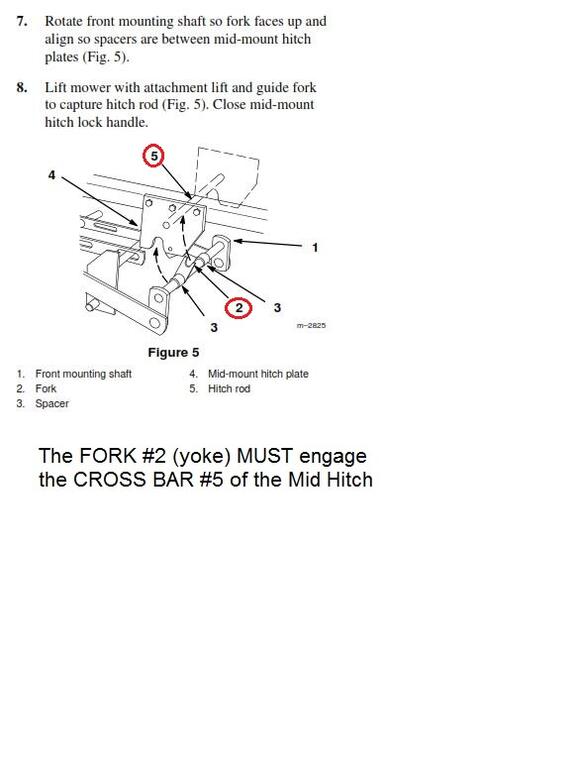

daveoman1966 3,880 #2 Posted December 5, 2021 Firstly, is the deck mounted correctly... If not, the deck will flop around in all directions. 1 Share this post Link to post Share on other sites

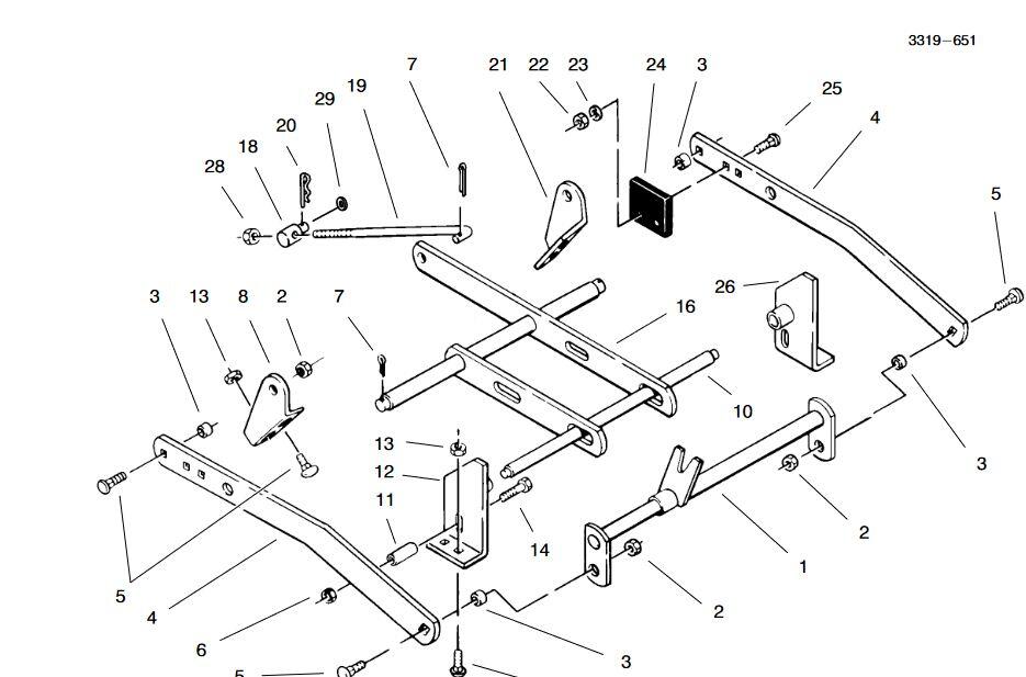

pfrederi 19,238 #3 Posted December 5, 2021 The only adjustable level is front to back. You want the front about 1/8" lower than the back. You will see a threaded 3/8 inch rod center rear. Item 19 tighten or loosen 28 to adjust. Share this post Link to post Share on other sites
RED-Z06 2,690 #4 Posted December 5, 2021 4 minutes ago, daveoman1966 said: Firstly, is the deck mounted correctly... If not, the deck will flop around in all directions. Oh yes, fully engaged, pain in the butt to get it to all pop together sometimes. Share this post Link to post Share on other sites
RED-Z06 2,690 #5 Posted December 5, 2021 4 minutes ago, pfrederi said: The only adjustable level is front to back. You want the front about 1/8" lower than the back. You will see a threaded 3/8 inch rod center rear. Item 19 tighten or loosen 28 to adjust. Ill check the front to rear, but it seems like its off left to right. Maybe the rear wheel bar is twisted Share this post Link to post Share on other sites
