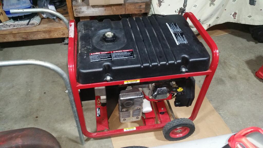

JoeM 7,942 #1 Posted November 29, 2021 Pulled out the back-up generator the other day to test run. Just making sure everything is tickety-boo...... Well not. I use non e fuel and run r dry when I put it away and still had carb issues. It has not been run in a while, i would say spring. maybe last winter, it has been a while. Would not run without choke. So take it to the shop do the carb cleaning, oil, air filter, fuel line (seemed brittle), and a new fuel filter. Test run great, no issues other than one 120v receptacle was kind of loose. (ended up having a crack). Of course, the receptacles are commercial grade and I did not have any. Got the new receptacles installed and went to start it and no run. Wasn't getting gas. The new inline MTD fuel filter was the fault. Could just barely blow through it and when put in place on gravity feed... no dice! Tank, fuel lines all cean. The carb really didn't seem to bad when I cleaned it. Out of the scores of fuel filters I have replaced I never had this happen. Might cut it open in a day or two to take a look. 4 Share this post Link to post Share on other sites

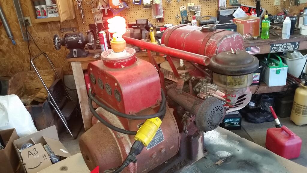

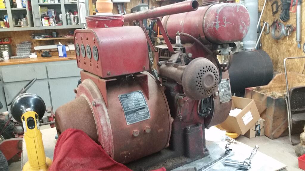

WHX?? 50,778 #11 Posted November 30, 2021 Not to jack your thread here Joe but while we are on gennys I pulled this one out to see if she would fire. Vintage K91 ... that did run quite well last time I lit a fire but since gennies were the project of the day. No filter but a bowl that had brown gas in it but not the smell of old gas. You guys know.... and cleaned that out. What's that saying Squonky @squonk ther are sediment bowls that don't leak and ther are ones that are gonna!?!? But anyhoo cleaned the bowl and dumped 100 % seafoam in her. Tank was dead dry and little rust . Did I do the right thing here? I know I ran her dry befor I layed her up. Have not tried to start it but feeling I should just to keep her loose. 2 2 Share this post Link to post Share on other sites
echris 1,425 #12 Posted November 30, 2021 This may sound silly, but are you sure you had the fuel flowing going the correct direction through the fuel filter? I don't know how common they are, but back in the day I remember fuel filters with check valves built-in. 1 Share this post Link to post Share on other sites

squonk 42,584 #14 Posted November 30, 2021 I have seen those clear plastic filters air lock more than once. Buy the packaged 4 cycle fuel from Lowes, TSC ect. 3 year.shelf life. Store it with that in the tank and carb. Also will.keep the air out of the filter.because you don't run it dry. 2 Share this post Link to post Share on other sites

JoeM 7,942 #16 Posted November 30, 2021 It is all pretty odd. The fuel was even new non e clean gas. I am starting to think like Mike about not running them dry. I know when I used ethanol fuel it seemed to help. This is the brand filter I used. I am still going for cutting the old one apart. 7 hours ago, WHX?? said: Tank was dead dry and little rust . Did I do the right thing here? I know I ran her dry befor I layed her up. Have not tried to start it but feeling I should just to keep her loose. Wonder how well that stabile 360 works on keeping the metal tanks in good condition? They say that is it's claim to fame. 1 Share this post Link to post Share on other sites

squonk 42,584 #18 Posted November 30, 2021 1 hour ago, JoeM said: It is all pretty odd. The fuel was even new non e clean gas. I am starting to think like Mike about not running them dry. I know when I used ethanol fuel it seemed to help. This is the brand filter I used. I am still going for cutting the old one apart. Wonder how well that stabile 360 works on keeping the metal tanks in good condition? They say that is it's claim to fame. Joe, that's the style filter that I had the air lock problems with. 3 Share this post Link to post Share on other sites

squonk 42,584 #22 Posted November 30, 2021 I had a 210-H. 10HP Briggs and the gas tank way above the carb. If I installed that filter or ran it out of gas it would air lock and not let gas flow thru. I would have to take the hose off the carb inlet and get gas flowing then stick the hose back on. first I thought it was just the filter but I tried another and the same thing. These were good Wix filters too. Napa # 3011 Share this post Link to post Share on other sites
JoeM 7,942 #23 Posted November 30, 2021 26 minutes ago, squonk said: If I installed that filter or ran it out of gas it would air lock and not let gas flow thru Exactly what happened here. This one is installed is vertical. Might make it worse. IDK? Going back to the round barrel type Kohler. I am going to give that a try and run her dry. Wait a day and see. I will post later in the week on the result. 2 Share this post Link to post Share on other sites
