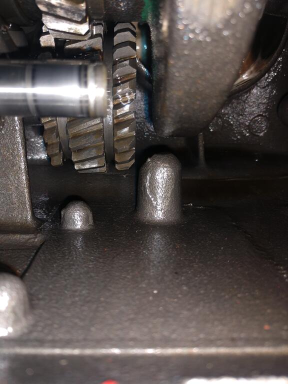

kpinnc 13,798 #1 Posted November 28, 2021 FILs Charger- I couldn't leave it alone. I decided to get the balance gears out. I got the snap rings off, and the bottom gear out. What is the trick to the top one? It will not come out no matter where I rotate the crank. The galley for the rear starter bolt is in the way. Do I drive out the shaft for it? 1 Share this post Link to post Share on other sites

kpinnc 13,798 #3 Posted November 28, 2021 Here ya go: 3 Share this post Link to post Share on other sites

953 nut 58,024 #5 Posted November 28, 2021 11 minutes ago, kpinnc said: Do I drive out the shaft for it? This post should be helpful. 1 Share this post Link to post Share on other sites
Snoopy11 5,717 #6 Posted November 28, 2021 'specially the part... As for the top gear...... split it with a cold chisel and it will come right off. Share this post Link to post Share on other sites
kpinnc 13,798 #7 Posted November 28, 2021 Ok, so he drove out the pin and then back when finished. Makes sense. I was hoping for something simpler, but I can definitely do that. I've removed balance gears several times, but only during a rebuild. Never done it on an engine I planned to keep together during the process. Thank you! 3 Share this post Link to post Share on other sites

Snoopy11 5,717 #10 Posted November 28, 2021 The crank throw on that 341 will never let you get it out without more work... Don Share this post Link to post Share on other sites

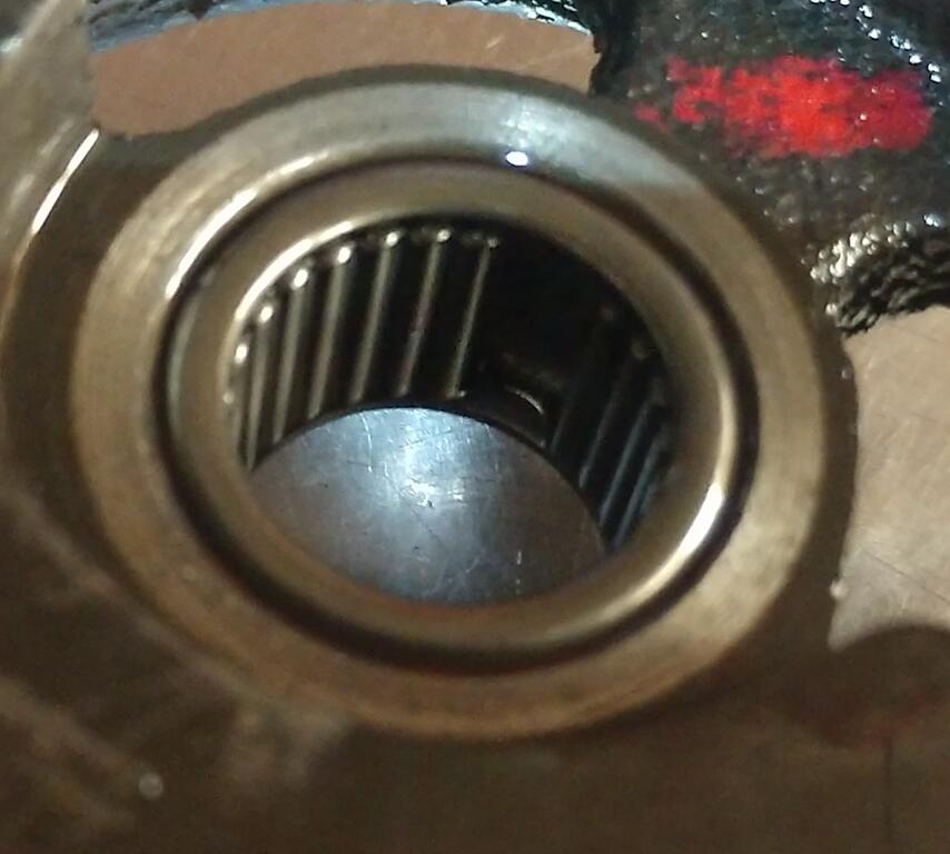

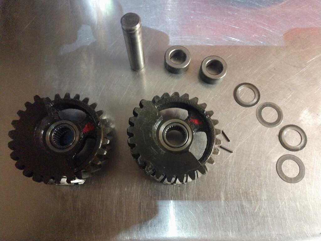

kpinnc 13,798 #11 Posted November 28, 2021 (edited) Success!!!! Thanks fellas! Notice the bearings? I think this was a good thing to do! I babied these things, so this was about to fail anyway! Edited November 28, 2021 by kpinnc 2 3 Share this post Link to post Share on other sites
Snoopy11 5,717 #12 Posted November 28, 2021 DAD GUM... VERY good thing that you took this apart... Don 1 Share this post Link to post Share on other sites

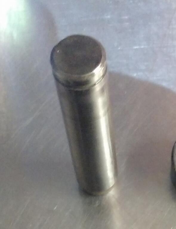

oliver2-44 10,373 #13 Posted November 28, 2021 So @kpinnc how did you drive the pin out? Did you drive it inwards? Share this post Link to post Share on other sites
kpinnc 13,798 #14 Posted November 28, 2021 (edited) 1 hour ago, oliver2-44 said: So @kpinnc how did you drive the pin out? Did you drive it inwards? Outside in. No way to go inside out with the crankshaft installed. Same on the install. Outside in. I know the cam pin only goes one way, but I never thought about the pin for the balance gears being the same. They are heavily beveled on the outside (bottom), and I thought that was to help stop swedging the end you tap on. Edited November 28, 2021 by kpinnc 1 1 Share this post Link to post Share on other sites

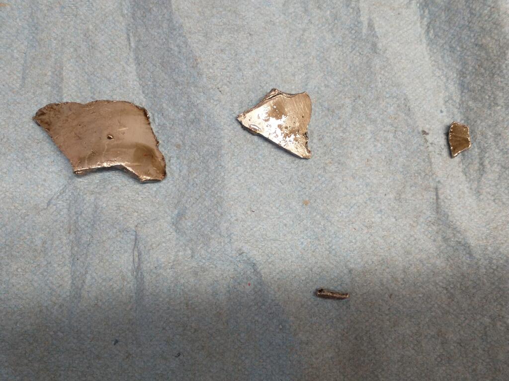

squonk 42,592 #16 Posted November 28, 2021 Found remnants of a balance gear needle in the pan of my C160 a couple of years ago along with a piston skirt. . 1 Share this post Link to post Share on other sites
pacer 3,176 #17 Posted November 28, 2021 GEEZ!! those dang "grenade" gears!! 2-3 yrs ago I picked up a ---- something? with a K341 and pretty quickly got it running so decided to give er a test job and proceeded to cut some grass. It ran really well, no smoke, etc, but had an ....odd .... rattling sound? After bout 30 mins I got really nervous about continuing and went back to the shop. I think there had recently been a couple posts here re the "grenade gears" so I went into it. Those pics @kpinnc show could be pics of what I found! ------ Whew, close call!! Share this post Link to post Share on other sites
