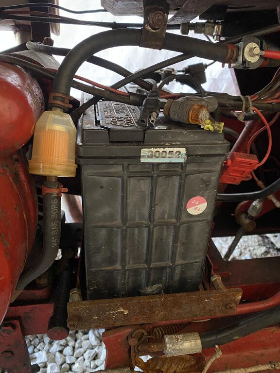

formariz 11,993 #10 Posted November 23, 2021 All my stored tractors and batteries are always plugged into trickle chargers. They in turn are connected to timers only working up to 8 hours. I have here batteries that are about 9 years old. 2 3 Share this post Link to post Share on other sites
buckeyes 214 #11 Posted November 23, 2021 A nine year old battery on any type of vehicle is very impressive! 1 1 Share this post Link to post Share on other sites

formariz 11,993 #17 Posted November 23, 2021 40 minutes ago, buckeyes said: A nine year old battery on any type of vehicle is very impressive! The oldest one here by no means an exception. Check date. 1 2 Share this post Link to post Share on other sites
Snoopy11 5,717 #18 Posted November 23, 2021 1 minute ago, formariz said: The oldest one here by no means an exception. Can you name-drop a brand on that? Don 1 Share this post Link to post Share on other sites
Maxwell-8 4,366 #19 Posted November 23, 2021 10 minutes ago, formariz said: The oldest one here by no means an exception. Check date. 2012? Our oldest ones are from 2014 and not really looked after to much, they just got charged a couple times a year. 1 1 Share this post Link to post Share on other sites
formariz 11,993 #20 Posted November 23, 2021 8 minutes ago, Snoopy11 said: Can you name-drop a brand on that? Don It’s a Diehard. Most that I have are Diehards. However I have a 2012 Ford E-250 Van with the original Motorcraft battery in it. 2 Share this post Link to post Share on other sites

formariz 11,993 #23 Posted November 23, 2021 2 hours ago, Maxwell-8 said: 2012? Lets see if anyone can decipher it. It is marked J-4/10-4. Hard to believe but true. 1 1 Share this post Link to post Share on other sites

Snoopy11 5,717 #25 Posted November 23, 2021 1 hour ago, formariz said: Lets see if anyone can decipher it. It is marked J-4/10-4. Hard to believe but true. I am... stumped... I could probably google it... but that wouldn't be fair... Don 1 Share this post Link to post Share on other sites
