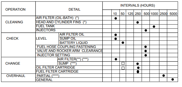

Lombardini made 1cyl diesel engines up to 18hp
The manual calls for a 250hour oil interval!! that is 10 times less often then a Kohler.
