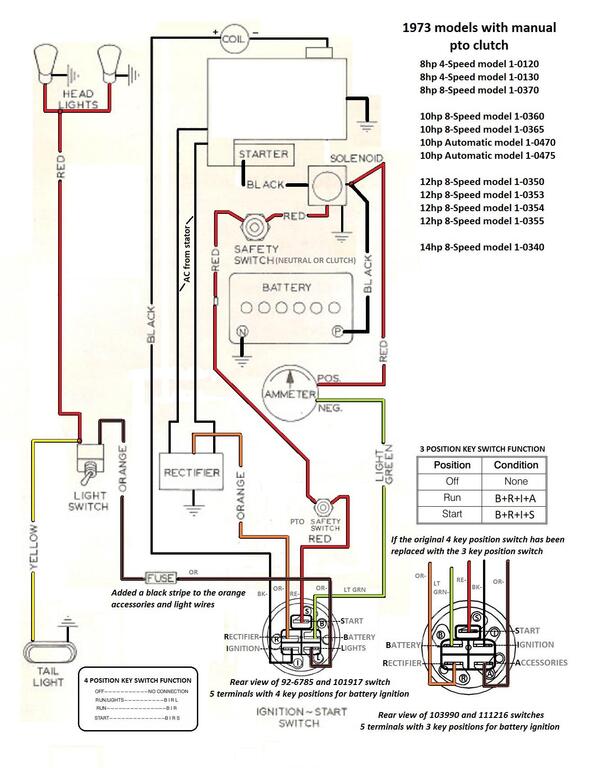

A 103990 will work. 103991 is for mag ignition I think. One of these should work.

gwest_ca
8362 is a 4 key position switch and  uses the RMLBS wire positions for magneto ignition.
The 101917 is a 4 key position switch used with battery ignition and original to your tractor.
The last wiring above includes a diagram to use the 3 key position 103990 for battery ignition.
There is a way to remove the wires from their holder so you can relocate them in the correct positions.
Battery, Ignition and Rectifier need to be moved.

953 nut
Sounds like you have the wrong switch for your application. Here is a little thread that Garry @gwest_ca and I did on the two most prevalent switches, the 103-990 and the 103-991. Hope this will clear things up a bit. As shown in the diagram Mike @squonk sent there will be a need to relocate a couple of wires in your 5 terminal plug, they are a Delphi Packard 56 connector and if you use a small screwdriver to depress the spring clip they can be removed and relocated, se the photo below.
