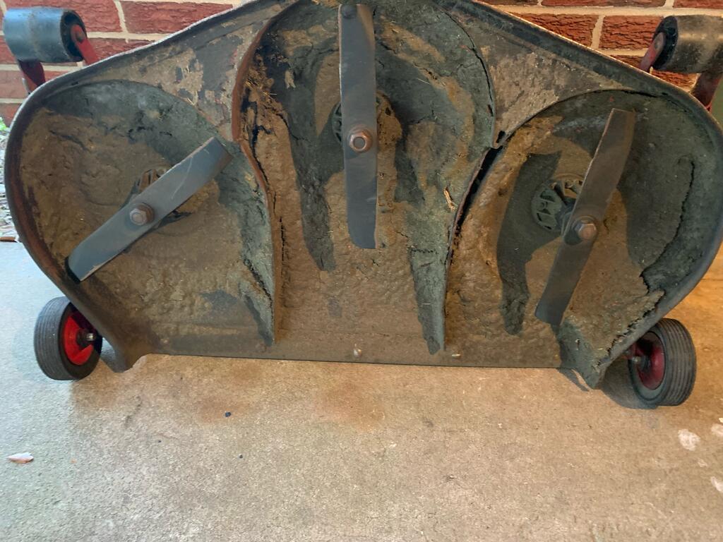

scWHhauler 96 #1 Posted November 16, 2021 Hay uall any fresh thoughts on how to stop this from happing i got this deck and it was coated with what looked like truck lining. i am not beyond stripping it and starting over but what to coat it with? Share this post Link to post Share on other sites
SylvanLakeWH 26,556 #2 Posted November 16, 2021 Clean / scrape after use. Spray /wipe with oil…used or spray on…Don’t store them caked /wet… @peter lena has a good approach to deck maintenance… 3 Share this post Link to post Share on other sites
Handy Don 13,054 #3 Posted November 16, 2021 24 minutes ago, scWHhauler said: Hay uall any fresh thoughts on how to stop this from happing i got this deck and it was coated with what looked like truck lining. i am not beyond stripping it and starting over but what to coat it with? Not just the coating. Using a mulching-style deck while mowing grass with a lot of moisture content turns grass into mush which will stick on nearly anything and then cake up. Share this post Link to post Share on other sites

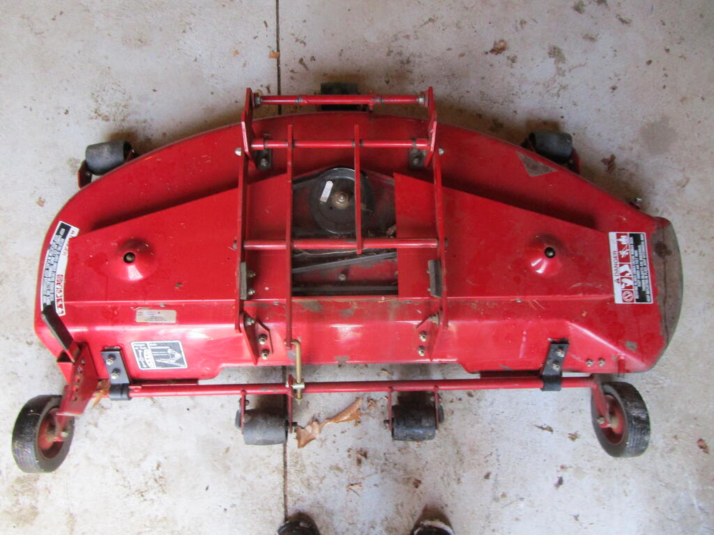

JCM 9,915 #4 Posted November 16, 2021 This 48'' SD deck is one that came on my 91 520-H in 2002 when I bought the tractor. I never mow wet grass and when I remove it in the Fall have to clean next to nothing underside. Then wash and wax the topside before dry storage inside for Winter. It is pictured before the wash job. The 36'' RD deck is a 1996 and gets the same treatment. Both are non recycler decks. 2 2 Share this post Link to post Share on other sites

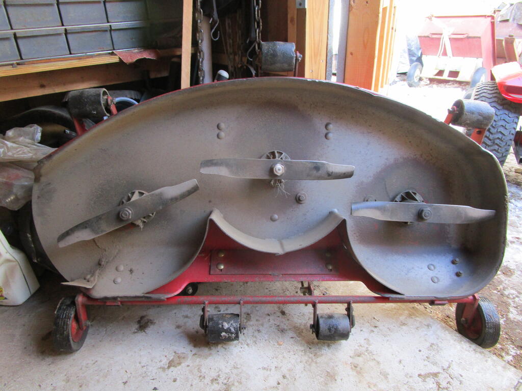

peter lena 8,968 #5 Posted November 16, 2021 @scWHhauler this what i do , been doing it for years , notice anything else ? your baffling is an obvious issue to me , none of my decks have them , used a cutting wheel , to neatly finish off the under side of my R/D decks , terrifying to many , but my decks cut clean and zero build up , sharpen blades with a small fine file , this is not intended to rile people up , but it has and it is working for me . if nothing else , in your case drop the deck and scrape out that stiff grass , oil soak it down and hot sun dry it out . reverse , what you have been doing , break that cutting cycle , pete Share this post Link to post Share on other sites

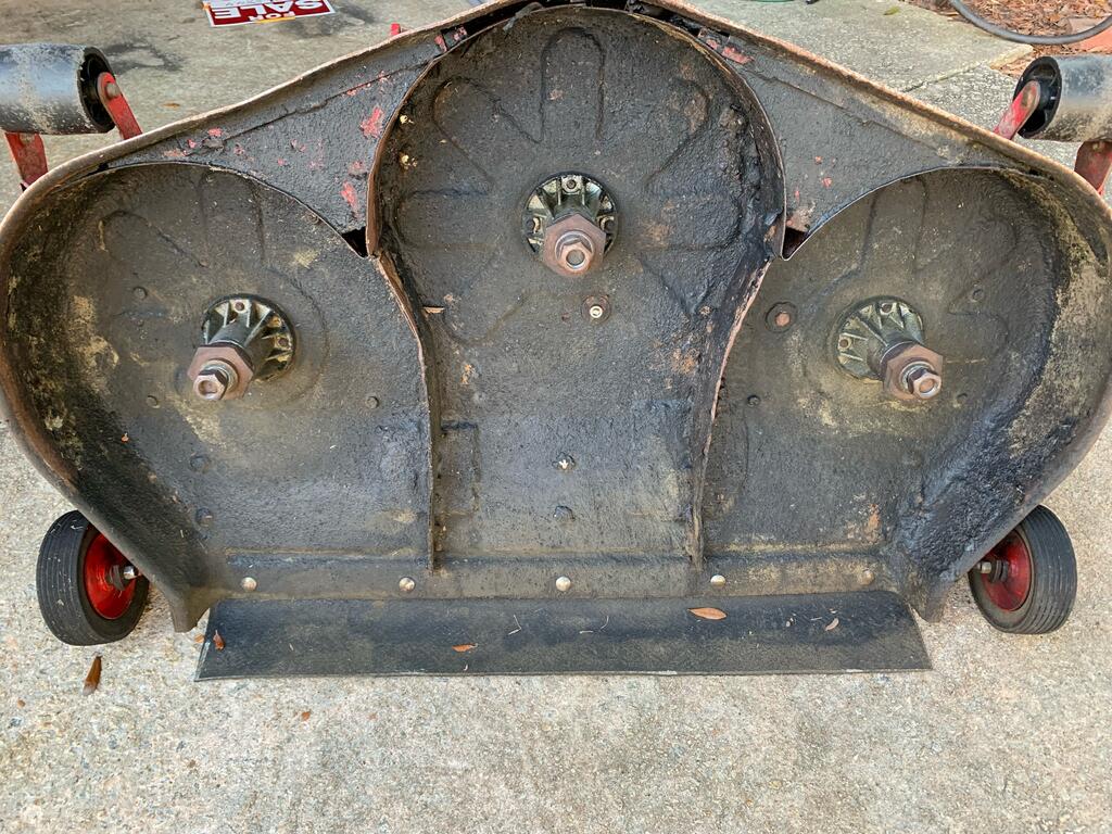

scWHhauler 96 #8 Posted November 17, 2021 hay thanks for the posts hear it is all cleaned peter i think i will remove all the baffling an go from their again thanks Share this post Link to post Share on other sites
Handy Don 13,054 #9 Posted November 18, 2021 3 hours ago, scWHhauler said: hay thanks for the posts hear it is all cleaned peter i think i will remove all the baffling an go from their again thanks With it cleaned, I just noticed the rear owner-added baffle. I suspect it's folded downward because the deck is up on the gage wheels but with the high moisture content of your grass, that extra slowdown may be a factor in not having the underside sweep itself clean. I put one on our 42" deck, but I made sure it extended backward and not down so the grass shoots out backward but doesn't go upward into the machinery. Share this post Link to post Share on other sites
scWHhauler 96 #10 Posted November 18, 2021 Its not a baffle a piece of of inter tube that reduces the grass wet or dry from spreading all over the rear tractor, trans, trailer hitch keeps it clean . Share this post Link to post Share on other sites
Handy Don 13,054 #11 Posted November 18, 2021 5 hours ago, scWHhauler said: Its not a baffle a piece of of inter tube that reduces the grass wet or dry from spreading all over the rear tractor, trans, trailer hitch keeps it clean . Exactly, but also it slows down the exit of the cut grass. No free lunch. Share this post Link to post Share on other sites
peter lena 8,968 #12 Posted November 18, 2021 @scWHhauler this what i do , been doing it for years , notice anything else ? your baffling is an obvious issue to me , none of my decks have them , used a cutting wheel , to neatly finish off the under side of my R/D decks , terrifying to many , but my decks cut clean and zero build up , sharpen blades with a small fine file , this is not intended to rile people up , but it has and it is working for me . if nothing else , in your case drop the deck and scrape out that stiff grass , oil soak it down and hot sun dry it out . reverse , what you have been doing , break that cutting cycle , pete Share this post Link to post Share on other sites
peter lena 8,968 #13 Posted November 18, 2021 @scWHhauler my experience with removal of under deck baffling / ducting , was easy and simple . terrifying to many , it made a much better row free discharge , combined with a regular oil spray down and drying , when i drop my 3 decks for a look see , there is no build up , no trapped grass , and no places to hide rot , dropped a deck yesterday , for winter , no grass hiding spots . lightly touched up blades ,small file , spray it down with lubriplate chain and cable spray , sit at 45 degree angle to sun , deck gets hot , sucks in oil , sitting up side down now with that oil soak, over winter. use lucas xtra heavy chassis grease in spindles and slide areas , also detail soak those spindle bases to deck mount points , stopping rot . always cut at highest setting , this set up has given me trouble free and quiet decks , also did the grease detailing on my same bearings in the pto mule drive , very quiet and spins up with ease . any questions ? just ask , pete Share this post Link to post Share on other sites
