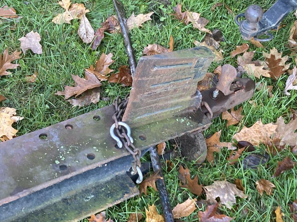

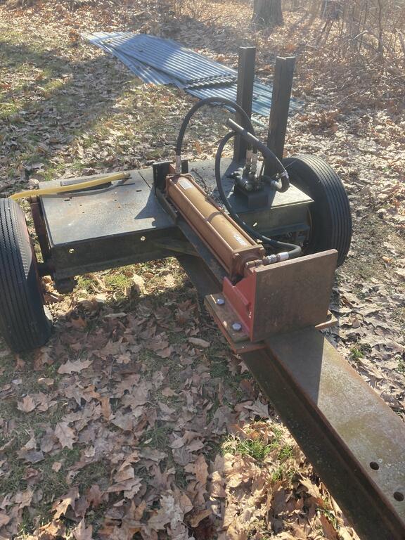

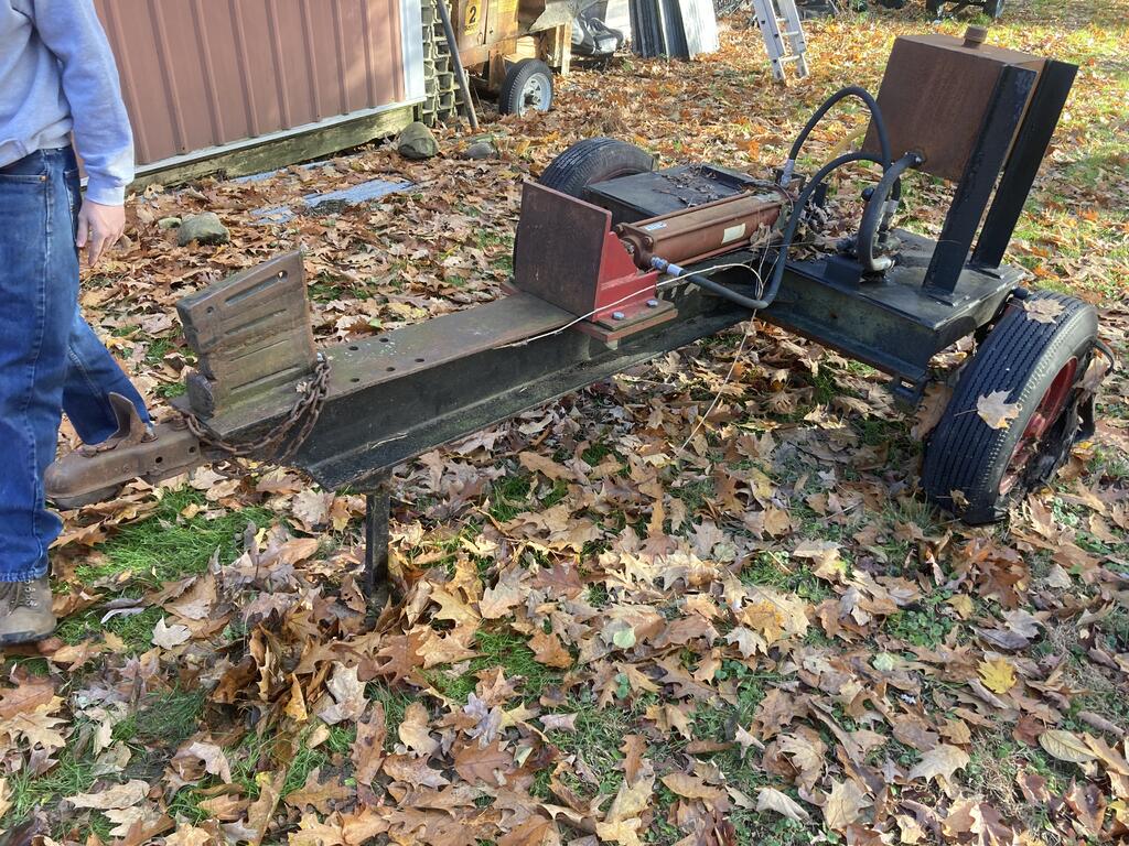

Ifixoldjunk 778 #1 Posted November 16, 2021 I traded some old wheel horse stuff for this massive old homemade splitter. Crazy what people used to make back in the day. Most of it seems good. Needs a new pump and engine. The little control piece has been sitting open for a good 20 years so if I can’t clean that up I’ll need a replacement as well. Other than that though the piston seems fine and that’s what matters. 9 1 Share this post Link to post Share on other sites
Ifixoldjunk 778 #2 Posted November 16, 2021 good use for your old splitting wedges I guess😅 6 1 Share this post Link to post Share on other sites

Pullstart 64,533 #4 Posted November 16, 2021 That thing’s got all kinds of wedgies! Sorry @SylvanLakeWH… we know you’re a visuals guy! 4 Share this post Link to post Share on other sites
SylvanLakeWH 27,529 #5 Posted November 16, 2021 18 minutes ago, Pullstart said: That thing’s got all kinds of wedgies! Sorry @SylvanLakeWH… we know you’re a visuals guy! Now if they were cheese wedges... Cool old splitter!!! 3 Share this post Link to post Share on other sites
Maxwell-8 4,366 #6 Posted November 16, 2021 8 hours ago, Ifixoldjunk said: Crazy what people used to make back in the day. Simple but stronger then anything out on the market today! Like Wheel Horses. My lathe guy, makes these types of log splitters. Maybe he wants to make me one to fit on my WH? 4 Share this post Link to post Share on other sites

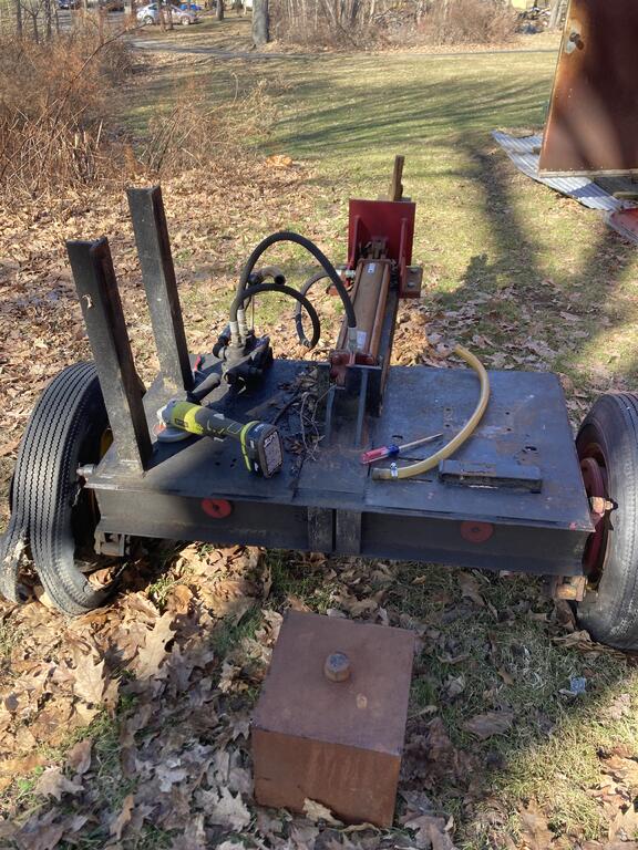

Ifixoldjunk 778 #11 Posted January 2, 2022 So I’ve made some progress on the homemade splitter. I’ve even managed to track down its original creator. It was apparently built in 79, and used all through the 90s. He ended up selling it and it pretty much dropped off the face of the earth until now. I ended up ripping a crappy MTD snowblower apart for the engine and mounted a generic China hydraulic pump to it. Surprisingly everything lined up perfectly. I need to clean the hydraulic tank and control module before I can start making up hoses, but I believe I’ll have a functional splitter soon. 4 Share this post Link to post Share on other sites
Ifixoldjunk 778 #12 Posted January 2, 2022 (edited) Redsquare is making my photos sideways, so y’all are just gonna have to tilt your heads for now. Anyways, snowblowers all lack air filters. Do you think I should modify this engine to have one? It’s gonna be stationary from now on so it’s not like it’s kicking much dust up. The best part of a snowblower engine however is now I’ll have an electric start for my splitter😅 Edited January 2, 2022 by Ifixoldjunk 2 Share this post Link to post Share on other sites
8ntruck 7,383 #13 Posted January 2, 2022 Yup. I think you should add an air filter. Splitting logs is not the cleanest of jobs. 4 Share this post Link to post Share on other sites
ebinmaine 70,736 #14 Posted January 2, 2022 7 hours ago, 8ntruck said: Yup. I think you should add an air filter. Splitting logs is not the cleanest of jobs. I'll second that. 3 Share this post Link to post Share on other sites
WHGuy413 2,771 #15 Posted January 2, 2022 I have to say I’ve seen a lot of home made wood splitters. But I’ve never seen someone use actual wedges to build a wedge. My grandfather built a couple that I grew up splitting wood with. My dad and grandfather teamed up and built one or two more and the one that my dad has now is a custom beast. Seems like most people around here have custom splitters. We have a pair of 4 foot splitters at work. One home made one John Deere. The home made kicks the Deere’s but every day. 2 Share this post Link to post Share on other sites
Ifixoldjunk 778 #16 Posted February 24, 2022 So I know this project has been on the back burner for quite some time due to the frigid weather. But I’m finally getting back to it. So, to start I had to cut the oil tank free. It is filled with some kind of mystery hazardous waste. So I’m gonna let it sit in my shop with some simple green in it for a week or so to break it loose. After that I will have to determine if the tank is still usable. Shouldn’t be to bad seeing that no real pressure is put on the tank. after that point I’ll weld it back to the frame of the splitter and mount the engine/pump setup. I’ll probably have to clean the valve body as well. I’m gonna find some garbage 15’ tires to toss on it so I can actually move it around for the time being. I’ll need it to move to bring it to the local hydraulics shop to have high pressure lines made up. Share this post Link to post Share on other sites
