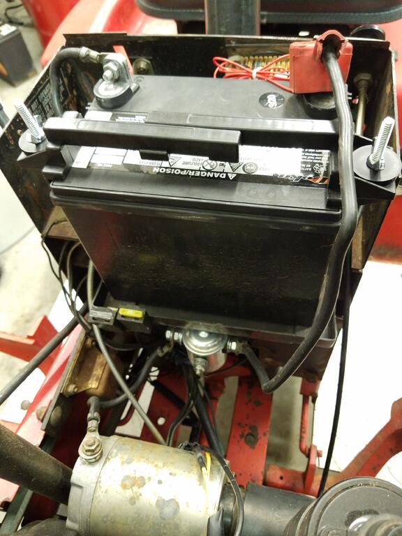

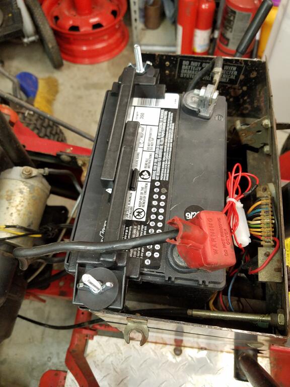

Mustang67ford 234 #16 Posted November 16, 2021 Here is the setup and the parts. All for about $9 from auto store. The rods come with a hook on the bottom which I bent to look like "L". Might have to trim the threaded rod some so does not hit top of hood, didn't try with hood yet. 3 Share this post Link to post Share on other sites
