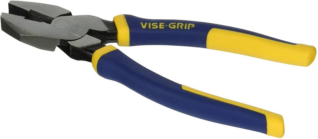

Achto 28,192 #11 Posted November 11, 2021 35 minutes ago, squonk said: I hate futzing with those spring clamps. A good set of linemans pliers works great for spring clamps. 4 1 Share this post Link to post Share on other sites

peter lena 8,971 #19 Posted November 12, 2021 @ebinmaine think it was internet related , automatically went on a clean up , and its gone , went to CUTTING PRO INC , for that hose and matching spring clamps, lineman's plyers are best for those clamps , strong flat / square , give you a secure grab. pete 2 Share this post Link to post Share on other sites
Handy Don 13,085 #20 Posted November 12, 2021 25 minutes ago, peter lena said: @ebinmaine think it was internet related , automatically went on a clean up , and its gone , went to CUTTING PRO INC , for that hose and matching spring clamps, lineman's plyers are best for those clamps , strong flat / square , give you a secure grab. pete I have a set of vise grips with a long snout and wide-ish jaws but if I didn't I'd be grabbing the lineman's pliers for sure. 3 Share this post Link to post Share on other sites
